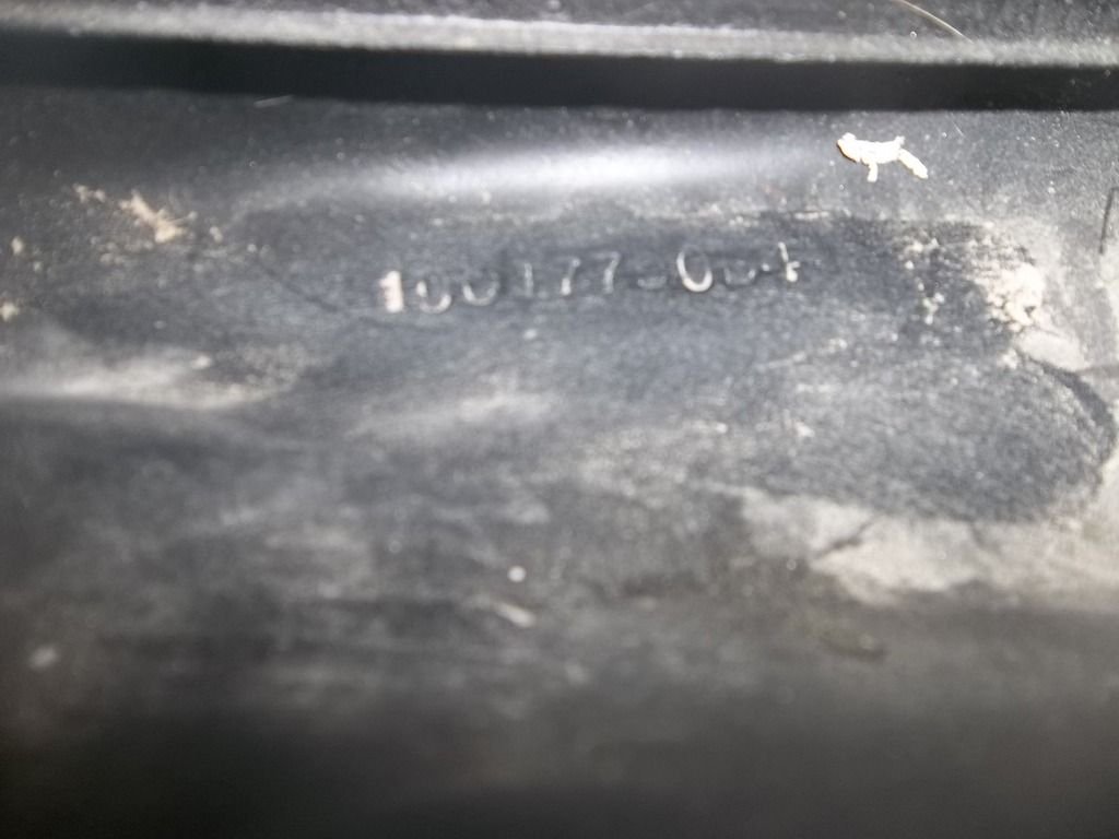

The P/N will be stamped on it on the left side up top.This P/N is from my 86 TA spare Facia
Yep however I suspect that is the part number for just the middle piece and would be the same for all years as the end pieces are spot welded on that middle piece making up the complete assembly and a different part number.

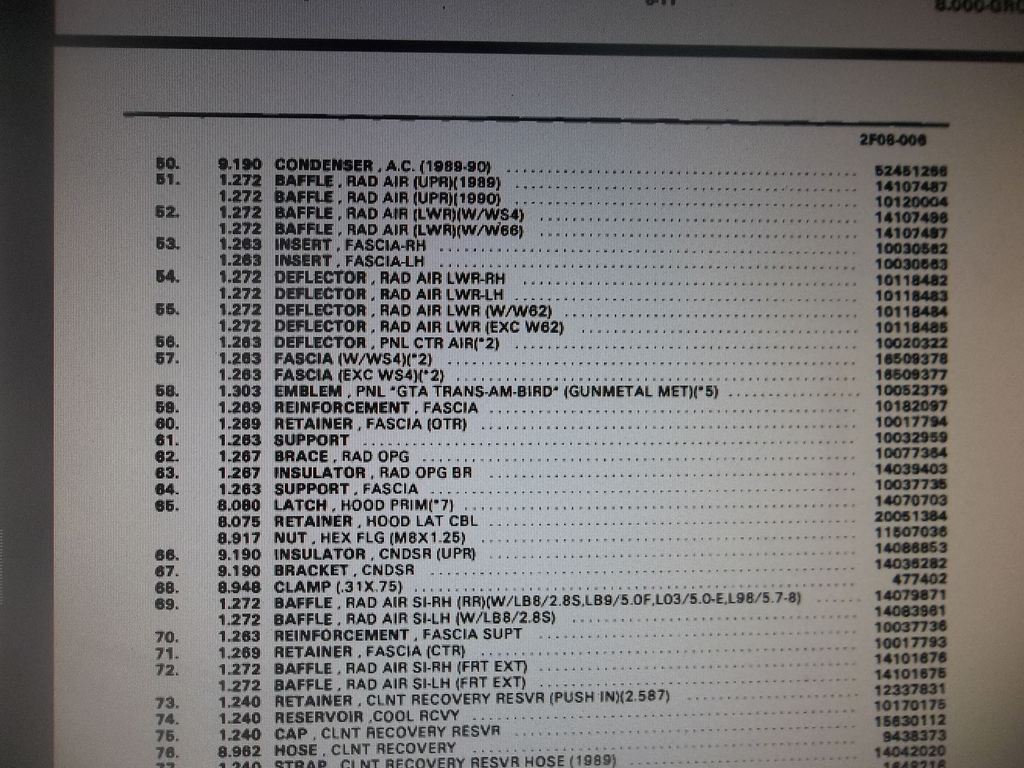

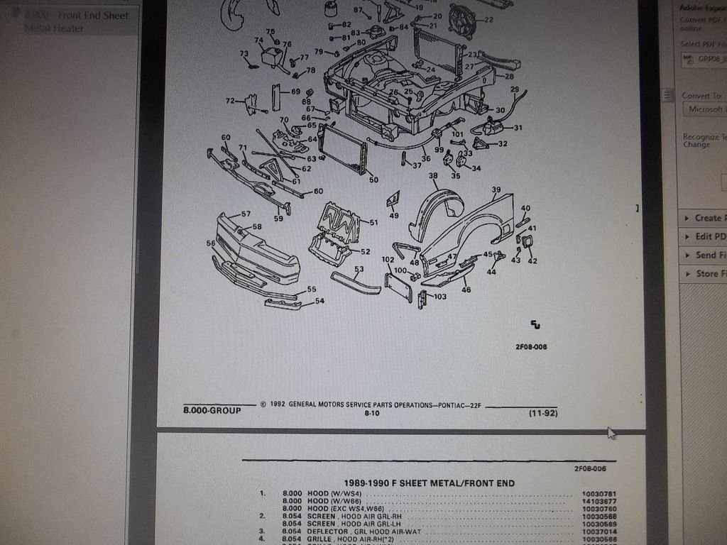

And a few more ...
And the info from the GM Parts and Illustration Guide ...
82-84
Group 1.263 # 10017789
85-90
Group 1.269 # 10182097
91-92
Group 7.831 # 10118418

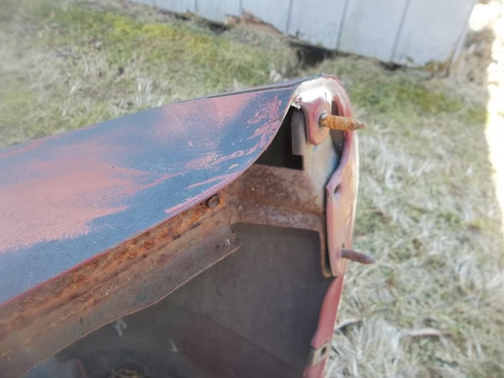

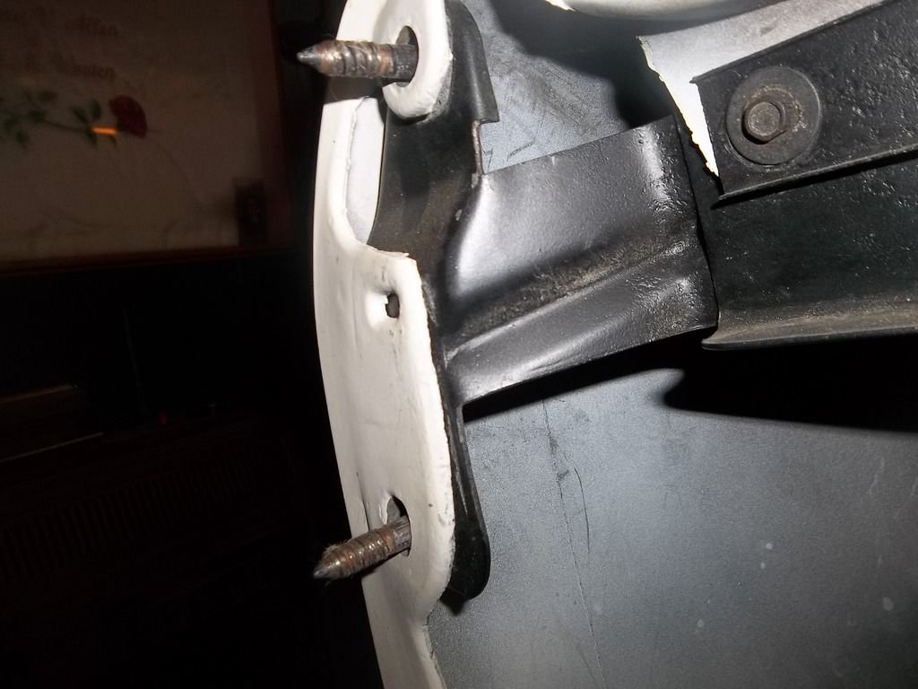

I took some pics of the two I have, the dirty one outside is the same P/N as my ORIGINAL White one inside.They are Identical(reinforcement bar)the dirty one I have no Idea what year it's off.My Parts Catalog says the same as yours,10017789 for the 82-84,but my White one is from my 86 and it's the original one. I think it's a typo,I'm almost positive that those welded ends have no P/N.there part of the bar.EDIT My parts book actually doesn't list this info for 82-84 it was for something else just on top of this info.

The only difference between yours and mine is,yours uses SAE thread nuts and mine uses Speed nuts.There was 2 different reinforcement bars used for 85-87.

I used an '89 bracket on my '84, there seems to be a slight difference where it meets the front fender. It doesn't sit perfectly flush. Nothing really shocking.

SolarGoldRaptor ... this confirms what I suspected hence the difference in the end pieces spotwelded to the large centre piece. Looking at the pictures there's clearly a difference in the "step down" between the upper and lower fender mounting points which means the softw bumper cover have to be slightly different in thickness in those areas as the fenders are identical ...
