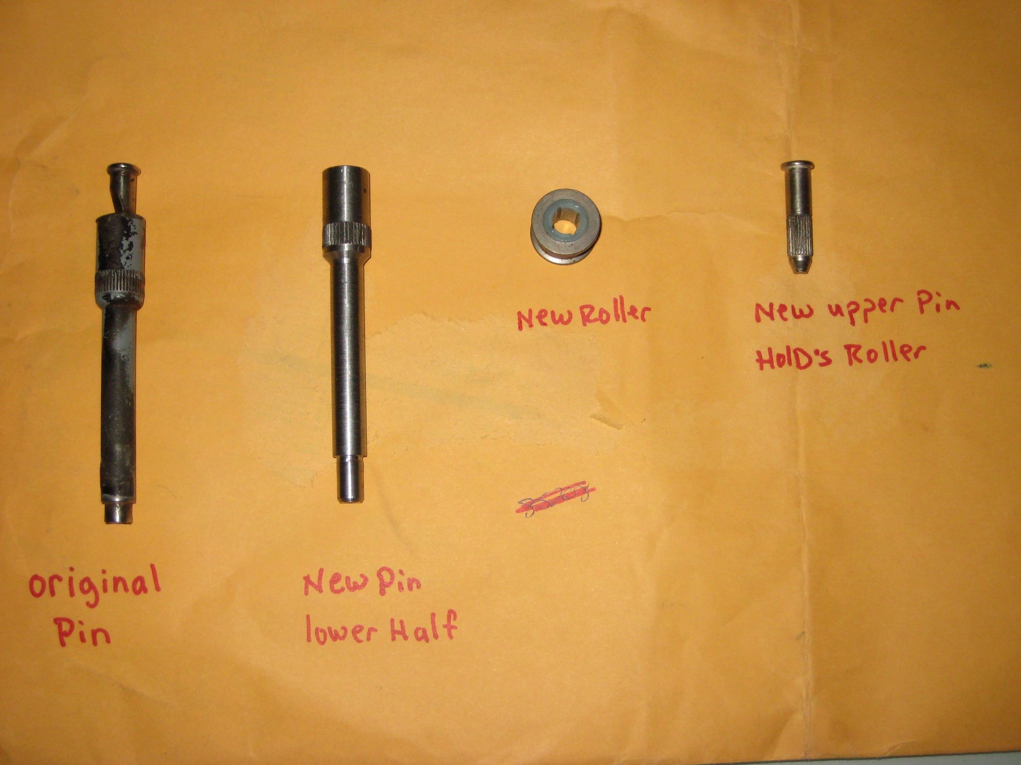

old & new / look at the small end / needs to be turned down for setting the height for the roller wheel / or you can drill the hinge to fit the pin / it cost me $20. to turn down pins {2 pins}
old & all the new parts from chevy dealer
New lower pin has been turned down
this is the way it goes together
lower pin #14030534 / description #W4220DPIN ...
roller #20058035 /description #RU212DROLLER ...
small pin #20262500 /description #RU407D [S]PIN
Here is the new pin installed in the hinge
Then I installed the pin & roller in the new pin
I used my vise to do the pressing
Door roller pin replacement parts.
Get the parts at your CHEVY DEALER.
It comes in 3 parts. Part numbers are.

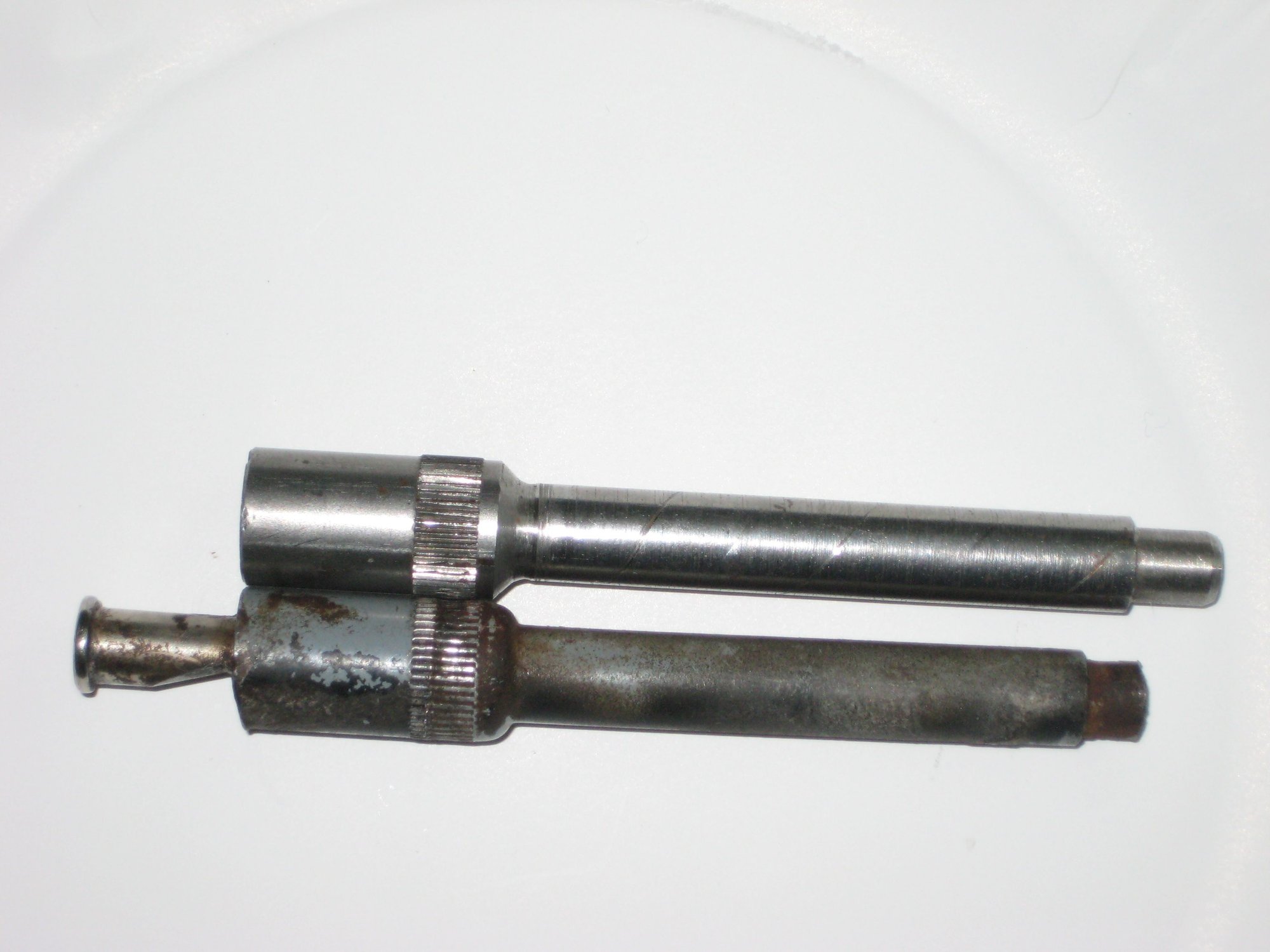

Here are the part numbers for the ROLLER PIN REPLACEMENT. It is a 3 part system all chevy parts.
A photo of the old pin and the new one the way you will buy it from chevy.
you will need to turn down the small end of the pin or drill the hinge to fit the pin. I had the pin turned down $20. for 2 pins

So as I see it, to repair one door I'll need:
Dorman 38401 (1st picture)
GM PNs: (2nd picture)
Thanks to the OP for the loan of his thread.

That is correct all the parts in the photo will fix ONE DOOR.

Just wanted to post pics of the finished setup!
Here are the new pins and rollers and fully rebuilt hinges installed on the door.
Here are the hinges after pressing in the new roller pins. You can see how far they stick out at the bottom, but shouldn't be a problem as there is nothing there to interfere with. Hopefully the 2 tack welds will keep the pin from moving up or down. It was kinda annoying getting the height of the pin the same as the OEM pin was but Hopefully it worked out good.
Other door

Im alittle worried about that as well, the pin has .025" clearance but I can **** the roller by hand on the pin after I pressed it in. Seems like the pin and bushing have clearance thats causes this?
Yeah I just checked mine. It seems the roller pin has "walked" out of the main pin about .250". I relieved the spring tension and was able to "tap" the small pin back into the larger pin. It shouldn't have moved so easily. Anyway, I don't know what the fix is here but it's gonna keep happening if I don't do something. It really ticks me off because the roller is the reason I replaced the whole strap. I spent the money to not have to mess with it. lol. Not funny but whaddya do?
Old Apr 21, 2015 | 11:25 AM

That's no good man, I'd be pulling the lower hinges and replacing the large pin at least. I needed a press to get the small pins in mine... I couldn't even get the small pin in with a hammer.

I turned down the pins by hand… only because Im cheap and I don't know a machinist to do the work in my area.
The pin height was a problem as I had to turn the pins down or enlarge the OEM hinges to accept the new larger DIA pins. I decided to turn the pins down vs enlarging the holes. Mainly bc I liked that there is a step to keep the pin from being pushed down farther. Although prob not a problem as the pin basically only see's side forces.
I put the bushing how I was told by the guy who sold them to me from ebay.
I was not able to find a pin that didn't require to be turned down. I bought genuine GM parts that were supposedly the OEM pin for our cars and I still had to grind the pin down to allow it to go far enough in the hinge so the top roller busing was aligned with the door pivot guide.

I bought those pins and plan to modify them to fit our thirdgen F-bodies. I'll let you all know when I have them done and available for purchase on the Top-Down Solutions Web site.

That would be awesome. Please let us know when you get them ready to sell. I will be your first customer!
