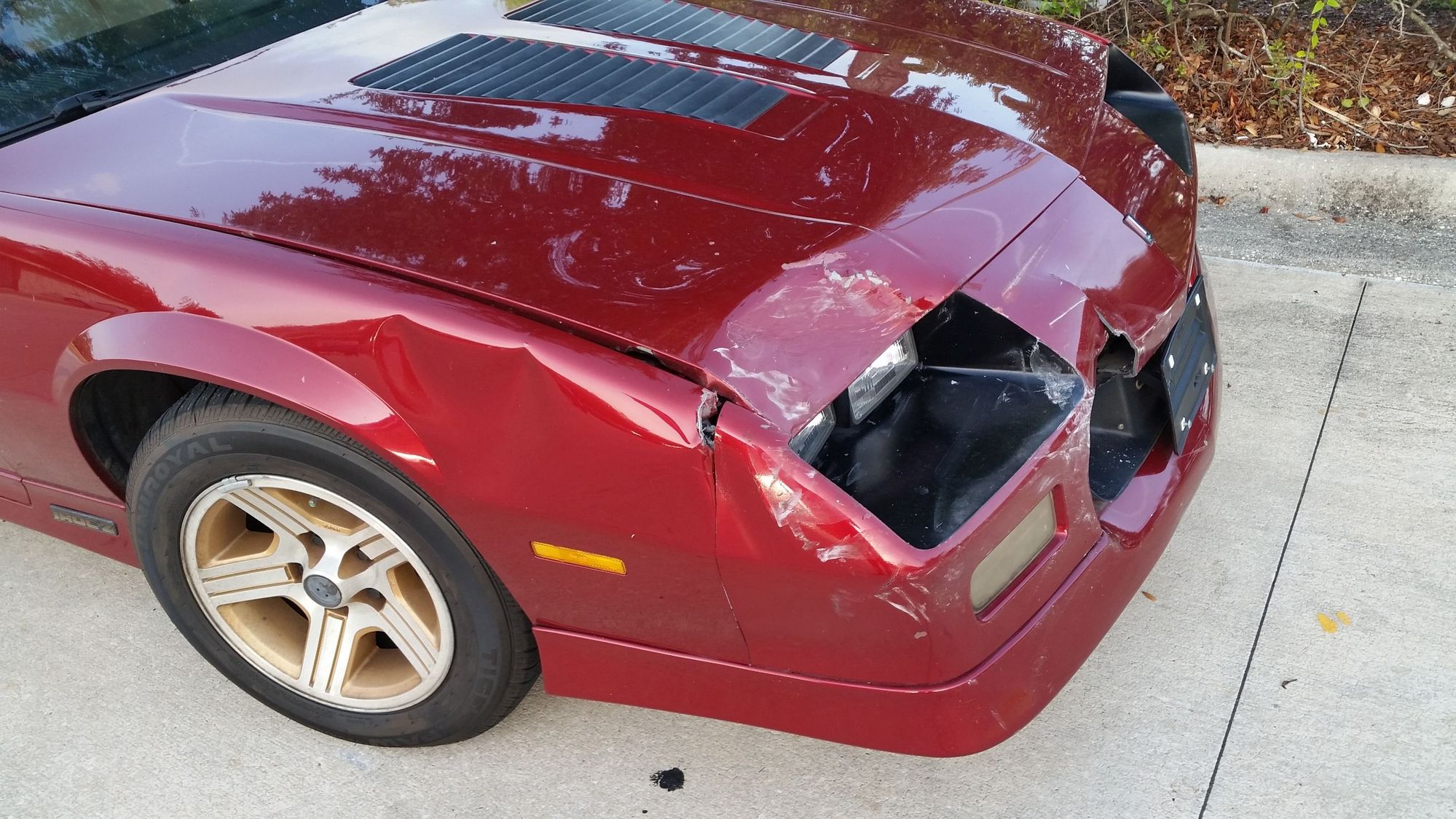

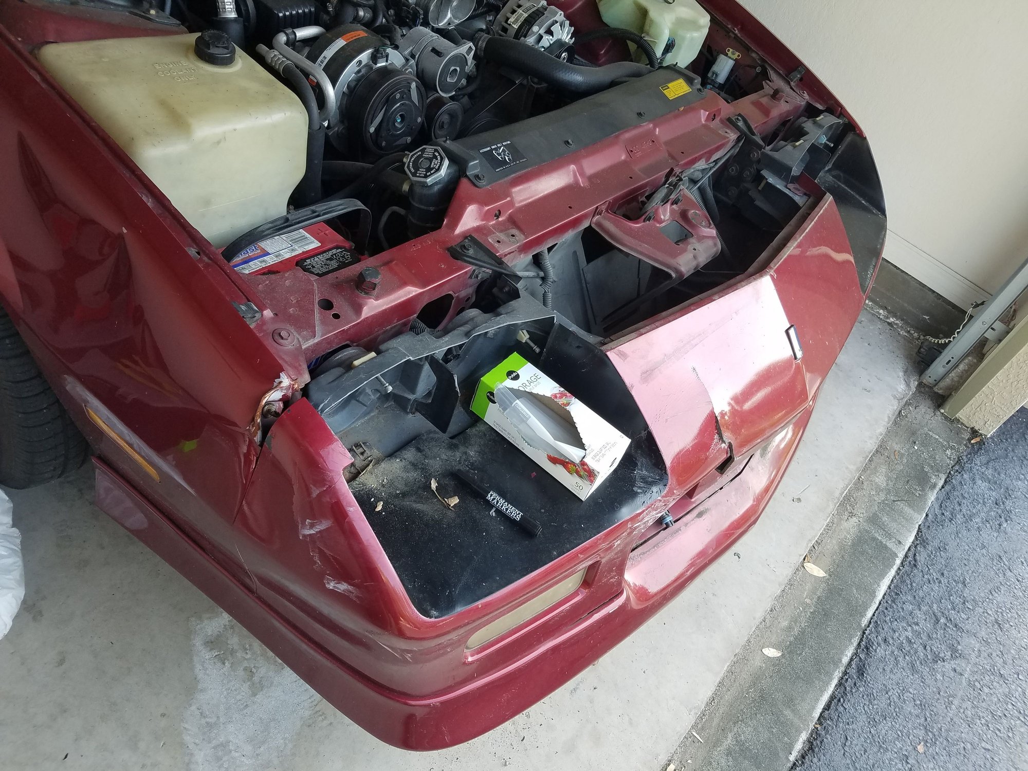

My 1990 Iroc was my DD and I knew at some point the inevitable would happen. Luckily, this wasn't my fault; still, my car got totaled after the claim. It still runs and drives and so I bought it back from the insurance company.
Overall they gave me $7400 and I bought it back for just over four hundred...yes, $400. That's a no brainer, especially when you see the damage: virtually all cosmetic (the hood won't close all the way, so there must be some minor damage to the core support area). I live in the Tampa area, so if you happen to have a car similar to mine, 1990 Iroc with 102K and the 5.7L, you might get more than you expect. It's still a shame that the title is now salvage and I'll have to get a rebuilt, but I never planned on selling it anyway. I'm sure I could sell it now to make some money back if I wanted to.
If anyone wants additional info on how USAA priced out my car, let me know. Or if anyone wants additional info in general.
Does anyone know where to source some of these parts I might need, other than the junkyard?

They totaled it out? Thats a crazy minimal amount of damage front clip wasn't bent.
The fender can be fixed, a PDR could get probably 90% of that out, and only a small amount would need to be fixed with traditional methods. Would save you on having to blend the doors and A-pillar.
The hood is probably screwed, lots of time in getting that straight, certainly more than just getting a fiberglass hood, or JY hood. The clip, yeah no saving that.
All in all, if they valued the car at $7400, I wonder what their break-even point was to fix it. I would have fought for it not to be totaled.

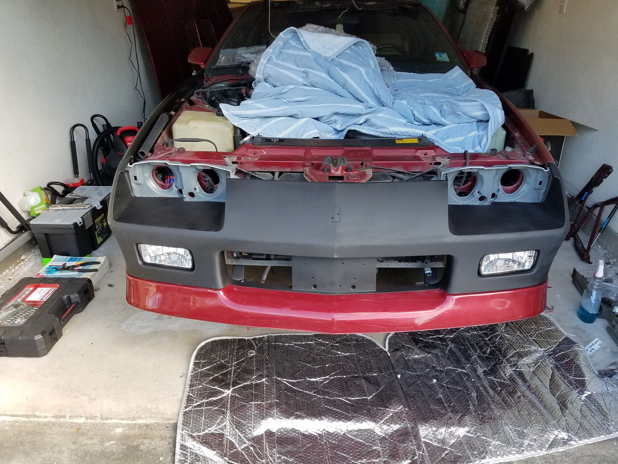

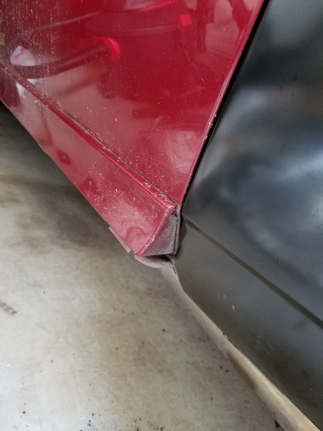

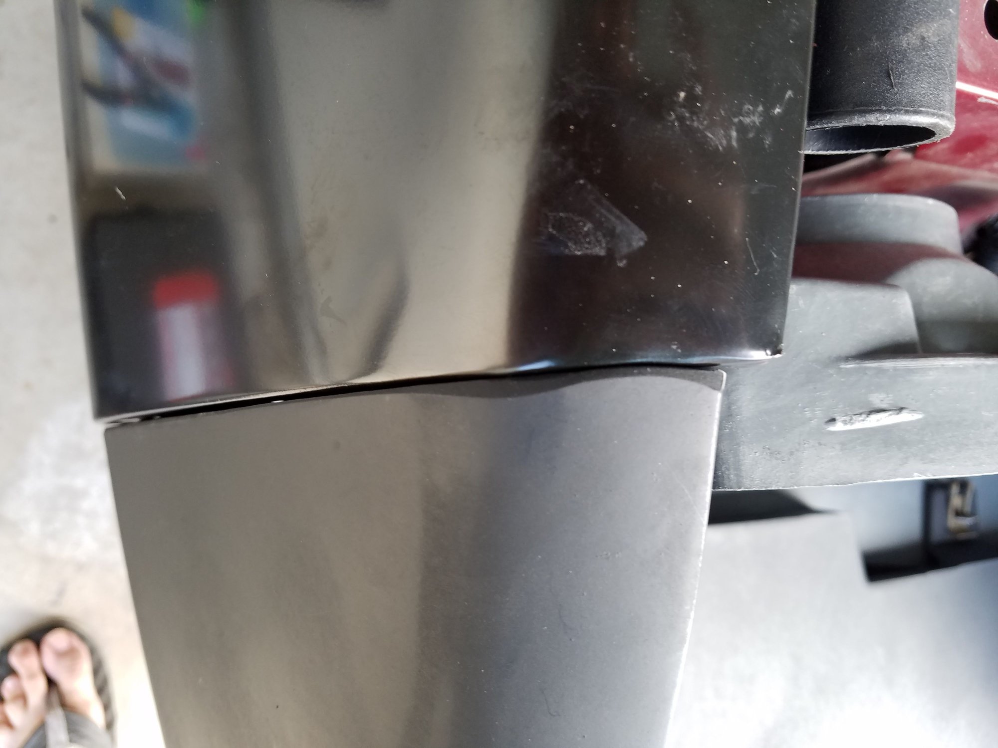

So an update after many months. Bought the hood, fender, and nose new from Classic Industries. I'm sure I'll have some fitment issues, but I'll sort those out on my own. I got started tearing it down as you can see, but the apartment complex garage I'm renting isn't exactly ideal for doing all of this work; progress will be a little slow. Here are some pictures so far. I'll keep you guys up to date on the progress.

I would have bought clean used oem parts before I bought new aftermarket parts. You have to paint them either new or used so why not go for oem parts?

Just from the pics, the upper part of the core support looks pretty good. You might need a new grill insert too with the hit the right fog light took, but it's hard to judge that from the pictures.
Still looks really good for a $400 car.

New OEM parts? I wasn't sure where to source those. If you have any sources, it may be useful for the future. I know that was part of the issue with the body shop I took it to; they couldn't source OEM parts for it anymore.
The title currently says salvage. I had the title as I owned it before the accident. USAA required me to send it to them when I accepted the insurance money. They sent it back after I bought it but with an update that it was totaled. They essentially bought it for a day and I bought it back the next...or something to that effect.
Core support is virtually untouched. There are a couple of bent brackets, but should be easy to source. The fog lamp on that side was already broken, but it had the most obvious sign of an accident. It wasn't recognizable after the accident...
I wish the insurance company had fixed it, but the final price included a bunch of work I just had done to it, i.e. new tires, ball joints, etc. They reimbursed me for part of that, though it didn't play into the overall value of the car. Plus they pay for taxes up to the value of the car, which also factored in to the money they gave me. They only issue that after you buy something else, though. I bought a 2006 Jetta TDI with 75k miles for around 8k, so it worked out in the end. I get almost 3x the mpgs....
I'll post more pics this weekend of any progress I make.

Got the nose off this afternoon. Had a little trouble with the header panel mount screws not staying in the panel itself where they mount to the fender. Fortunately the header panel broke during the impact and I was able to piece it out so I could get a pair of vice grips on the stud and loosen the nut holding the nose and fender to the panel.
I'm debating whether to use the existing brackets and hardware or source them new. I know some place like home depot or lowes will be expensive. Any suggestions?
There is some damage to the subframe where it connects to the bumper on the passenger side. You can barely see it in the pictures. I'm not sure that damage is going to matter, though. The metal bumper also has a little bit of damage, but that looks easier to fix. Any thoughts?
All in all, not a whole lot of damage. It needs to be cleaned up quite a bit, but the majority of the paint work will just be on the exterior in the end it seems.

Got the replacement fender mocked up today. It took a little bit of 'persuasion' to get everything to fit correctly, but it turned out pretty well. I'll know more when I get the front end mocked up as well and I'm sure there will be more to do. When I first put it on the car I didn't think it was going to fit at all. The sloping towards the front wasn't quite as pronounced as it needed to be, but it all worked out in the end. I'll get the replacement nose mocked up in the next few days and post the pictures here. I'm not expected great things, but we'll see.

Got the nose/header panel mocked up. The aftermarket nose fits pretty well...way better than I expected from the horror stories. Check out the pictures below. The only thing that annoys me is the flat edges near the sides of the nose. I get they probably had to shave some of it off after they pulled it from the mold, but it just looks bad. The sides don't really line up well because i haven't bolted anything down. I just have one nut holding the nose on from either side. Check out the pictures below!

Got the nose put back on with the header panel and headlights installed. I painted a few brackets and cleaned up some plastics prior to putting everything together. There are a few things I left off, like the right fog light, some of the underbody guards and plastics, and a couple brackets I just don't need to get the title status changed to rebuilt. The hood fits pretty well, though the center of the nose needs to come out more to line up better with the center of the hood. For now, though, it's good enough for a trip to the DMV!

Aftermarket nose looks great.... When I had mine replaced with a so called "GM" nose.... the flat part under the headlights isn't flat, it's wavy......

That was the most concerning place for me initially. Without the structure of the header panel and the fenders, the headlight area looked wavy. Luckily after bolting it to the header panel, it was forced into shape and holds well. The rubber they make it out of is very firm compared to what I've seen in the past for aftermarket noses. I have a 1980 Firebird Formula and that aftermarket nose is virtually worthless. Each headlight (4 of them) has it's own rectangular surround in the nose and all of them are wavy and droopy. It looks horrible. I'm glad I didn't go through that this time.
