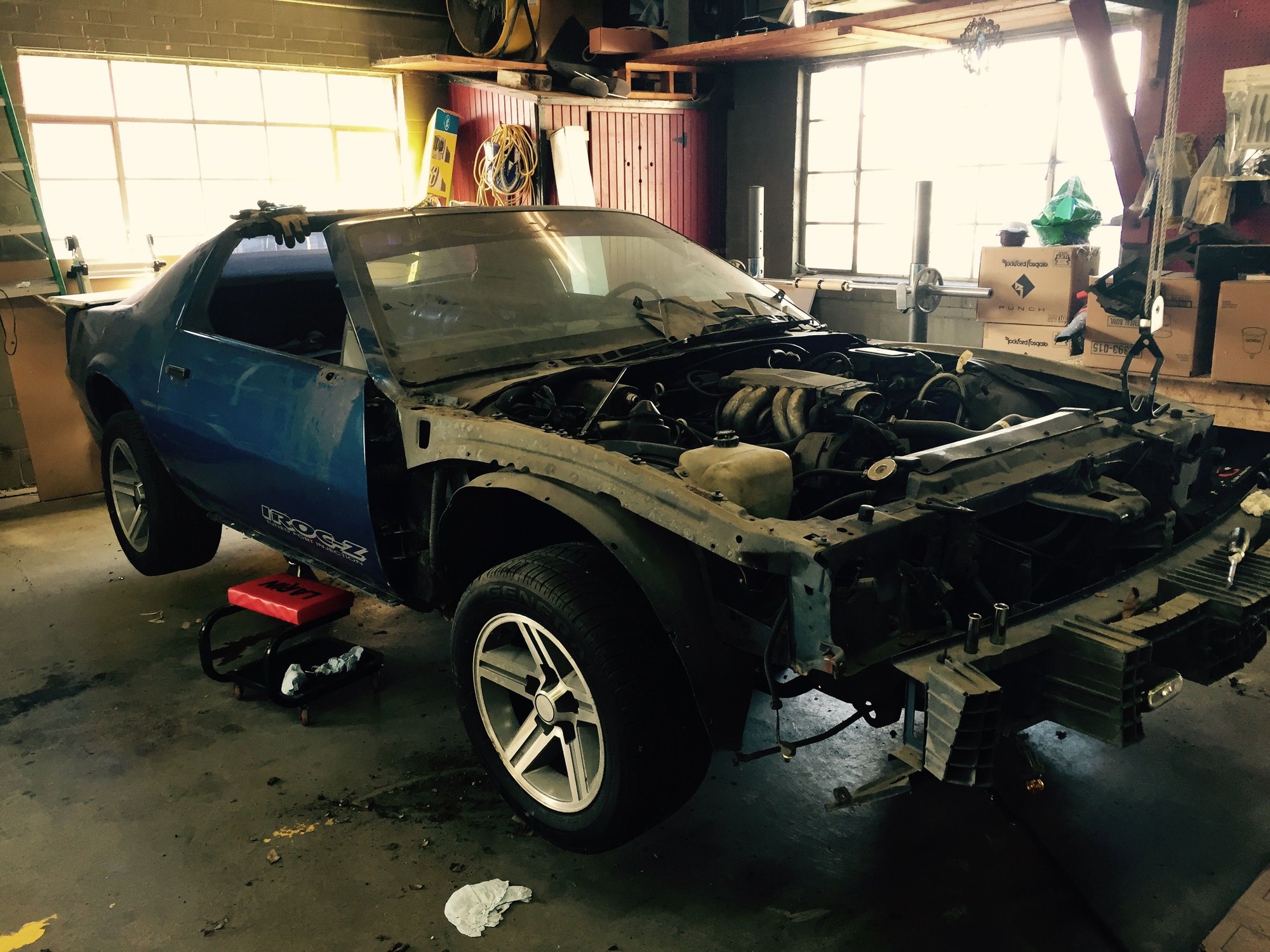

Started taking it apart and repairing rust . It was slow going at first but moving along better now

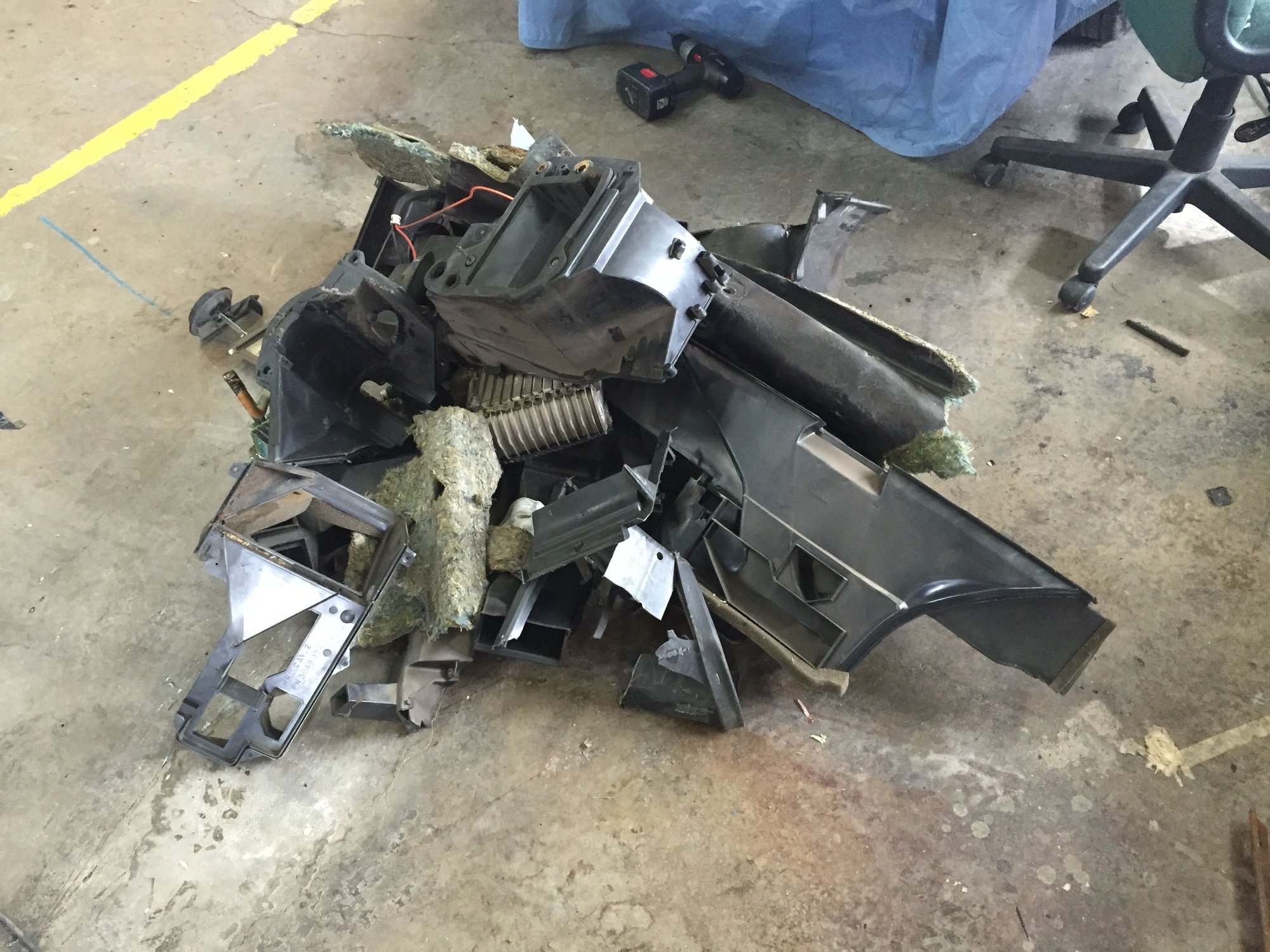

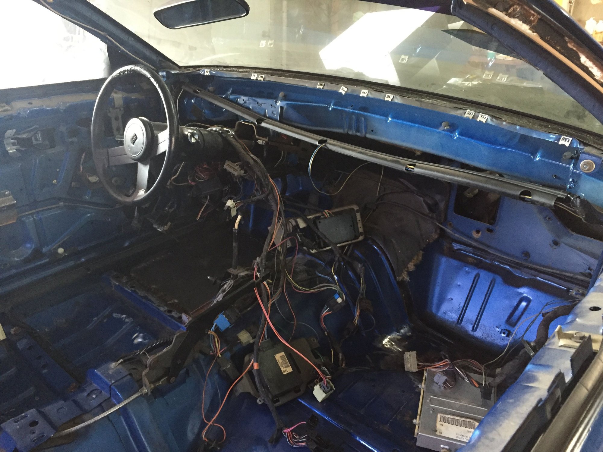

I took the dash out so I can remove all the heat and ac.

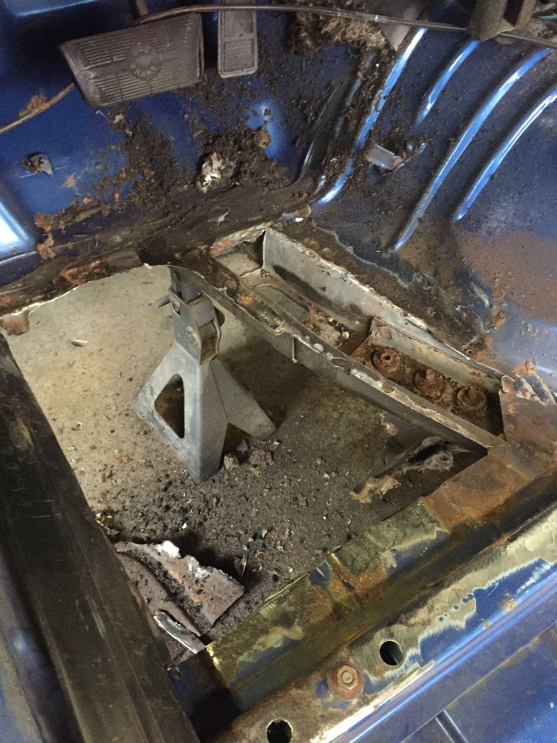

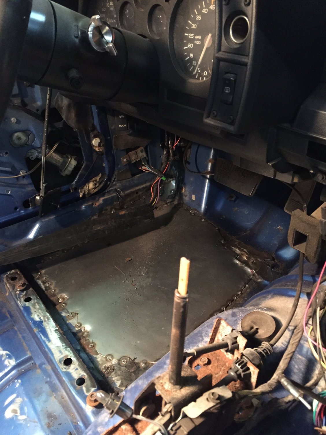

This is a picture of the drivers floor removed I'll post a pic of the patch piece so far. I am sure what I am doing is not perfect. Please feel free to give any advice.

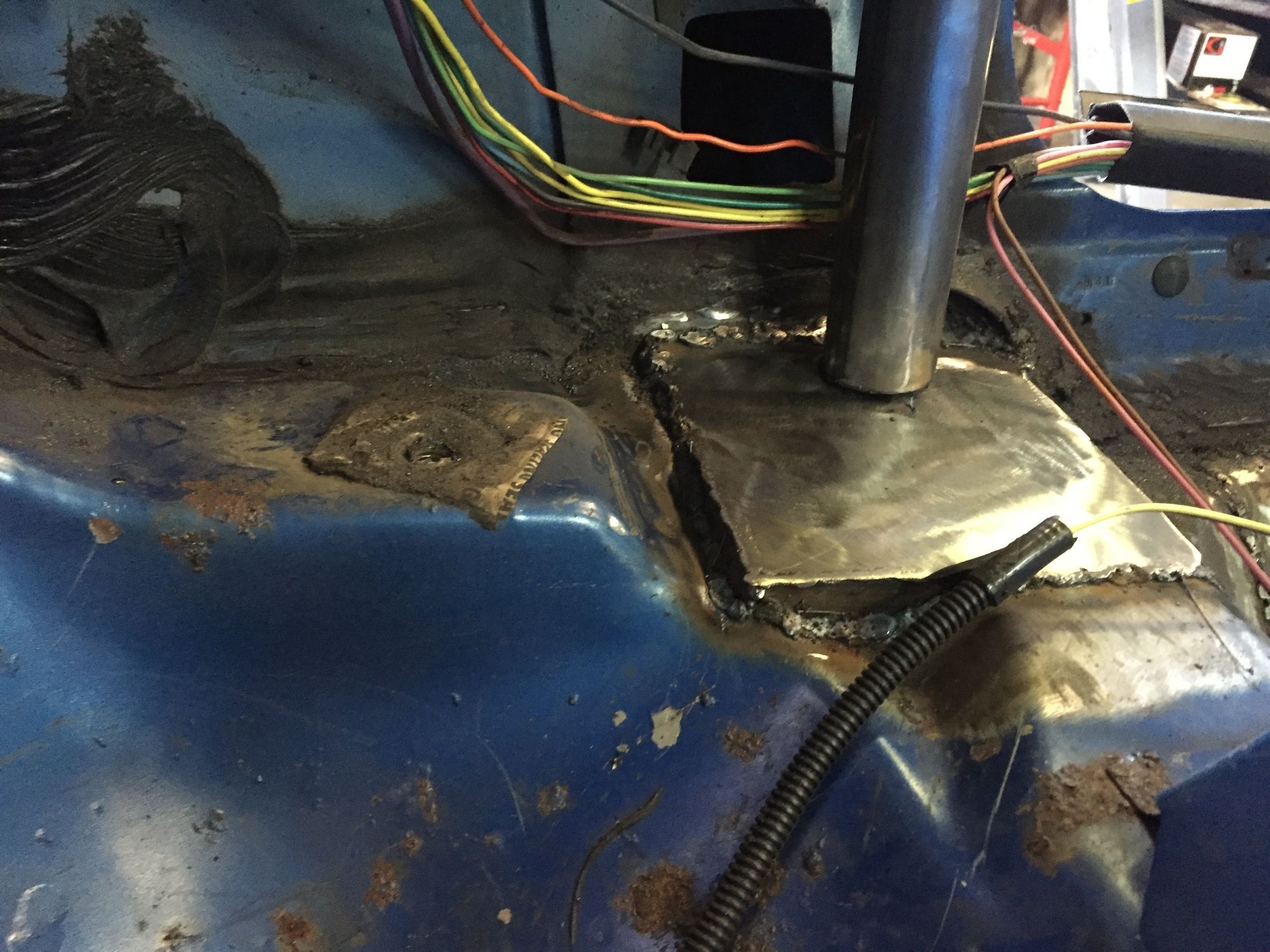

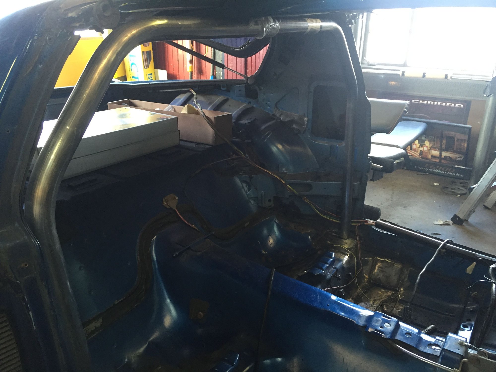

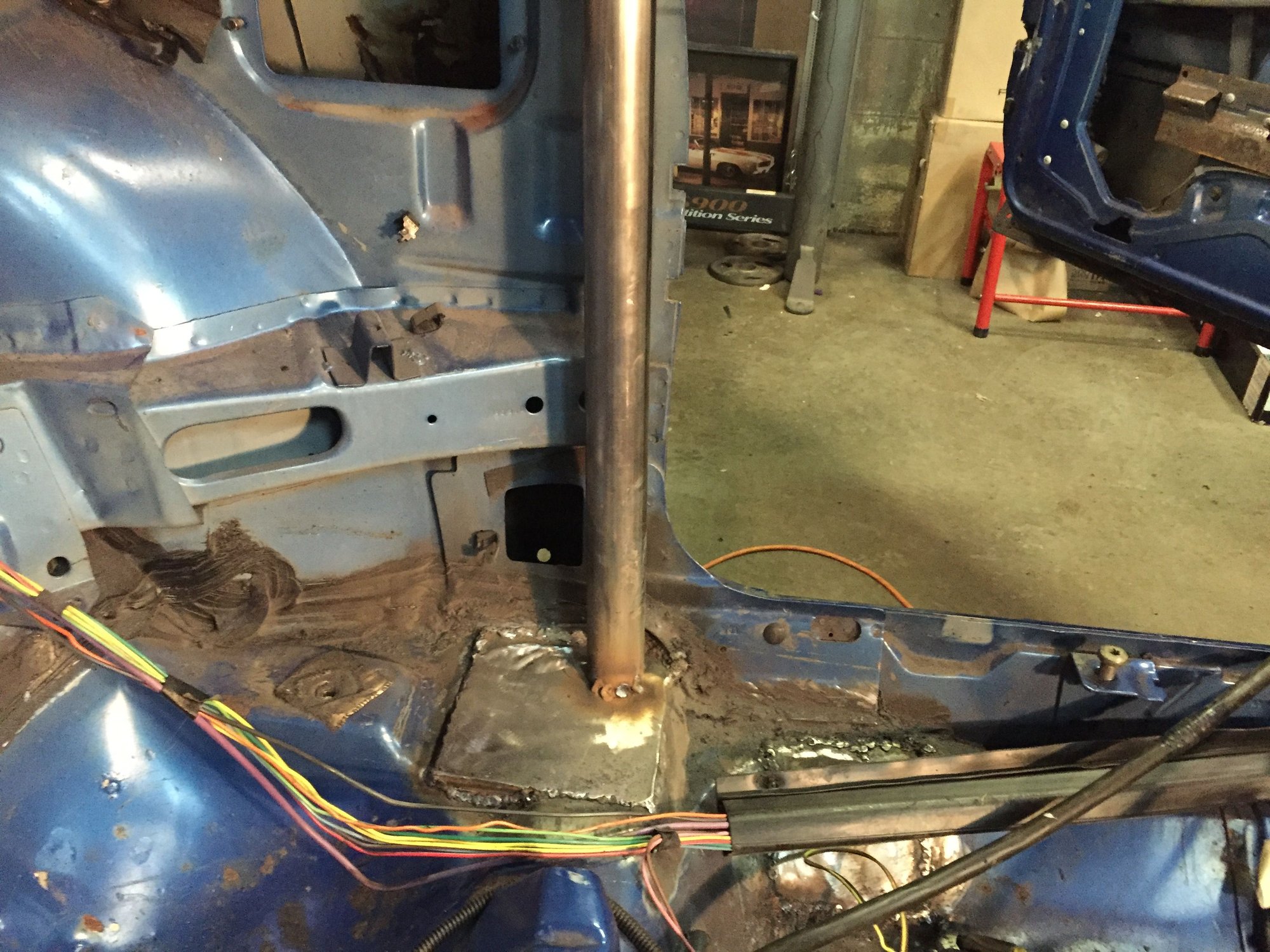

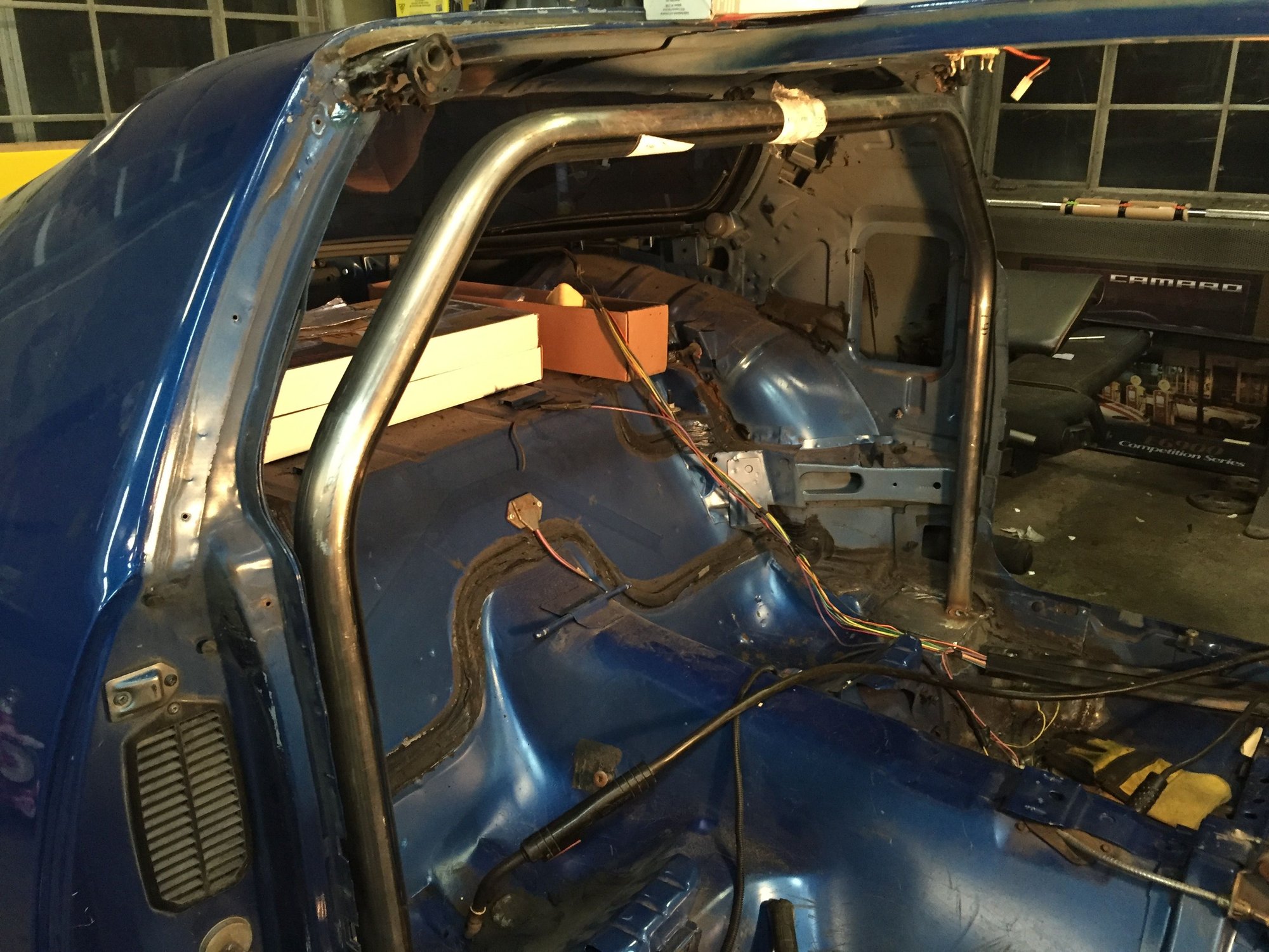

I got two plates welded in for the roll cage this weekend. I would like to have a headliner in the car. How much space should I leave between the roll cage and roof? Don't I also need to leave room for padding around the roll cage?

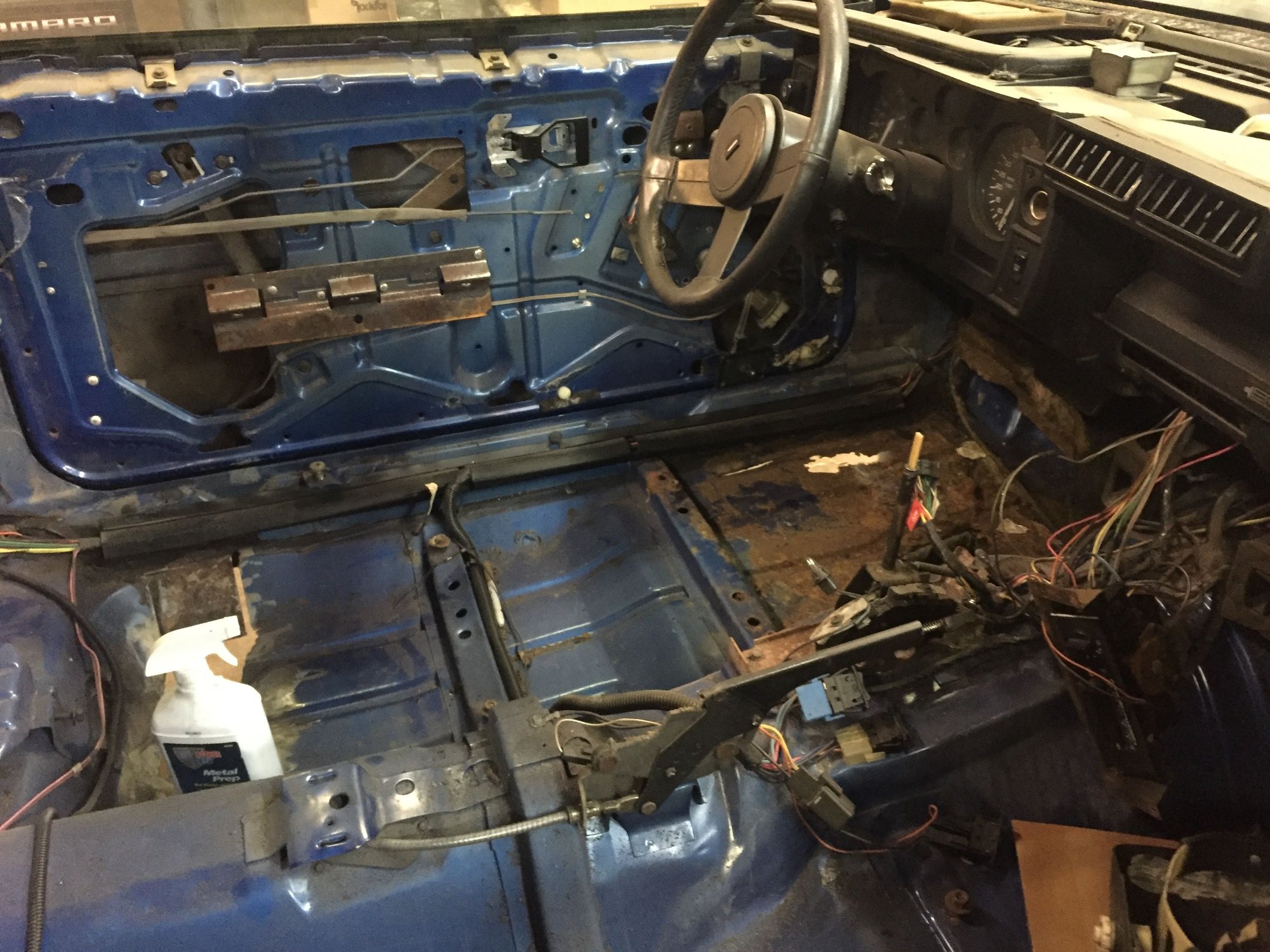

New sheet metal on drivers side floor pan. It's coming along slowly. I'm in no big rush. Thanks again to everyone for all the great information on the forum. I just hope my build can help someone.

When I put my cage in, I spaced the main hoop down from center of roof (t top car) just enough to slide my index finger all the way between top of bar and bottom of roof. My headliner fit back in, but was a tight fit.

Perfect. Thank you.

i got the main hoop tacked in and realized I was out of welding gas. Going to start on the rear bars this weekend.

thanks dbruce. I am missing a piece to my tubing bender so I have started working on other things like the subframe connectors and welding more spots on the floor. I have to admit I am getting frustrated with this. I'm starting to realize the car is a rusty piece of crap. I cutout a different pieces of the floor and make patch panels only to find out I didn't cut out enough and you can't weld to rust metal it just blows apart. So now I'm just chasing holes all over.
