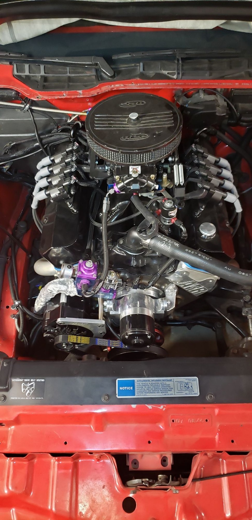

Update!
Engine is in the car.
I'm using a Edelbrock 2970 intake. It's 6.36" tall and a 1" spacer.
I have 3" worth of room between my dominator carb and the hood.
So I'm going to use a 2.4" tall air filter so I can drive it on the street.
