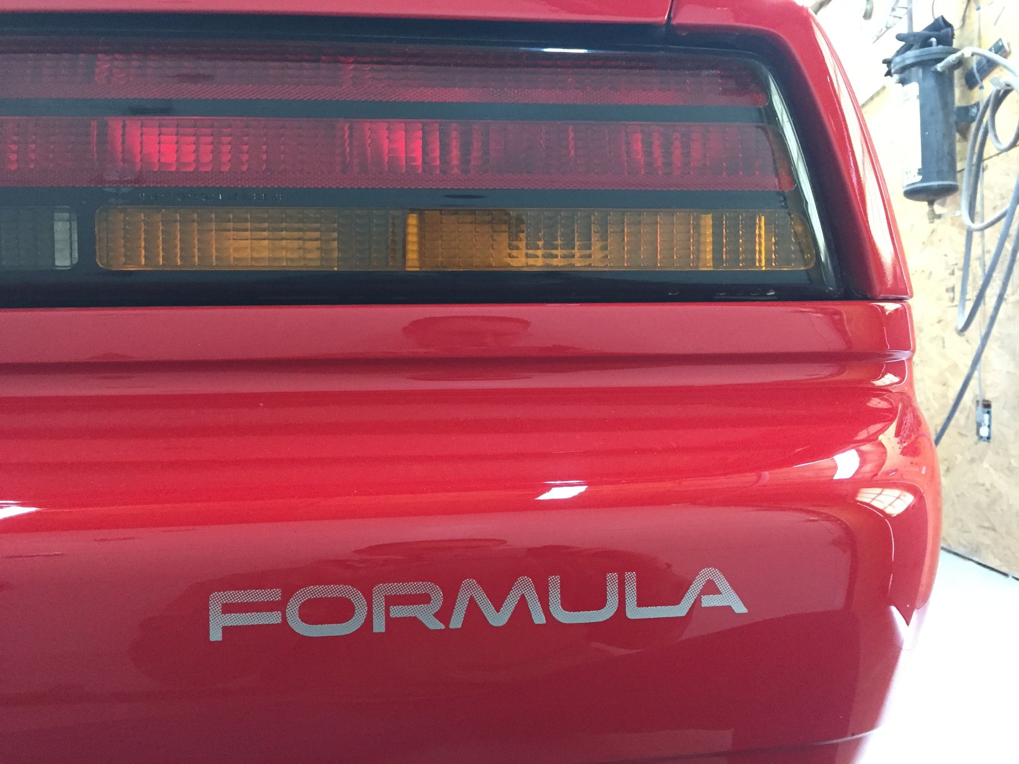

Rear bumper, the middle of the A is in line with the right hatch/quarter and its 2 1/2 inches up to decal bottom from the body line below it.
The b-pillar birds, door decals and rear decal are not all placed the same from the factory. So use these measurements as a general guideline.

Thanks again for your help!!

I used these same measurements on my 91 - spot on!

Looking good guys!!!
