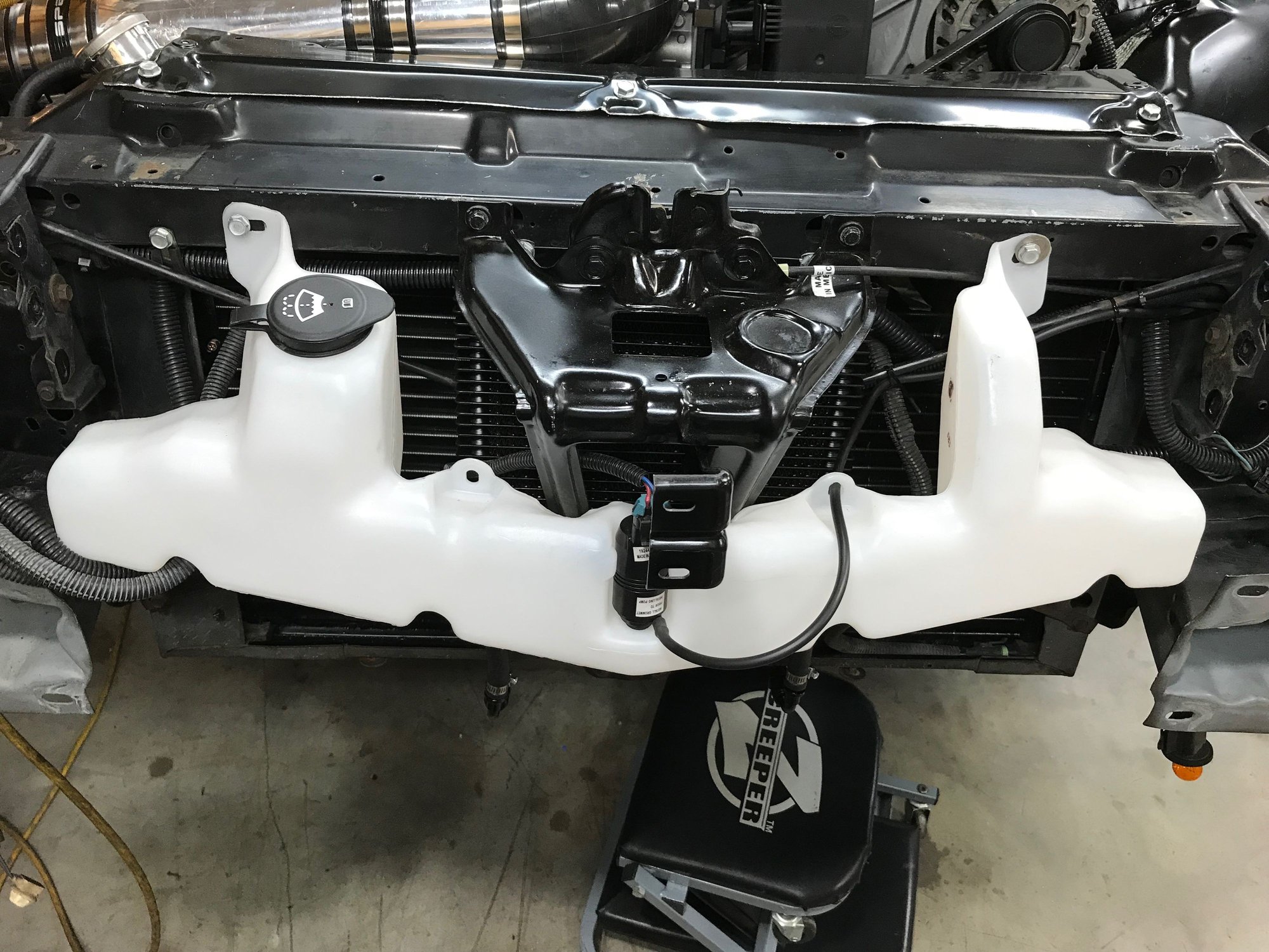

Re: 4th gen windshield washer reservoir
Ok, well this is my washer reservoir.You can just see the pump & the tip of the hose.
Where pump harness connects, routed on frame rail.Hose is routed inside fender, into cowl, exits at center w/ single nozzle .

Here are a few photos of my install. Just removed both washer reservoir and coolant reservoir and mounted both new reservoirs in the nose. But instead of using the pump located on the 4th gen tank i used the original pump mounted in the car and just ran the hose using a rubber seal to hold the hose in the tank nice and snug, so far it works great!
here is the washer reservoir with the 4th gen pump removed and hose ran inside.
Here are both reservoirs mounted in the nose
both reservoirs again

I mounted the 4th gen reservoir too in the same location. When I got the swap completed and got it running. I did extended idling and road tests to see if there were any cooling issues. I have a big radiator too and I no issues with cooling, even with AC on.
