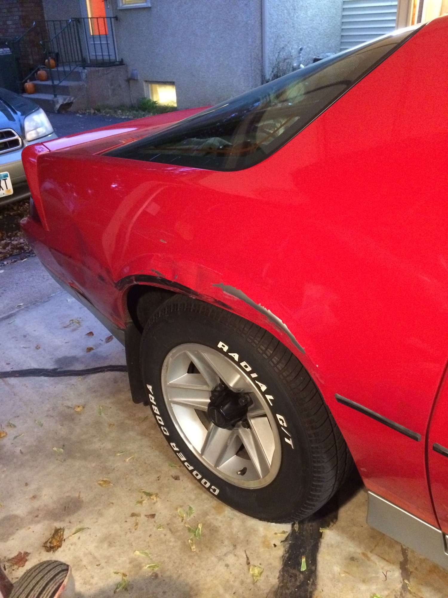

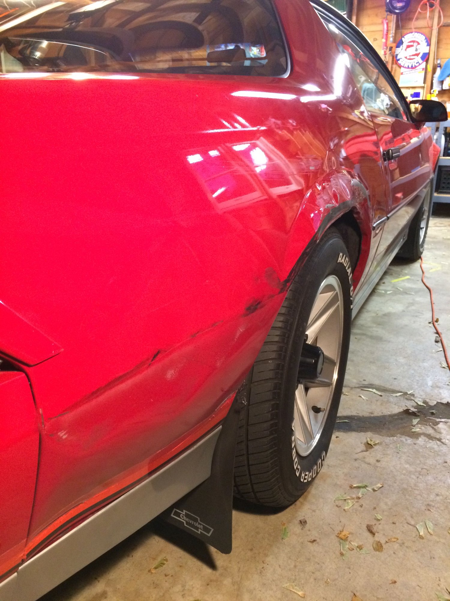

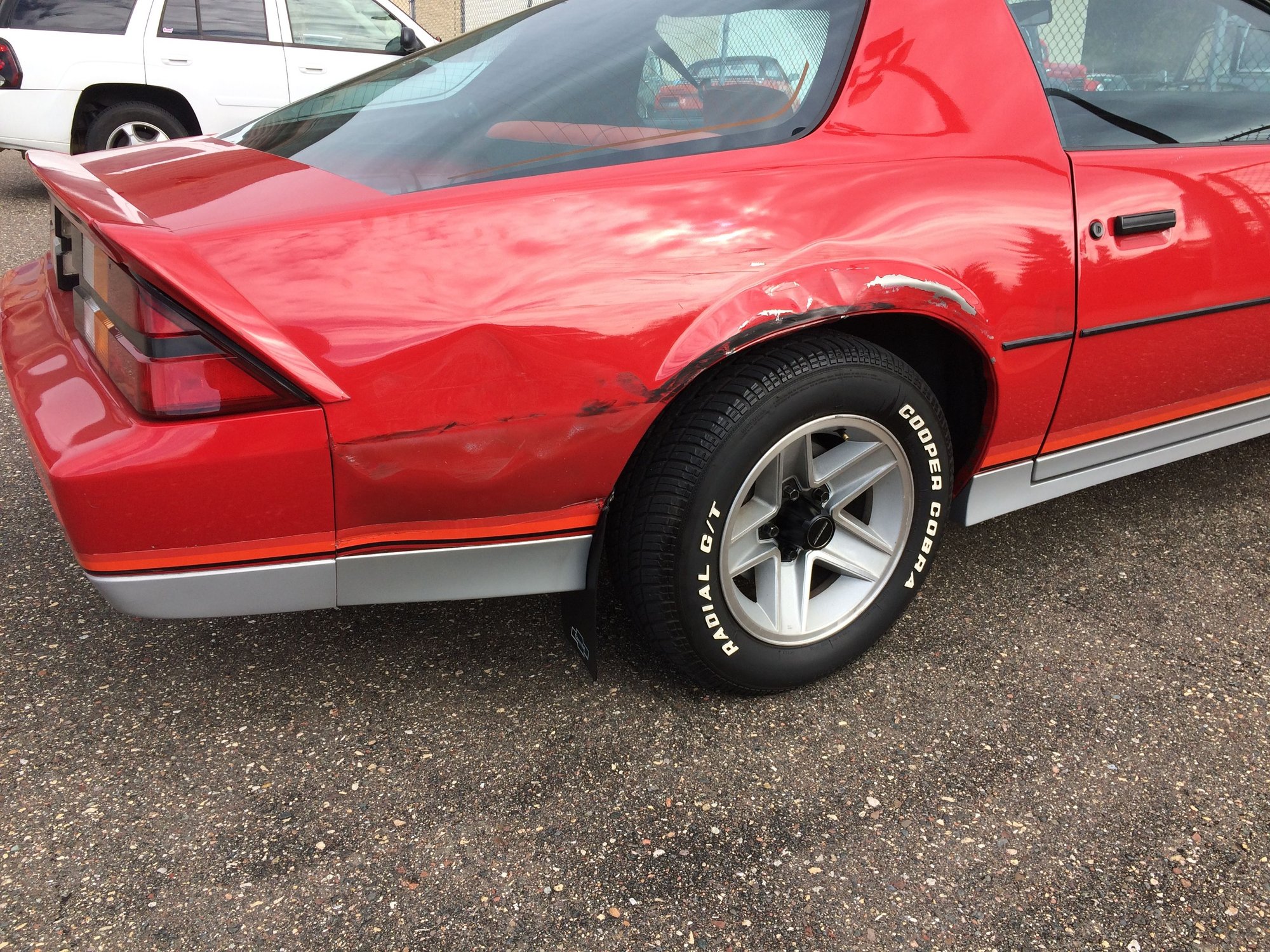

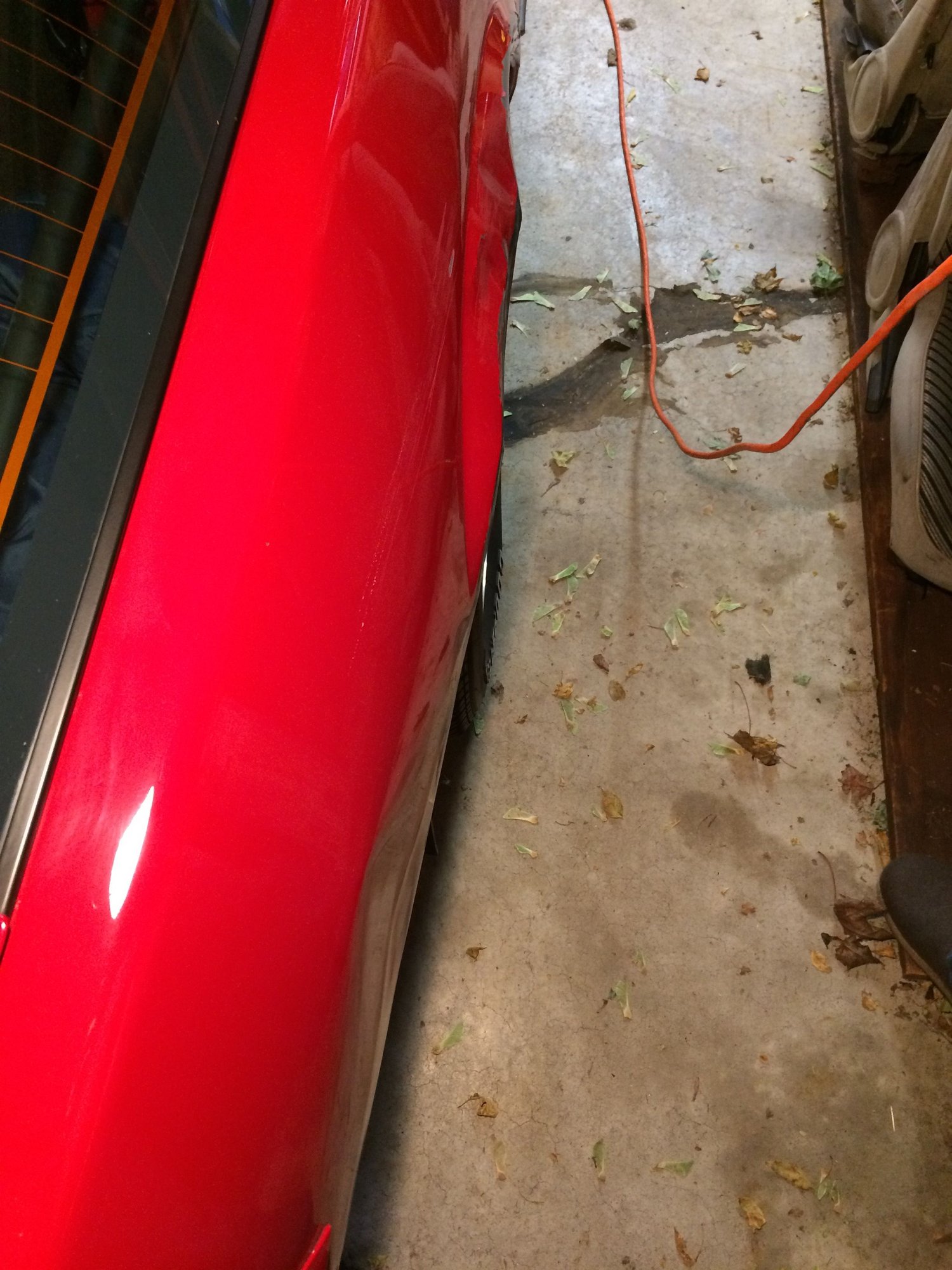

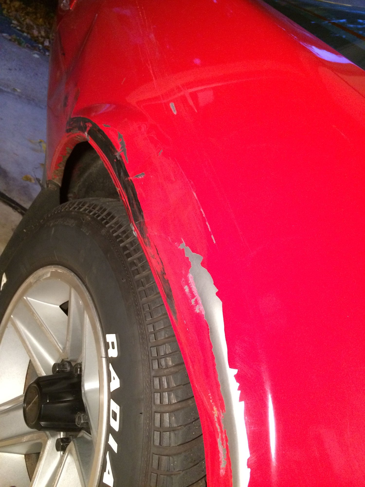

Way too nice a car not to fix. Still has single stage water based enamel. Some panels are original paint, some were repainted years ago. Van Nuys build. Car was presentable as was, but a 10 footer with what I consider nice patina of blemishes all around. Even the original stripes were good enough despite very much showing their age.
I had to beat it out with a mall over the wheel to get it home, so was actually pushed in more than photos show. The Lamborghini photo was pre-damage by about 48 hours.
Suggestions please.

I think that can be repaired with some body work to the panel. I would rather fix it then start replacing panels. A good body man will get that straight again.

Yeah, find someone that can work the metal and not just use filler. It can be done.

Its not that bad.98% of that can be push out from the back.No slide hammer.

Whoever you take it too, try to find work that they have done on none-daily driven cars. Lots of shops just want to replace panels and shoot paint and to be honest what beginner can't do that? I'd find out what filler they use because it's almost a sure thing that unless its a custom body shop they will be using some amount of filler. If it's a show car and you can't research their work I would see if you can find a coating thickness tester to ensure they just didn't use filler over everything.

that dent is easily accessible from inside the car, definitely worth fixing

I had an outie dent in a qtr. panel of a GM 80s car. I took it out with paint removal, and a big shrinking disc. on a HF grinder. It's work, but it made me a believer.
My point is your damage is repairable. Without bondo. I like the sound of Scott's recommended shop - will do what you need done, or better advise.
