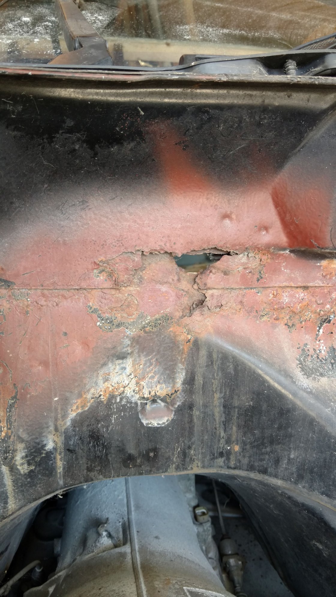

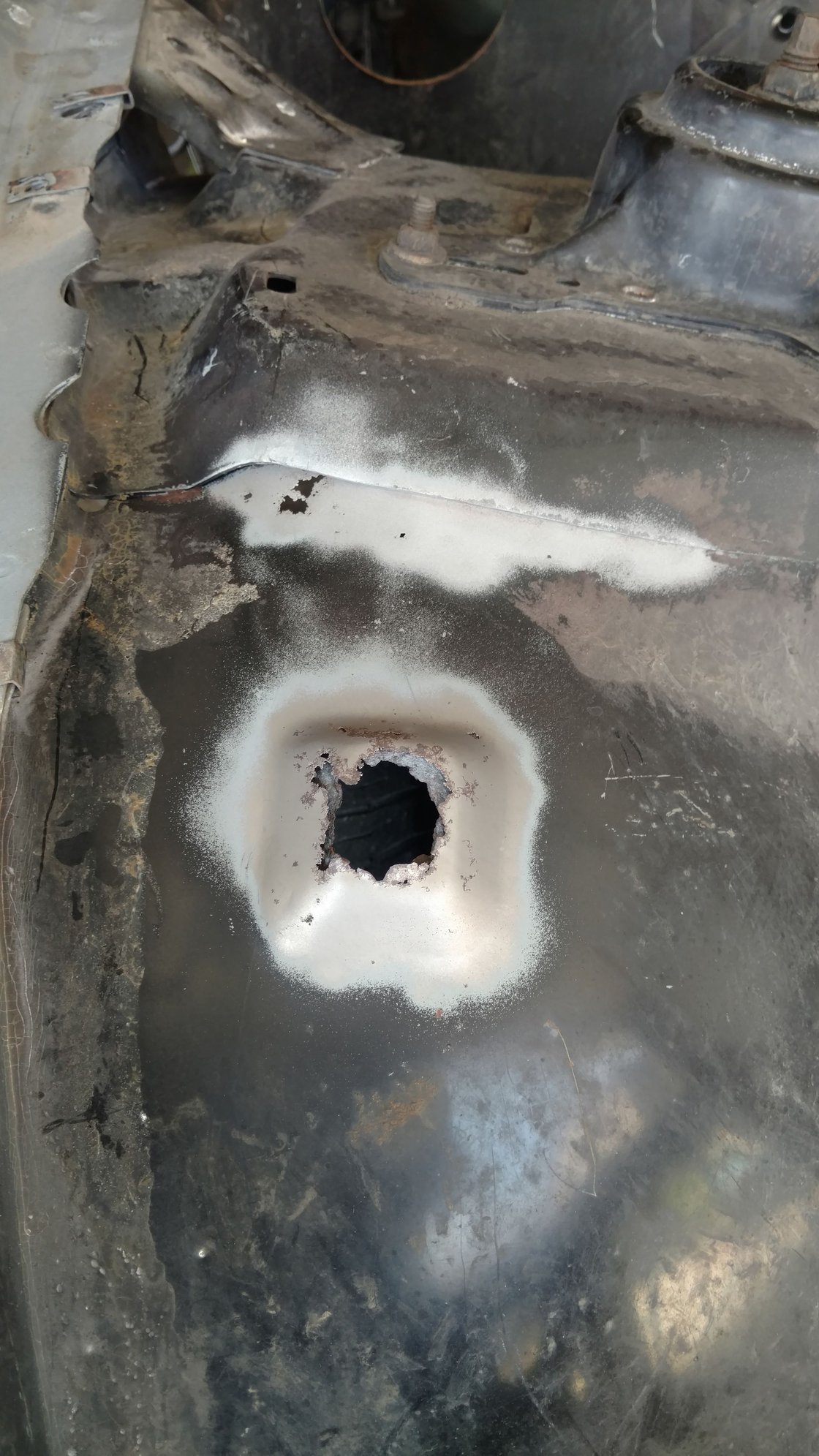

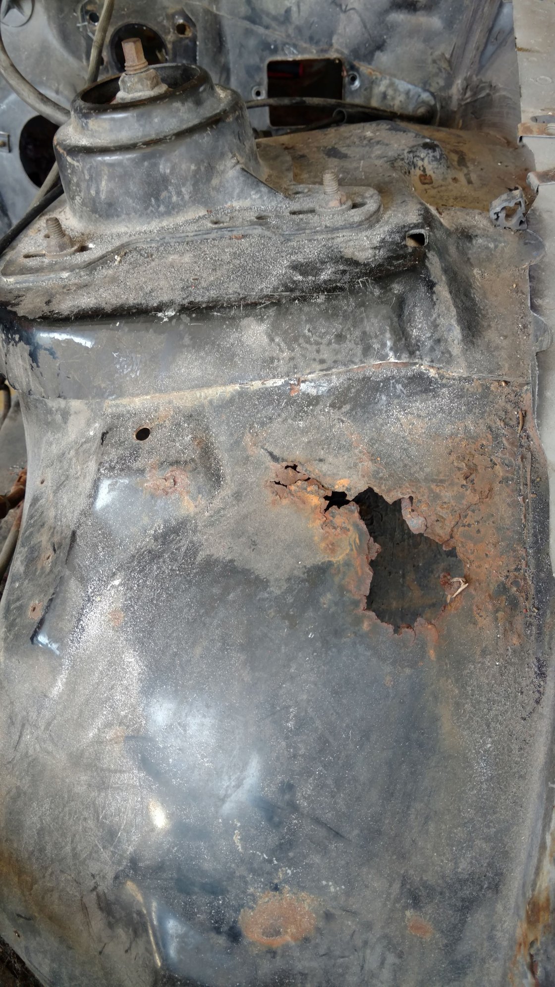

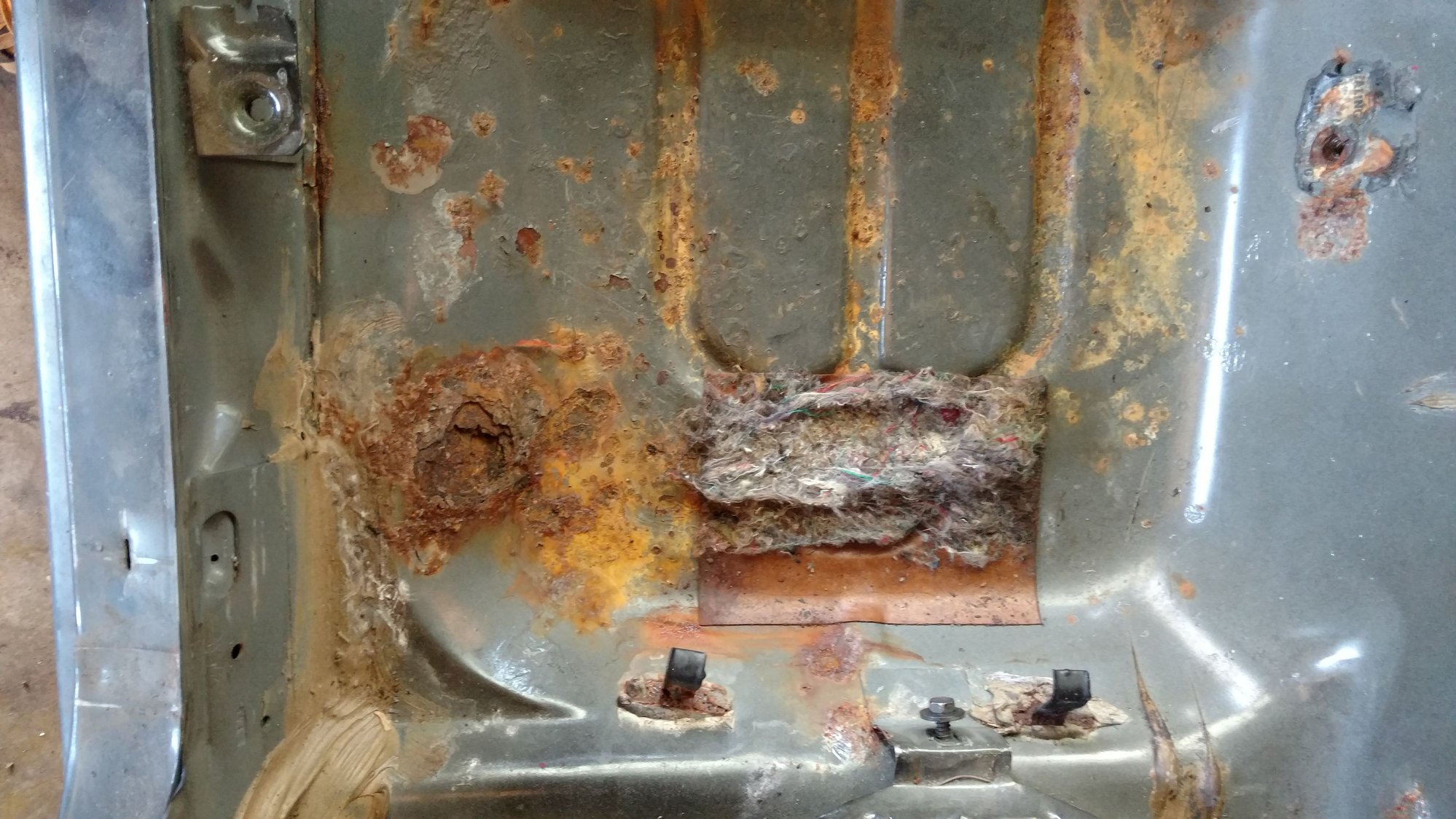

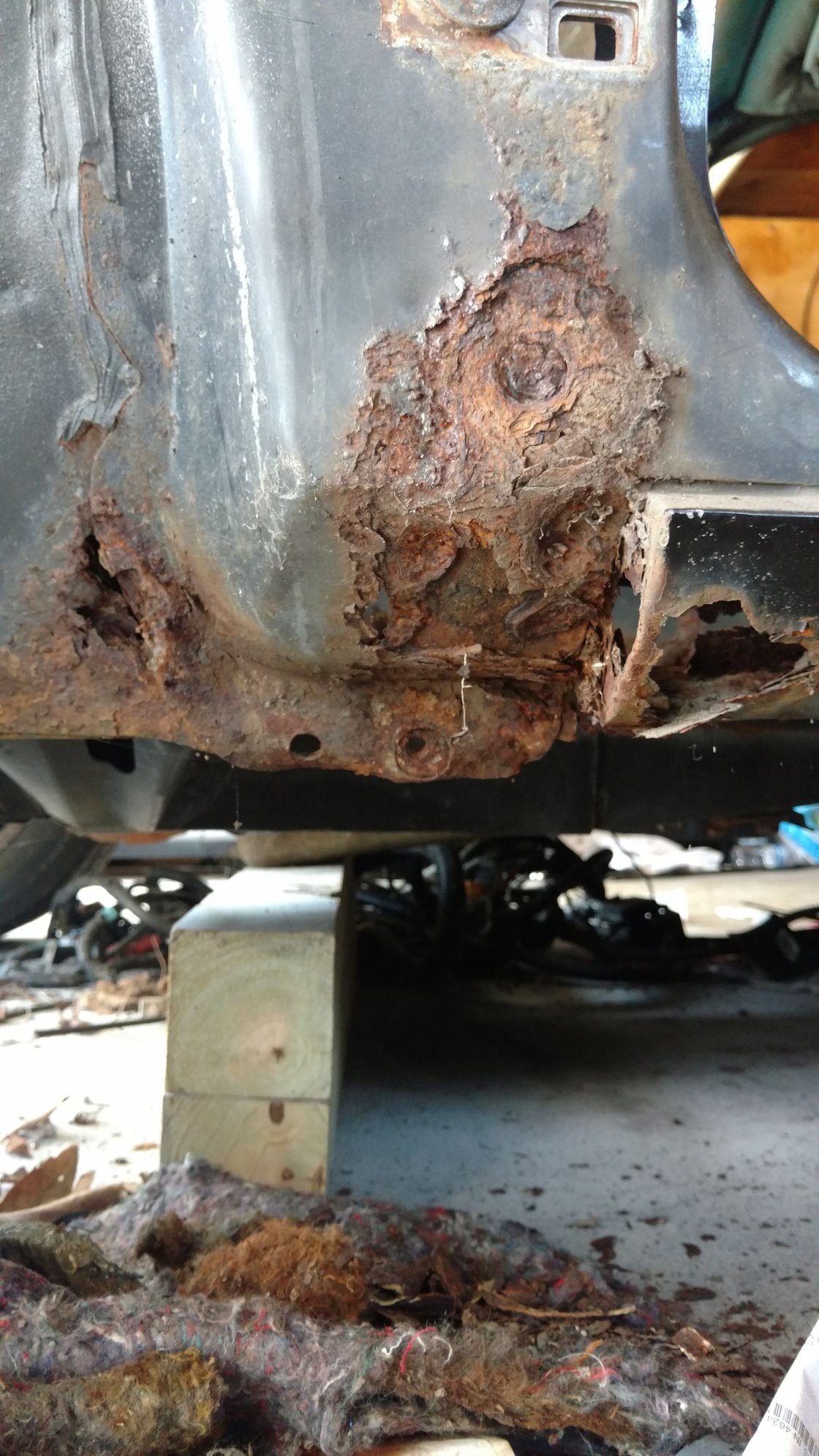

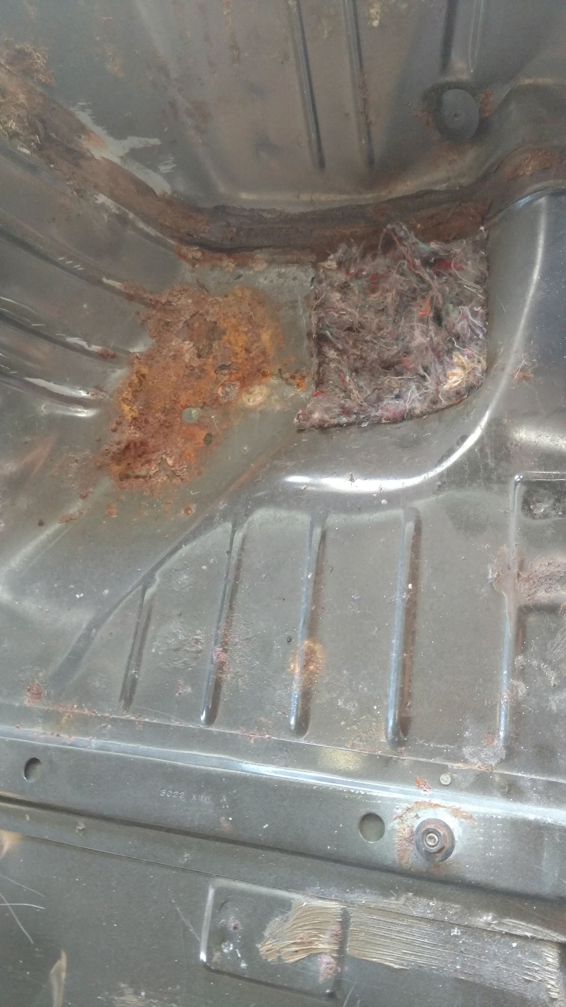

heres my project, not to bad i dont think, if anyone can help me find a website for new or solid used sheet metal for these areas that would greatly appreciated! im looking for a smooth firewall with a/c delete as well but am coming up empty handed!?!?
seeing as how ive never replaced floor sheet metal before can someone direct me to a thread where floors were replaced
being a unibody vehicle should i brace it once floors are being cut???
pass side shock tower
pass side toe kick to firewall

The rust visible on the surface, is BAD for a thirdgen. Like an 8 on a 1-10 scale, where a 10 = the driver's seat rips through the floor when you get in. Once you start stripping back the paint and oxidation, and cut away the steel that's weakened, back to good steel you can weld new metal to, you're going to have a bunch of holes the size of basketballs.
To answer your question, none of that stuff is available as new reproductions aside from the floors and maybe the outer rockers. If you want new, you'll have to fab them yourself. Finding rust free donor panels isn't impossible, but that driver's kick panel area rust is pretty common. Probably end up using a combination of donor cuts and fabbed patch panels.
If it's a T-top car, I'd weld in some braces. It's probably not a bad idea even with a hardtop. You're going to be missing a bit of structural integrity in that driver's kickpanel/floor pan area. That's basically where the A-pillar and front subframe come together, and all those panels are completely toast. There's serious rust in half a dozen or more panels in that one area.
You might look into the Detroit Speed subframe connectors. The install would cut away a lot of the floor pan to inner rocker rust, but you might need to replace the inner rockers to get good steel to weld them to. You will definitely want to weld in SFCs at some point.
All that said, I'd still cut my losses before putting any money into that shell.
