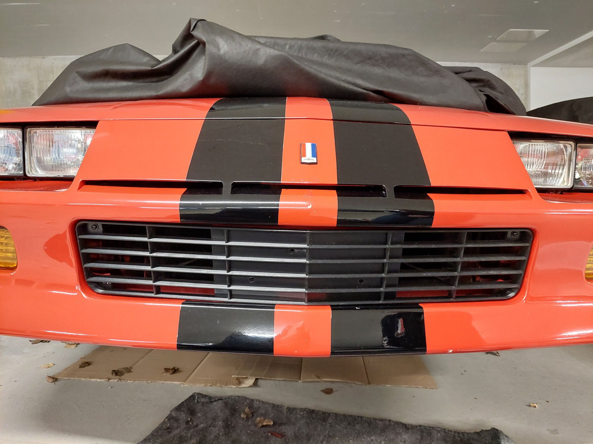

It appears the posts here are correct. I have a '87 Sport Coupe (I believe the front grill to be the same as a Berlinetta) but I found out by trial and error its grill is different from the other models (Z-28 /RS, IROC) . I believe the GM part # is GM1200323. it lists as obsolete. Ive found some part numbers it crosses to , including 14076051, 14080490, 14081332, all listed as obsolete. I was just at big car show last week, and i went to a elaborate Camaro booth (that had grills) asking about this and the guy I talked to looked at me like I was from Mars.
I ordered a grill from Parts Geek, the order form specifically asked for the model of the car, (it was reasonably priced) only to find out that it was the wrong one (it was for the other models) . Parts Geek was very nice about it, they asked for a picture and a VIN#, then they refunded my money and let me keep the grill.
Given the limited options, I decided to trim the IROC grill to fit my Sport Coupe, Im a backyard man, not a master fabricator, but I was able to cut the sides of the grill (plastic) with a hack-saw, smooth the edges with sandpaper, the holes did not line up but I was able to make some brackets to adapt out of ordinary angle brackets.
Attached are before (cutting) and after pictures of the grill . Anyone with a critical eye can tell its not the correct grill, but I don't know what else to do (its amazing, they built a lot of these cars and that grill is vulnerable to sun aging and other damage and there is no replacement, I can get a grill for a '57 chevy but not a '87. )
If anybody has a better solution please post. Great msg board. Thanks!

Pics attached for my previous post. Its amazing that I can buy a grill for a '57 chevy and not a '87 chevy.

Looks good! I have the same problem and will try to cut mine the same way you did...only I have the fog lights, but I really don't use them and don't mind covering them over with the grille.
