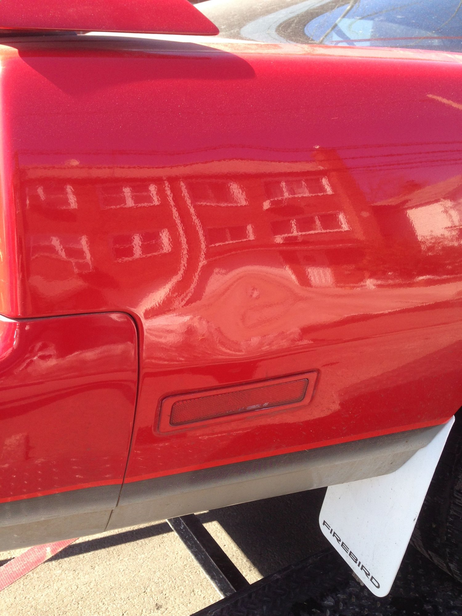

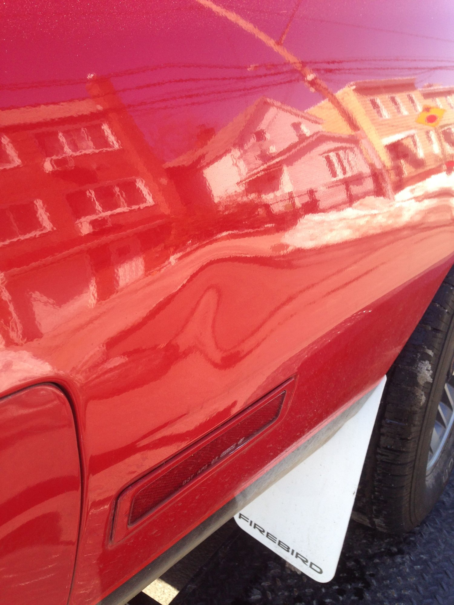

They have paintless dent removal tools now that work pretty good. I bought a cheap one that I've been practicing with. I managed to pull out a dent on this truck that was about 3/4" deep. It still needs more work but I'll get around to it when it warms up a bit. It requires gluing these pucks to the finish with hot melt glue (doesn't harm the paint) and pulling them out. Watch some Youtube videos; there are plenty of them out there.
The pics I have are pickup truck metal which is thicker than car door metal.
I want to add that I nicknamed shopping carts as parking lot torpedos a long time ago.
Shopping cart incident! No bondo 12" round and 3" deep dent on drivers door..options?-dscn1371.jpg   Shopping cart incident! No bondo 12" round and 3" deep dent on drivers door..options?-dscn1372.jpg
