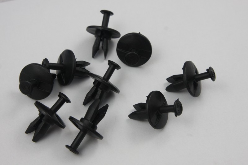

Hi all. Took my taillights out to install new bulbs after getting the car back from the body shop. 89 GTA. Should their be clips installed here? In the 3 holes shown? If so what kind of clip?

GM # 5973400
You can get one'sy two'sy quantities at any autoparts store, or you can get them in bulk for pennies on the dollar from a vendor like Auveco. If you have a local autobody supply store, they should have them.

Those are the clips I was thinking about since we’ve removed that type from other parts of the car.
