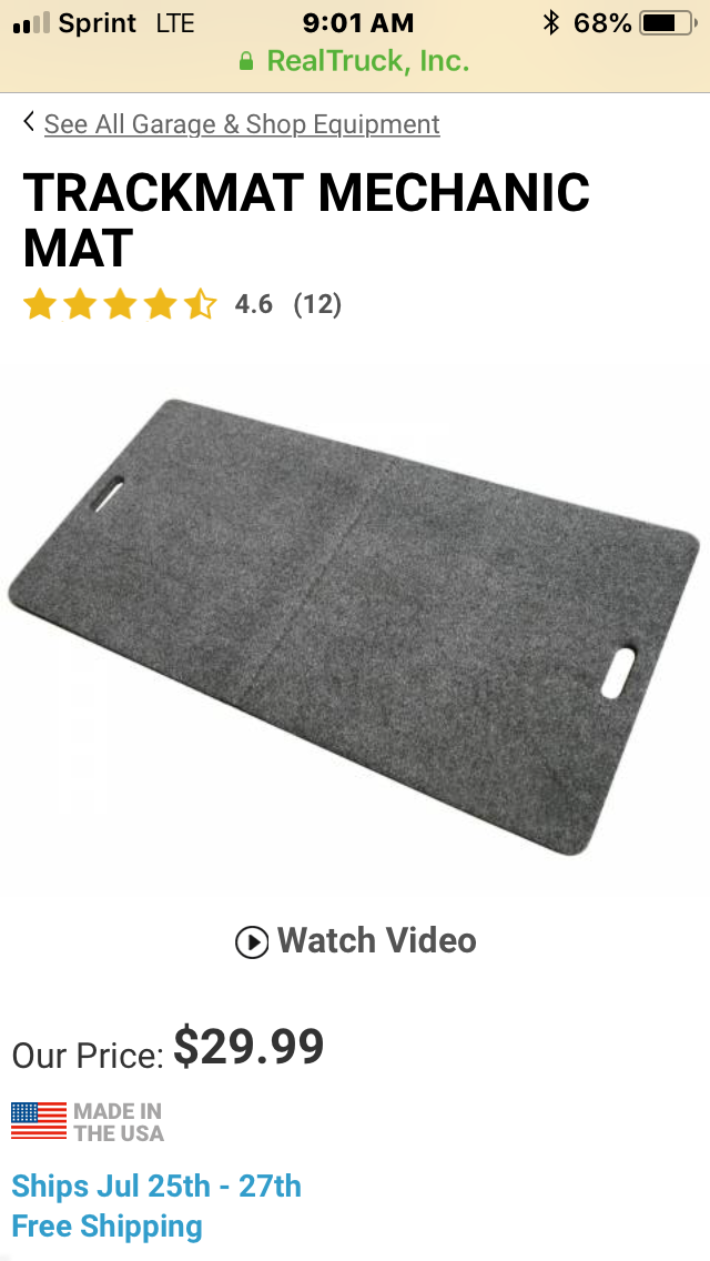

Get a low profile floor jack, and four jack stands.
Maybe a few different strengths reading glasses, because you’re gonna be doing a lot of work with the subject right in your face. I can’t work on what I can’t see.
Give up the pizza boxes, and get a proper crawling mat. Best $30 I ever spent.
https://www.realtruck.com/trackmat-mechanic-mat/
TrackMat Mechanic Mat
