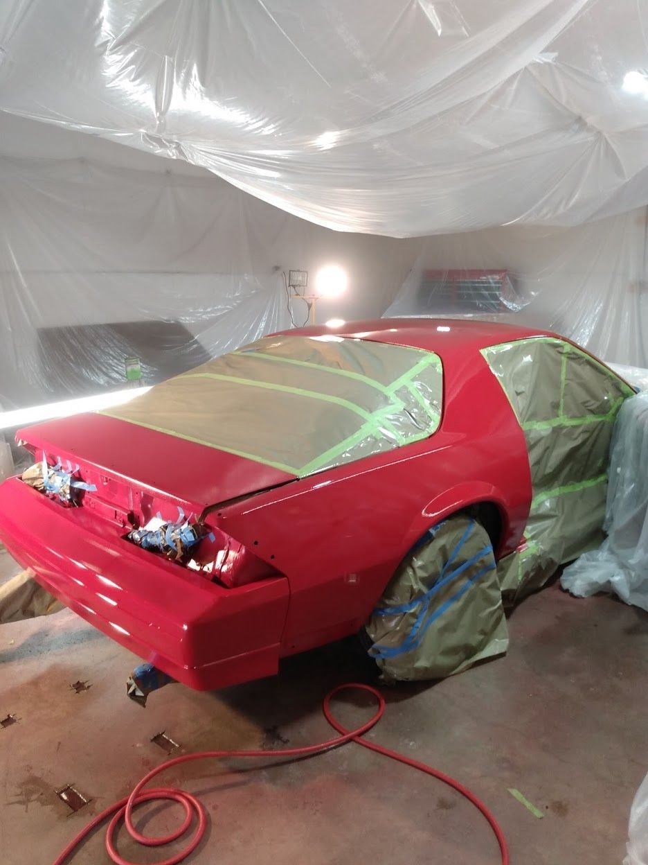

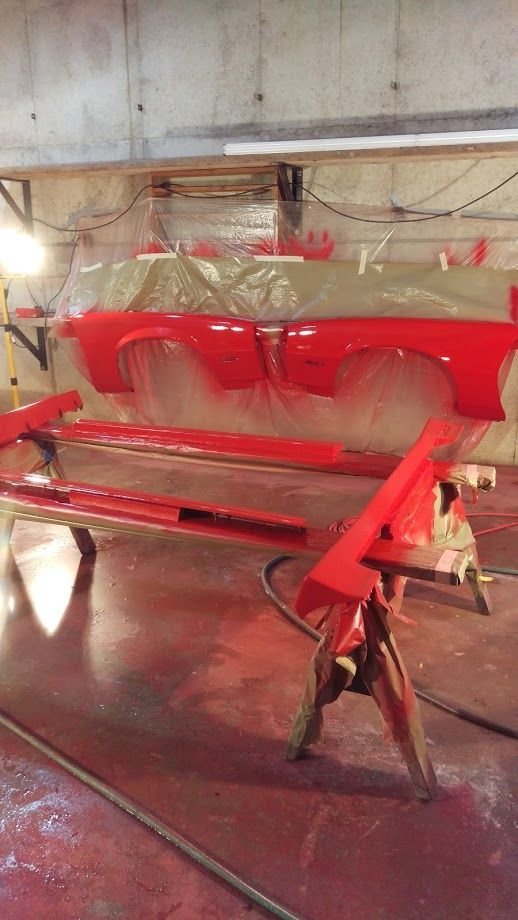

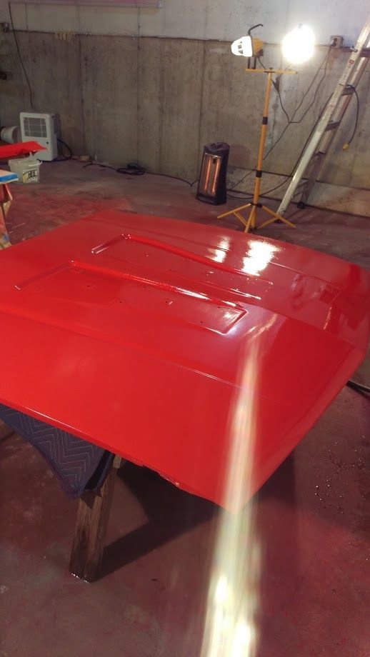

After 3 coats base, 4 coats clear, I think it come out pretty good for my first time spraying. My old man says I should have sprayed everything because I did better than he did.
(Yes I got the back side of the fenders to)
Check the driver side, front of the hood. Went a little light further back, but nothing a bit of wet sanding wont cure.
I assembled the doors this weekend for the most part. New window motors are in along with a new to me regulator from JohnInRi (Regulator works great - thanks) Cleaned out the tracks and greased it all. On a side note, I drilled out the rivets holding the track to the glass, instlaled the track on the regulator and used 1/4" bolts to resecure the window to the track once in the door. Didnt want to risk pant damage on the top.
I also installed new door lock actuators, inner door handles, and rebuilt the trunk pull down motor with a kit from hawks. (Which doesnt work but I think its a switch adjustment issue) Next weekend will be assemble front end, wet sand and polish!

that clear is not laying down good at all... it would suck to have to wet sand all of that.

I'm not worried about it. Its smoother than it looks Its a high solid clear, so it takes some time to even out. No, its not perfect and gonna require some wet sanding, but I'm not a professional and end result will be the same.

Looks just fine. Like you say, once you buff it you'll never know.

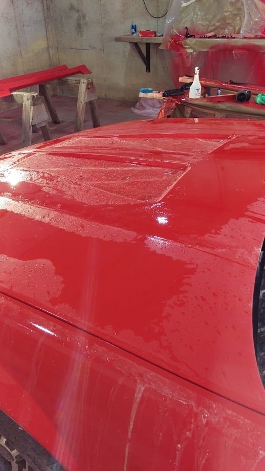

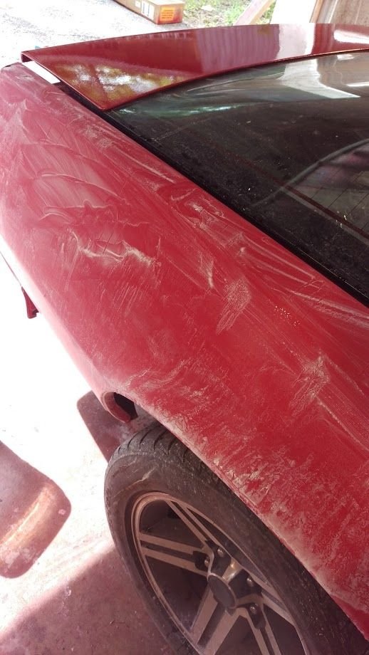

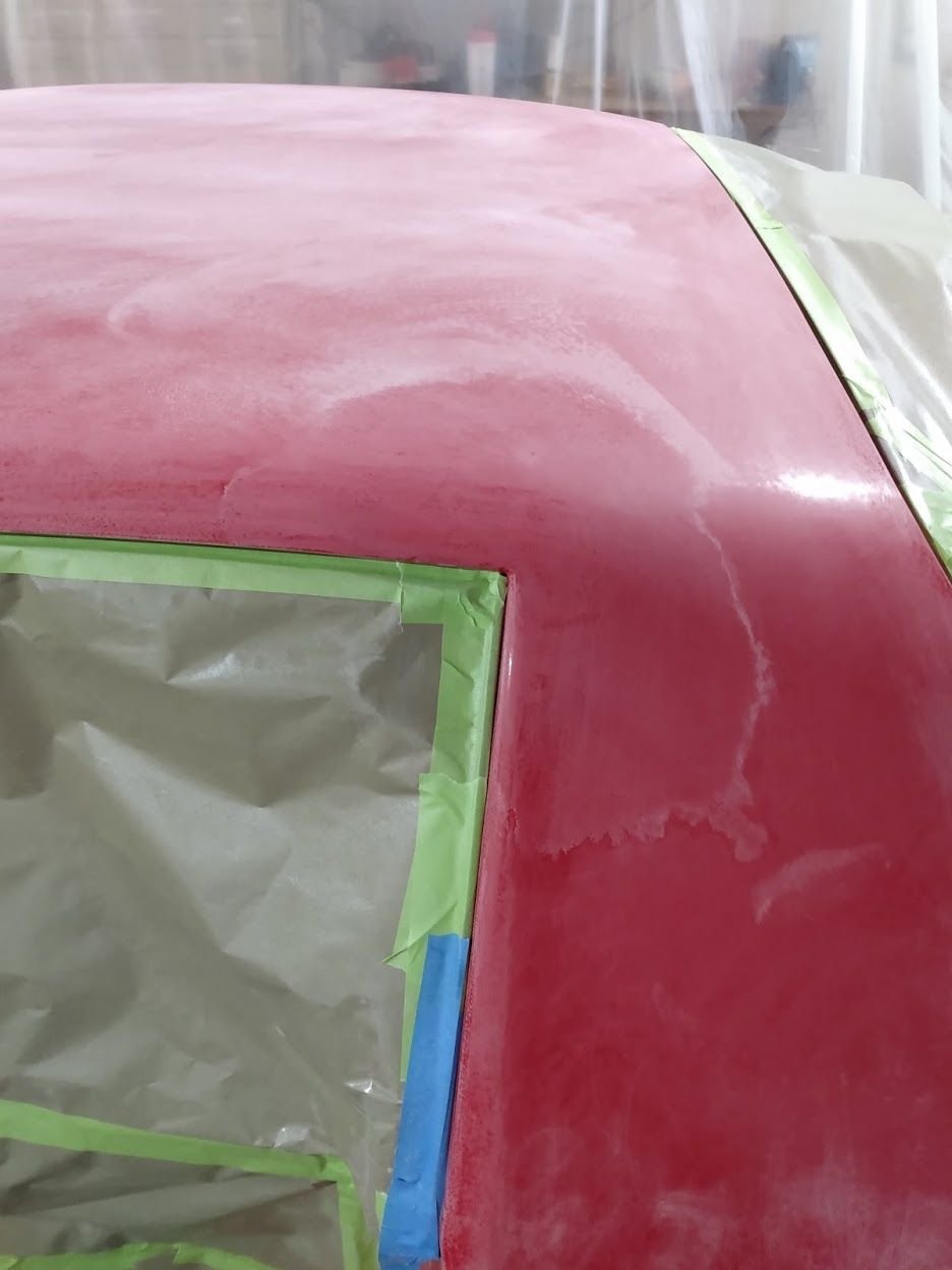

Not a ton of pictures of this weekend. I wet sanded the car. The roof/trunk were my guinea pigs on how far to wet sand down. I need to redo the trunk, and a few spots on the roof. I didnt take the trunk down far enough and theres still some orange peel, but it was a good first experience in how to use the Porter Cable 7242XP polisher I got.
When wet sanding, you want a uniform, even white. This wasnt far enough.
Now, because this paint has sat for two weeks or so, I started with 1000 grit and then transitioned to 1500 grit. This might be too abrasive for day old paint.
Use LOTS of water. You'll feel the paper cutting, then when it dries up, it gets hard to move it. Dunk it in your water bucket and keep going. Change the bucket often. I use a spray bottle on the panel for added lubrication.
I went a little further with the 1000 grit on the roof and quarters. This was before the 1500.

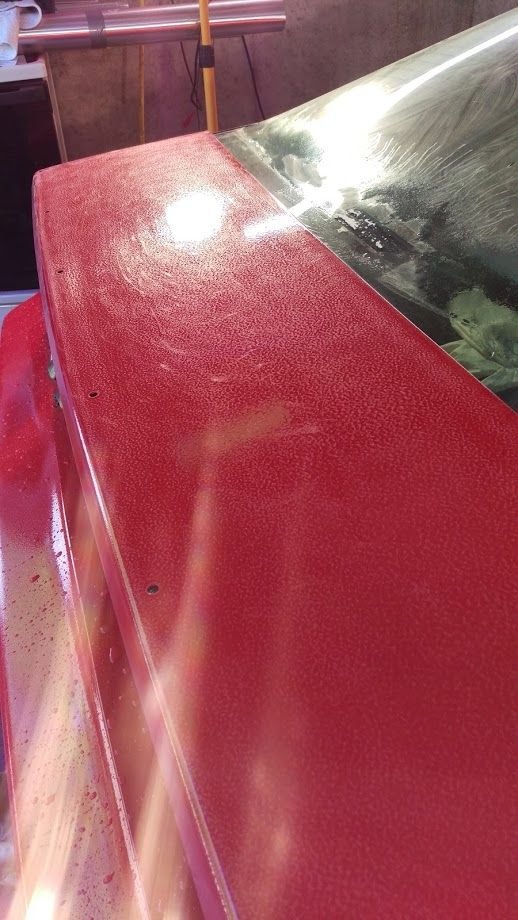

This is the only picture I have of the trunk after I polished it. Still has some orange peel, so I will go over it again with some 1000 grit, then a quick hit of 1500.
I'm using a Adams polish kit to put the shine back. A 5.5" wool pad, followed by a blue foam pad and a orange pad to finish it off.
Theres a few spots in the roof I want to touch up with 1500 grit, but the quarters came out good, and the B pillars came out like a mirror.
I didnt get any pictures of the quarters because my phone died, and I was already 2 hours behind on leaving to go back to Mass.

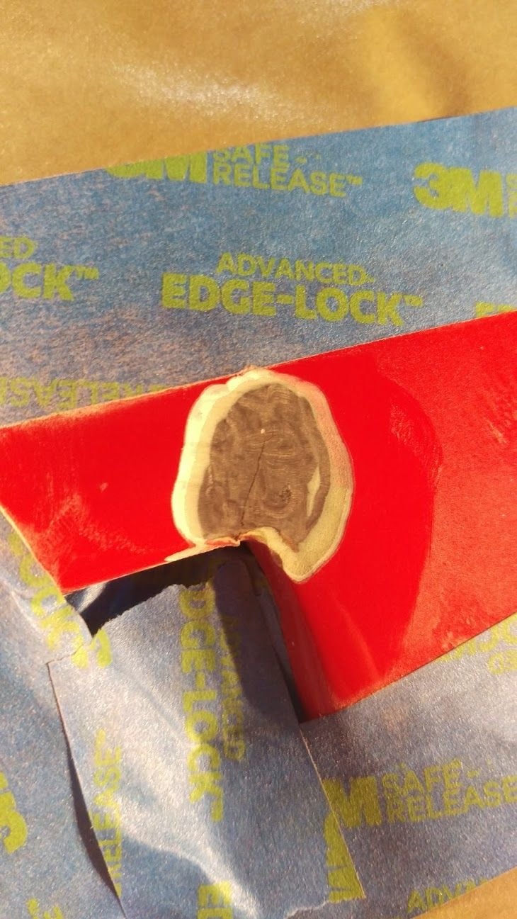

Now, for the bummer of the weekend. When I was wet sanding the rear bumper, I had a rub through around the emblem. Note to self. Stay away from the corners.
Hard lesson learned. Now it will have to come off, my dad will blend some color in, and well have to shoot clear over the whole bumper.

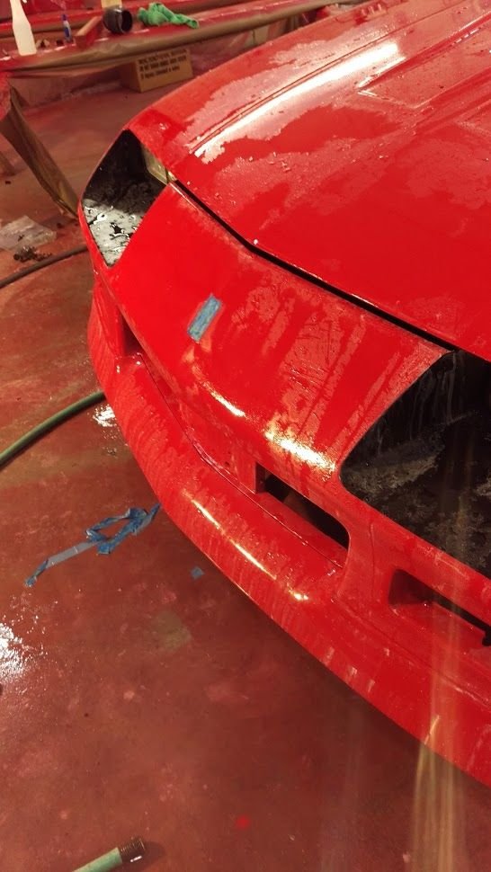

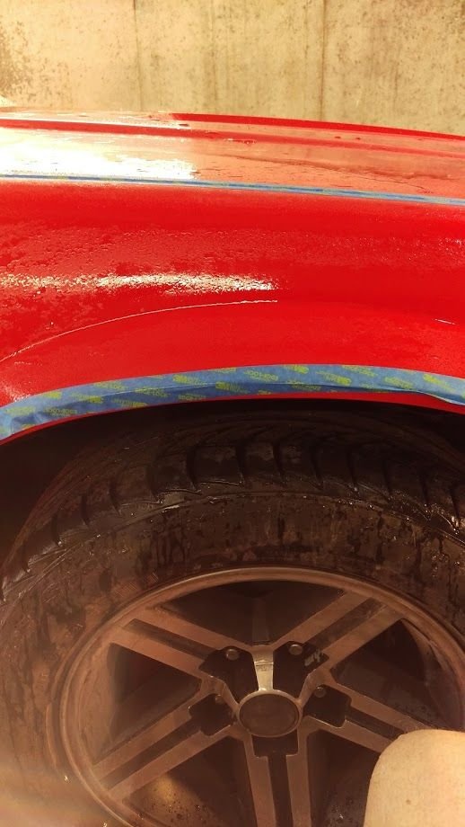

Wet sanded out the doors, fenders and front bumper and hood.
Got runs? I used 600 grit wet to sand them down. Tape off the parts that arnt runny. This prevents you from sanding through the clear you dont want to sand. Clean and pull the tape off often. Use very light pressure - 600 cuts clear fast
Wet sanding the passengers fender, I tapped off the edges i was worried about. After sanding, drying and inspecting, I noticed the edge of the flare on the fender was sanded flat. In attempt to prevent burning through i taped that edge off and continued working the fender that needed more. Unfortunately after this picture, I sanded through the base and clear on the top of the fender. On Sunday, my dad was able to blend the rear bumper burn through I had, and a small spot on the hood. We were unable to blend the fender and make it look good, so it will have to be taken down to base coat, have base coat blended in, and then the entire panel shot with clear again. Super fustrating.
I wish I shot 5 coats of clear on the entire car instead of 3. Would have given me a little bit more wiggle room for wetsanding.

After the burn through, I threw in the towel for for the day with wet sanding. Assembled the doors.

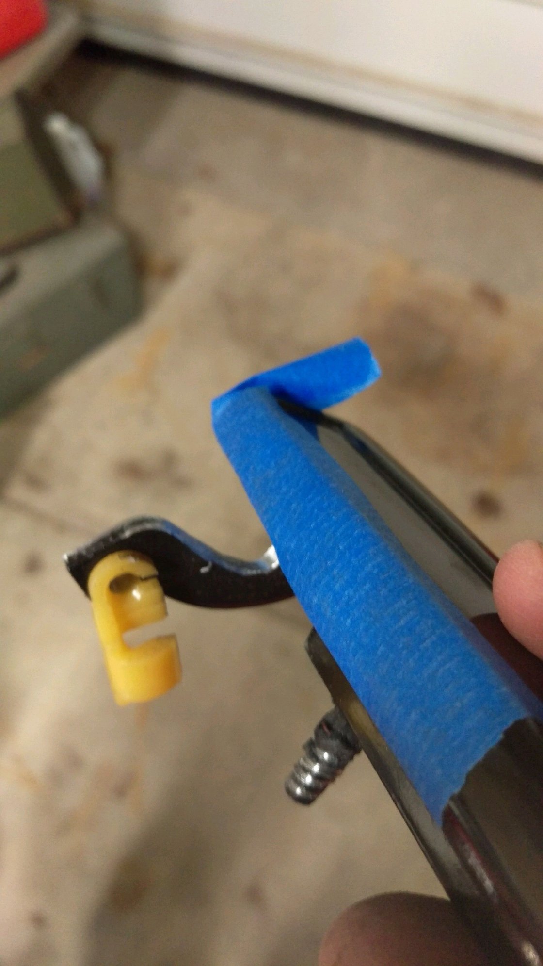

I fit in both dorman outer door handles and they fit crumby. I had to take a Dremel to the inside of the pivot as it was hitting the door, and the back side of the handle wasnt flat So I put some sandpaper on a flat table, and ground it flat. Touched it up with a bit of paint and installed both handles. The aftermarket door lock actuators didnt have enough throw to move the locks in the latches, so I put the original ones back in.

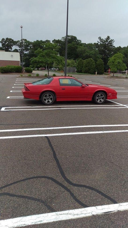

Well, shes road legal.... kinda....
Ive got a bunch of odds and ends to finish up, interior, door panels, actually buff the ground effects, and I need to glue in some studs for the louvers (and actually wash the damn car - The ride home from Maine was a monsoon) . Im still not happy with the roof, but I'll worry about that next winter. Might be time to change the exhaust, holy crap I forgot how loud this thing is.

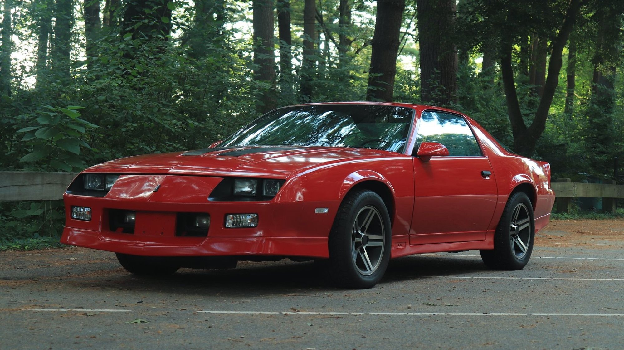

Re: Project 86
Better late than never I suppose.

On a side note: I've decided I'm not happy with it, and I'm gonna shoot 2 more coats of clear on it this winter.

I just happened to be browsing TGO and noticed the update,................. That last pic is my favorite 'pose' for a Thirdgen. Car looks great Dan, I hope your desire for perfection doesn't stop you from putting too many miles on it this season !
Car looks great Dan, congrats. That last pi from the left rear is the money shot, the greenery in the background really compliments the red perfectly.

Well boys and girls, Im back after a extended absence from the car scene. Roughly 6 months ago I lost my housing situation in Massachusetts, but at the same time a new job opportunity came to light that was too good to be true, so I took it. Currently im couped up with a relative until I can become a first time home owner, but I haven't forgotten about the car! Lifes just been busy!
As in the last update, i had a crack in the pillar that needed fixing. A previous weld must have let go on me so I dug into that a few months ago.
Edit: Sorry for picture quality - Some of it is from the cloud/old phone before it died.
Ground down to bare metal, Drilled a hole at the end of the crack and welded it up.
Hit it with filler and let it cure
Sanded and hit it with guide coat

Sanded the car with 400 grit to help the next few coats of clear adhere properly.
Garage setup (I had put plastic drop cloth suspended above also after this picture)
Now this is the interesting part. After filling the spot, I had spot primed it, my father blended in color and I had to spot clear the area. I again used the block and flattened it out. From what my father had told me, blending in just one spot is impossible because you will see the newer layer and it will shrink as you sand it, right up until you burn through and sand off the paint. Correct way is to spot paint/clear, then shoot the entire panel. That way, the "seam" of the repair spot is invisible once covered with new clear.
And yes, the repair does go lower than the crack because the damn welder popped in my face and made two burn marks lower on the panel

Other than the repair spot, I decided to wait (seeing i have no place to store the car other than on the street currently) and shoot it in warmer temperatures. It may have been why the results were better.
I shot the body/bumper/deck lid 3 weeks ago with good results. Also, doing it this way was much easier. The next day, I was able to sand it down with 1200 grit in a matter of a few hours. Last year I waited until the next week and the whole car was hard as a rock.
Shot the hood, doors and fenders this past week. Best end result yet. Again, everything sanded out super easy the next day.
Side note, Anyone know why the pictures so damn small?
