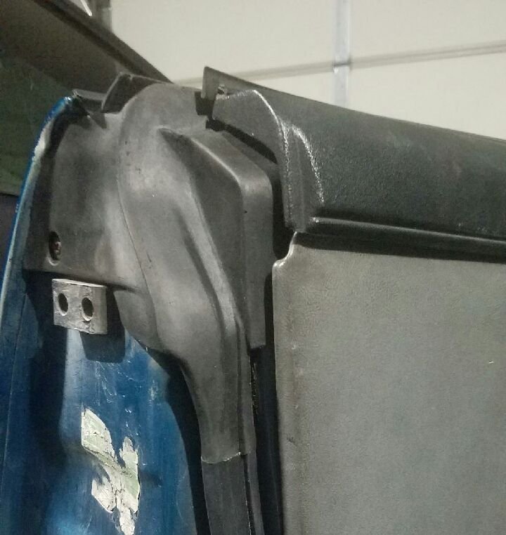

Don't waste your money on these. The door seals are the worst of the other 3 brands and are the most expensive.
The bulb part of the seal (that wraps around the door) is to thick, like Metro. The end blocs are molded/cut poorly and there is nothing reinforcing the mounting holes. Not even a washer molded in, at least, like SoffSeal. The material feels nice, at least.
Making something for a long time doesn't mean you've been doing it right the whole time.
Fairchild seals are probably the most accurate to OE made but unfortunately, the material is 'rock' hard compared to the rest. I'm not all that interested in making the doors any harder to close. The ones I has gotten also needed a small bit of stretching to meet up to the other side of the door.
SoffSeal has the closest to OE dimension for the bulb part and are not as soft as Steele or Metro but are softer that Fairchild. The end block only having washers molded into the end block are a minus as well but, at least they put something in there.
Metro, I only remember that were 2x the thickness of SoffSeal (like Steele) bulb and I couldn't even get my door to close anymore. The anger set in from there and I shoved them back in thier box and shipped them back.
SoffSeal, which I was hoping to replace, has been the seal that allows the doors (on my car) shut the easiest. I had let the Fairchild seals set shut over a long weekend and they were still unacceptably firm (for me).
All just my opinion having tried all 4 brands that make seals for these cars. Take it however you wish.
