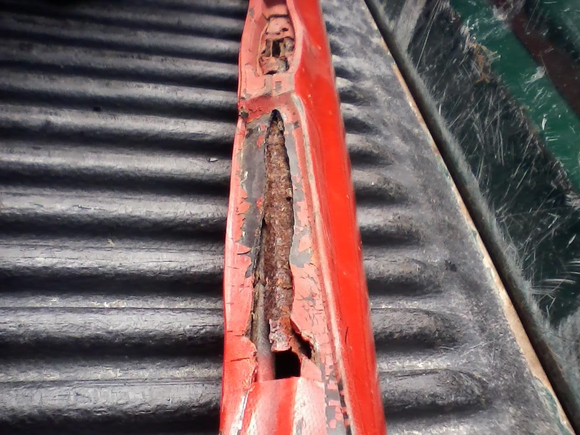

Heres a pic of mine that was in decent shape before I pulled it. I too had planned on fixing it but..It rots all the way through man. That metal is in more places than the mounting points unfortunately. Good thing about the replacement is that its only a fraction of the weight also, so much lighter.

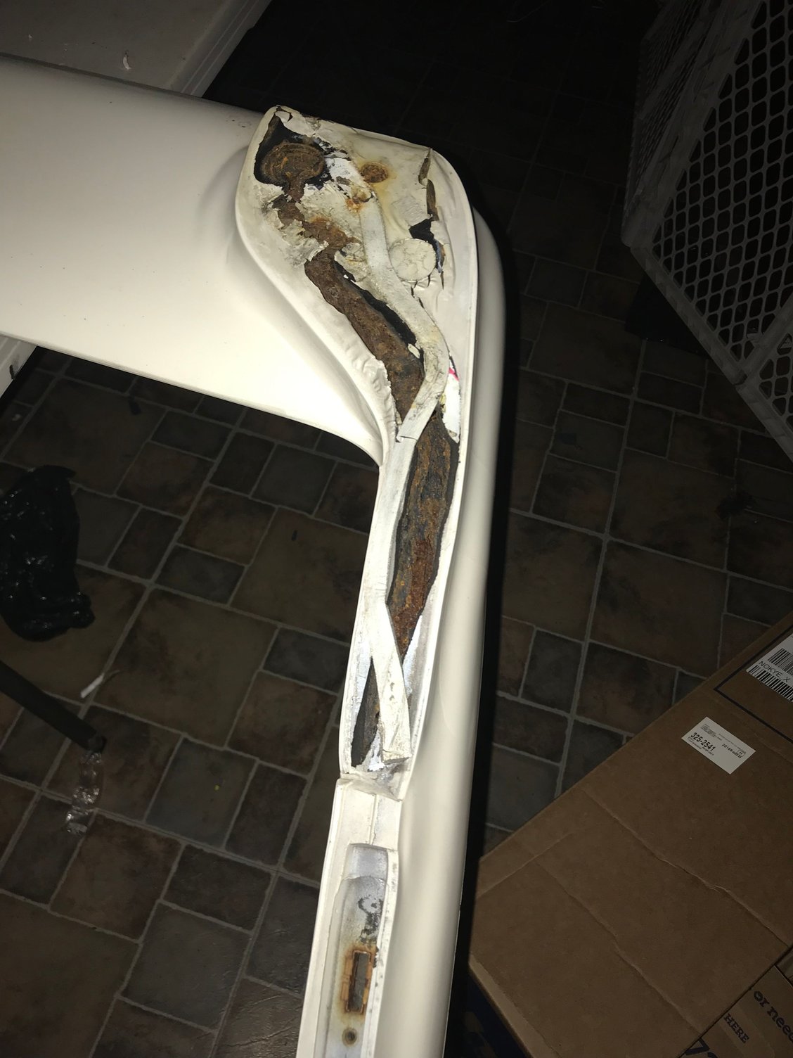

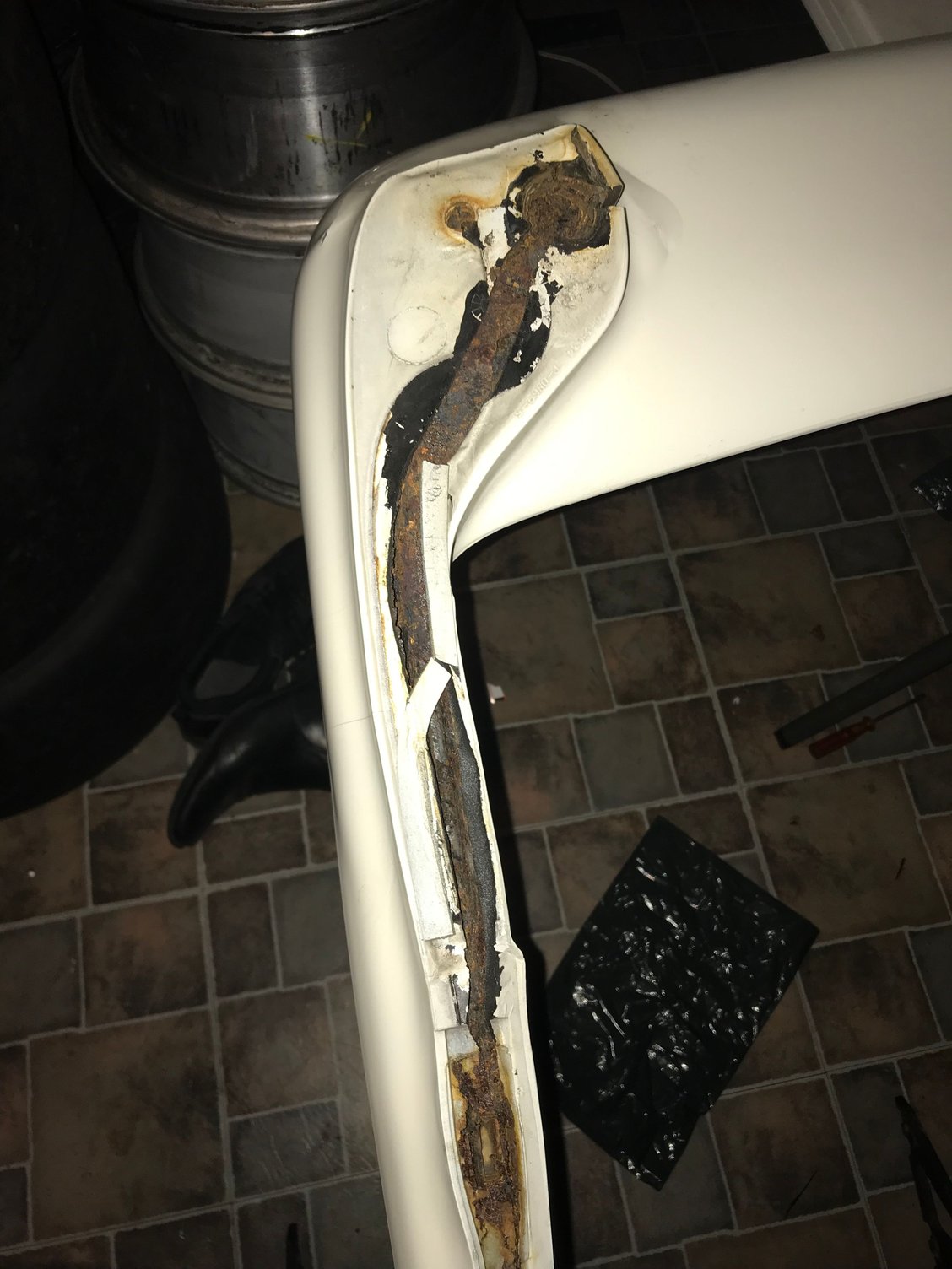

I have taken a look at mine and did a little research on this forum and it’s apparent that all problems start with water entering the metal frame of the spoiler and rusting. The resulting expansion is what damages the spoiler.
So if you have a spoiler that is in fairly good shape it is vital that you rust proof it ASAP. This would probably include removing it and addressing all the points that connect to the body. Probably using a liquid rust converter like Ospho and applying it down into the spoiler openings. Then sealing it as water tight as possible and using corrosion resistant hardware.
Of course, you take a risk when going to try to remove the spoiler. Proceed gently.

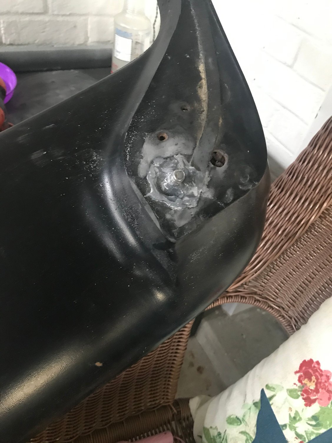

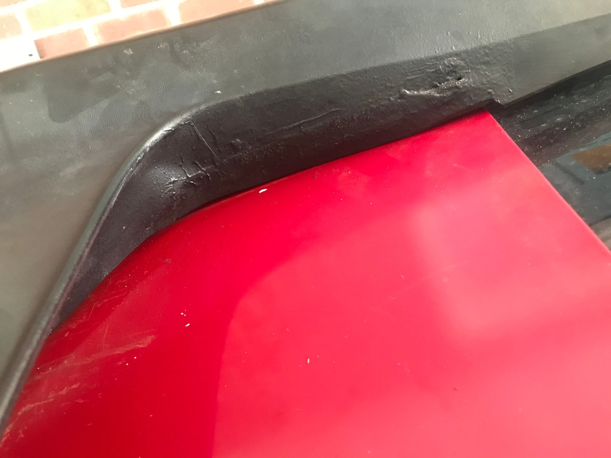

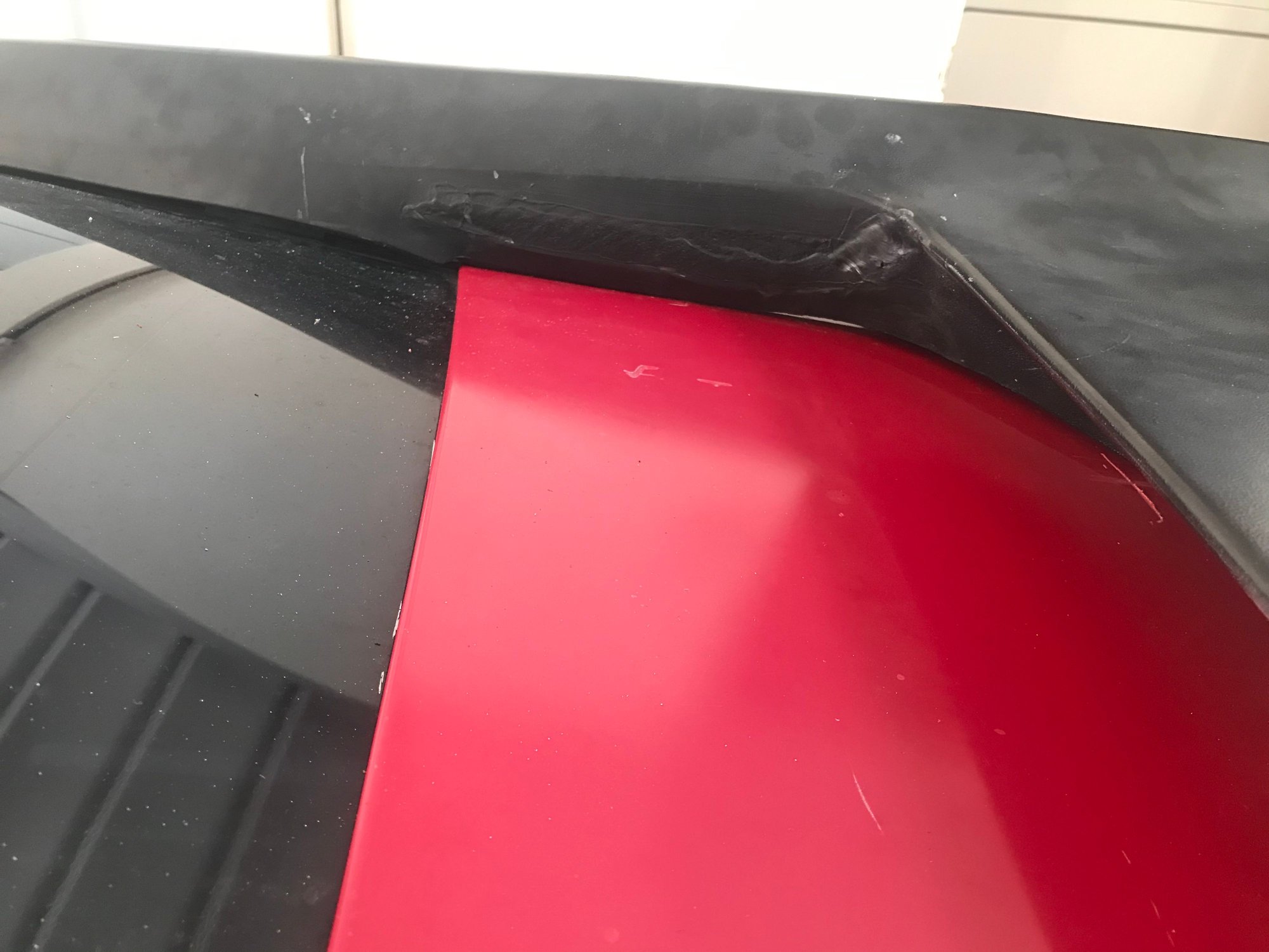

I try to keep my 86 TA as stock as possible, or atleast as stock with the modifications it had when my family purchased it as the second owners in 1991. That being said, I too am having the splitting issue and was debating switching to fiberglass. I opted to try and fix the original rubber one. I pulled it off, removed the rust, used “flex glue” to fill the crack, waited for it to harden for a week and then used JB weld plastic to cover it and keep out moisture. I’ll post one pic of the flex clue and I’ll post more tomorrow. My plan now is to sand down the JB weld and then spray a light layer of black “flex seal” over it and call it a day. Then I will use the same method to set a screw into the corners and bolt it down to the hatch. Gotta find the 6 plastic clips for the moulding cause those are broke and that should do it. It might still split in other places later but to me it’s worth it if I can save the original. Hope this helped! Btw, anyone got a link for the plastic clips? I have the part number.
Old Jun 11, 2020 | 03:54 PM
Joe Clever's Avatar
Joined: May 2020
Posts: 6
Re: 85-90 Wrap Around Rear Factory Spoiler Repair Thread

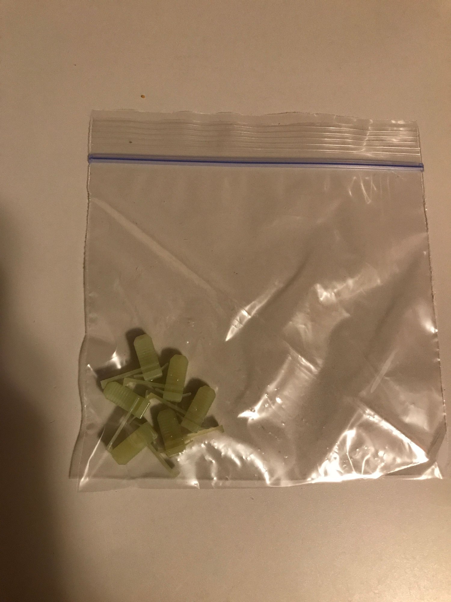

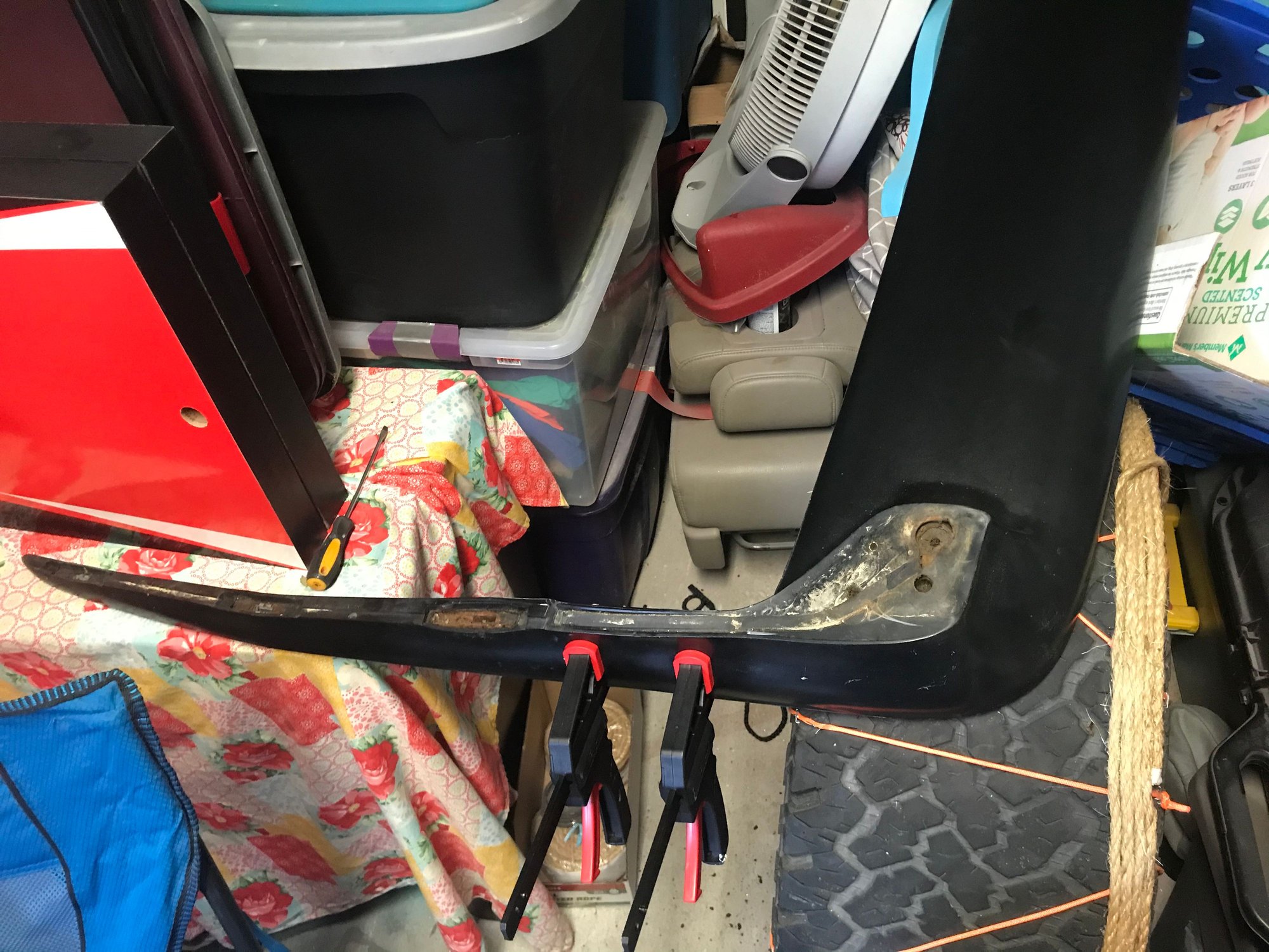

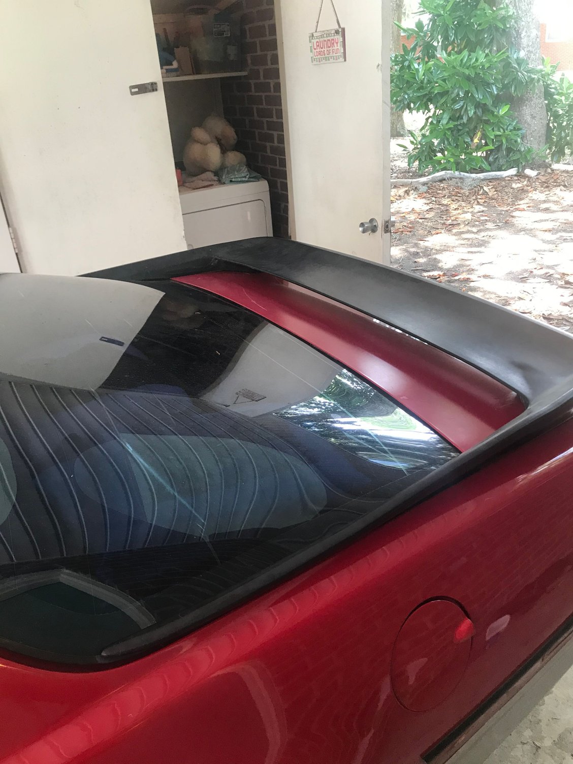

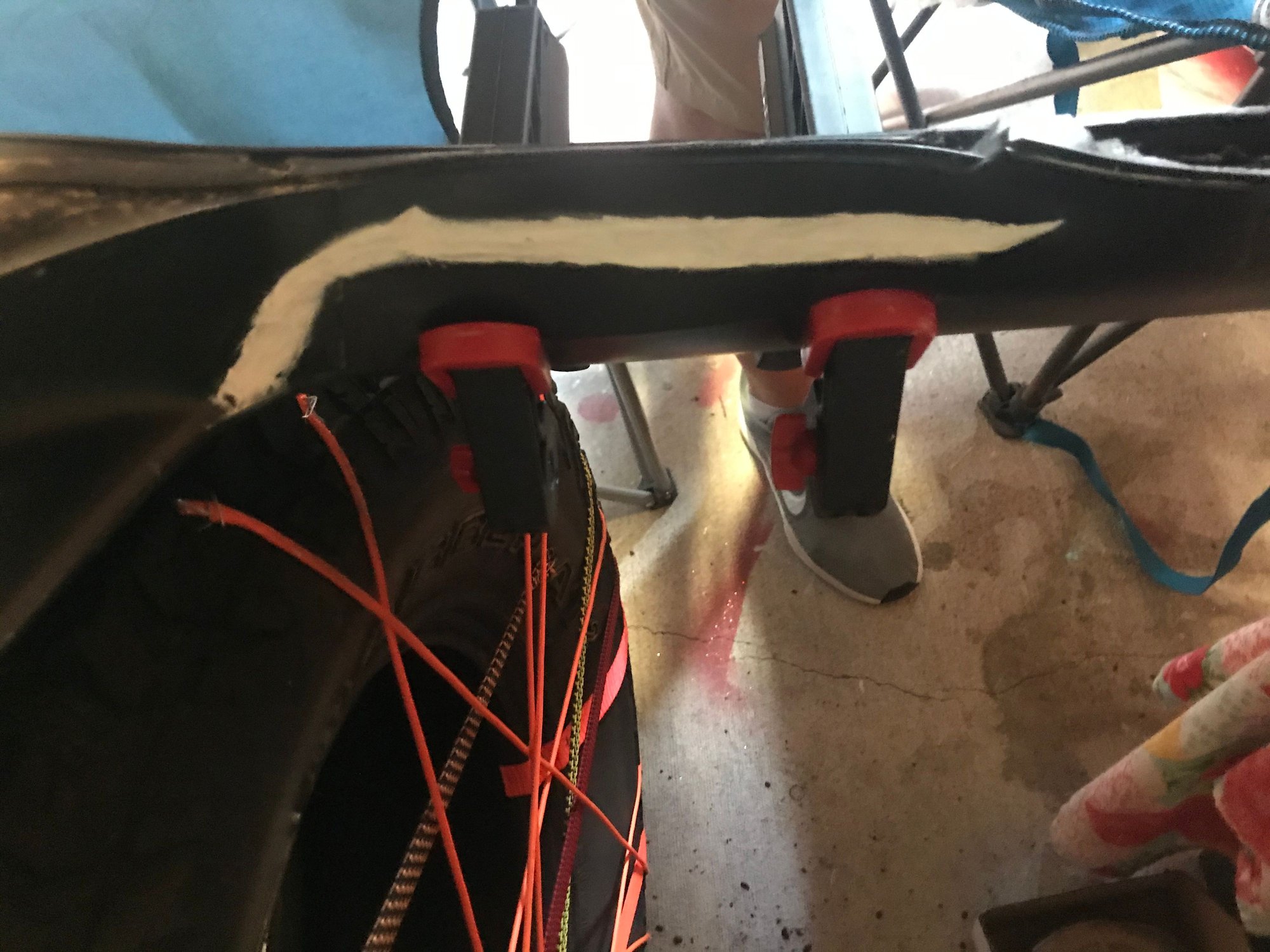

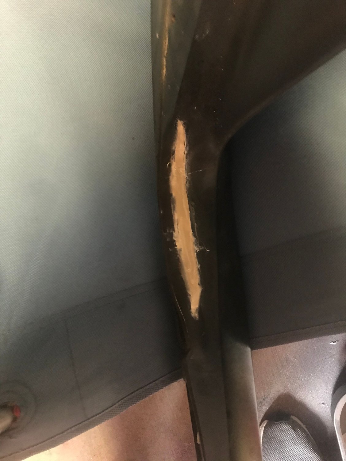

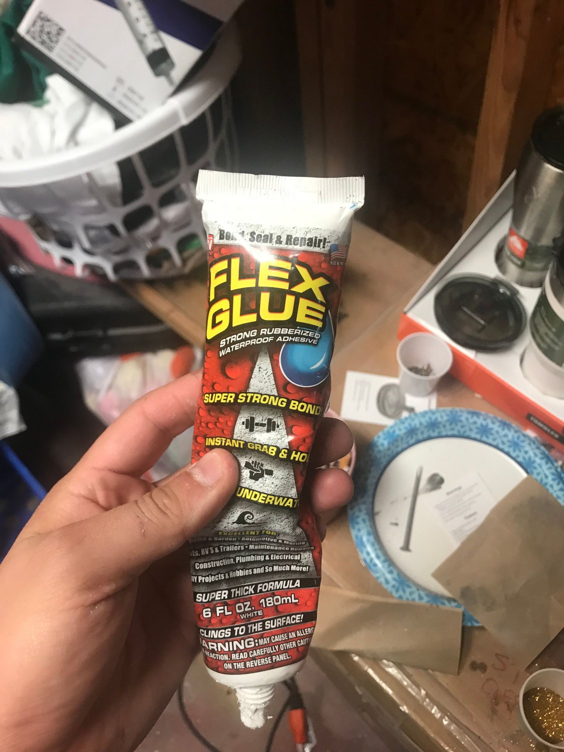

Alright gents, I went through the whole process, found the clips on eBay for 25$ from Midwest muscle cars, learned a few things and got it out back together and back on. Pro tips:
don’t lose the metal brackets inside the spoiler that house the clips. Can’t get more and you need them. Use 3/8x1” bolts for the corners, perfect size with a washer and lock nut for the inside. When you put the adhesive around the bolts, put masking tape over the threads or you’ll regret it when you can’t get the nut on and you’re grinding out the hard epoxy. I used JB weld steel epoxy on the bolts which worked well. Flex seal is the bees knees. I also sanded any rusted areas and covered it with flex seal, and that should waterproof a lot of my troubled areas, it’s literally liquid rubber. I recommend buying the paint on because it was hard to be precise with the spray and it leaves an un smooth layer. Lastly, we learned that when reattaching the spoiler, it’s best to put the clips on the car first and then press the spoiler onto it versus putting them in the spoiler first. It’s hard to line it up the second way. Hope all this helps and here are some of the pictures! God speed gents!
Clips from Midwest muscle cars via eBay
Removed spoiler
Flex glue filling
Jb weld plastic
Jb weld steel with 3/8x1” bolt
Flex seal after dried
Finished

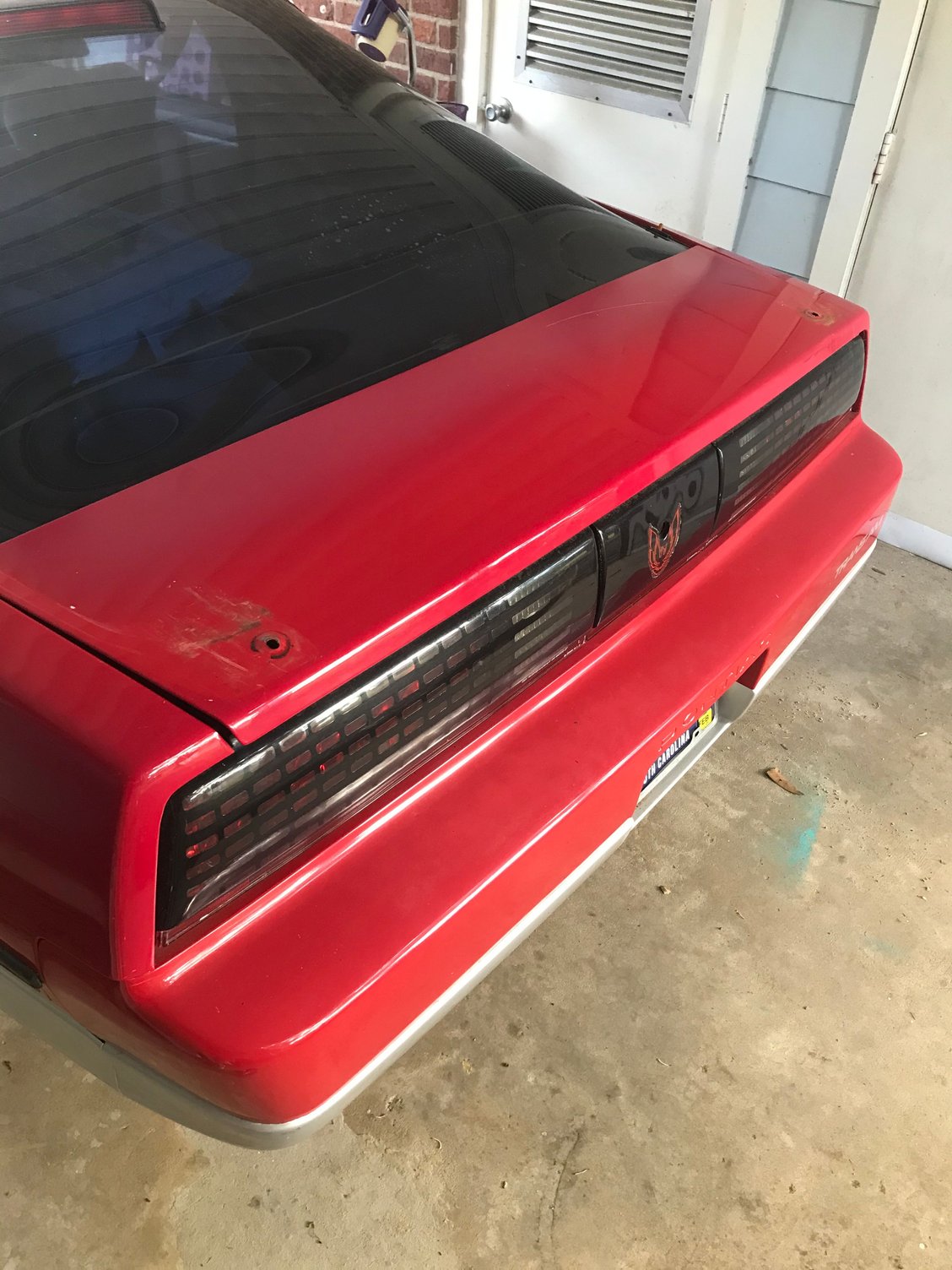

Adding my question into this with regards to repair, i haven't taken mine off but there is definitely some indication of rusting. I much prefer the style of the pedestal style spoilers anyways my self. My searching has come up with differing opinions. i have a 1990 gta with the aero wing but the previous owner rockguarded the top of it black??? big yikes. anyways would switching over to that style work with my third brake light? or do i have to do a bunch of drilling and modifying? or should i just get a new deck lid? Im new to all of this. Thanks for any input.
