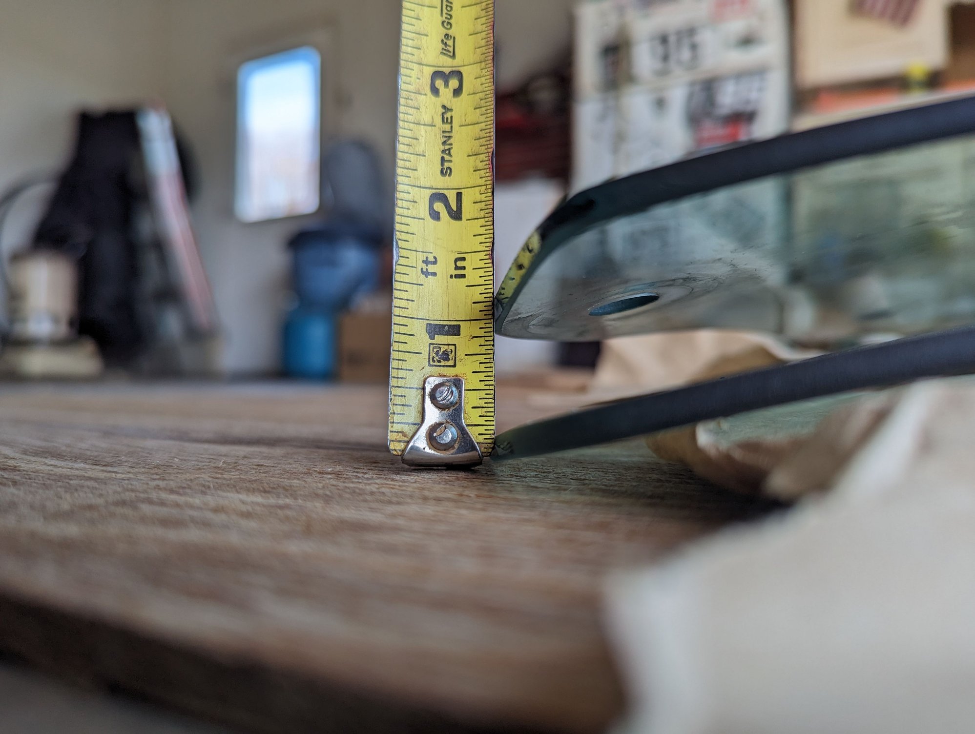

Old Mar 17, 2024 | 05:49 AM
KCG's Avatar
KCG
Joined: Jul 2014
Posts: 369
Likes: 11
From: Md.
Car: 89 IROC
Re: Door glass interchange
I had to try anyway and you're right, it doesn't fit! The 90-92 glass is bowed such that at the front and rear its against the inside of the door, and I mean scraping metal, while the middle is jammed against the outside sweep.
Here's one pic of the new lying on top of the old. And this is just resting on it, I'm not pressing it down tight on the other end and its still this far off.
Back on the phone with Classic, and I'm getting the 82-89 version next. I hope theirs is different than Ricks.
That's exactly what I encountered...must either be a bad run, or the mold/spec they are using is way off. I would like to mention that Classic Industries and their technical department were very helpful, and provided full refund on the defective glass. Yes, I wish I didn't have to go through all that for something so seemingly simple..as I had swapped glass on other cars with no issues. The 82-89 glass from Classic dropped right in (yeah..you really had to fight that 90-92 piece, because of the extreme curve...middle glass would press on outer run, and the front/rear would curve inward)...when you get it, you'll notice a big difference...and I had no issues with the holes for the hardware, as the only difference was one extra hole you will end up with that does not get used.

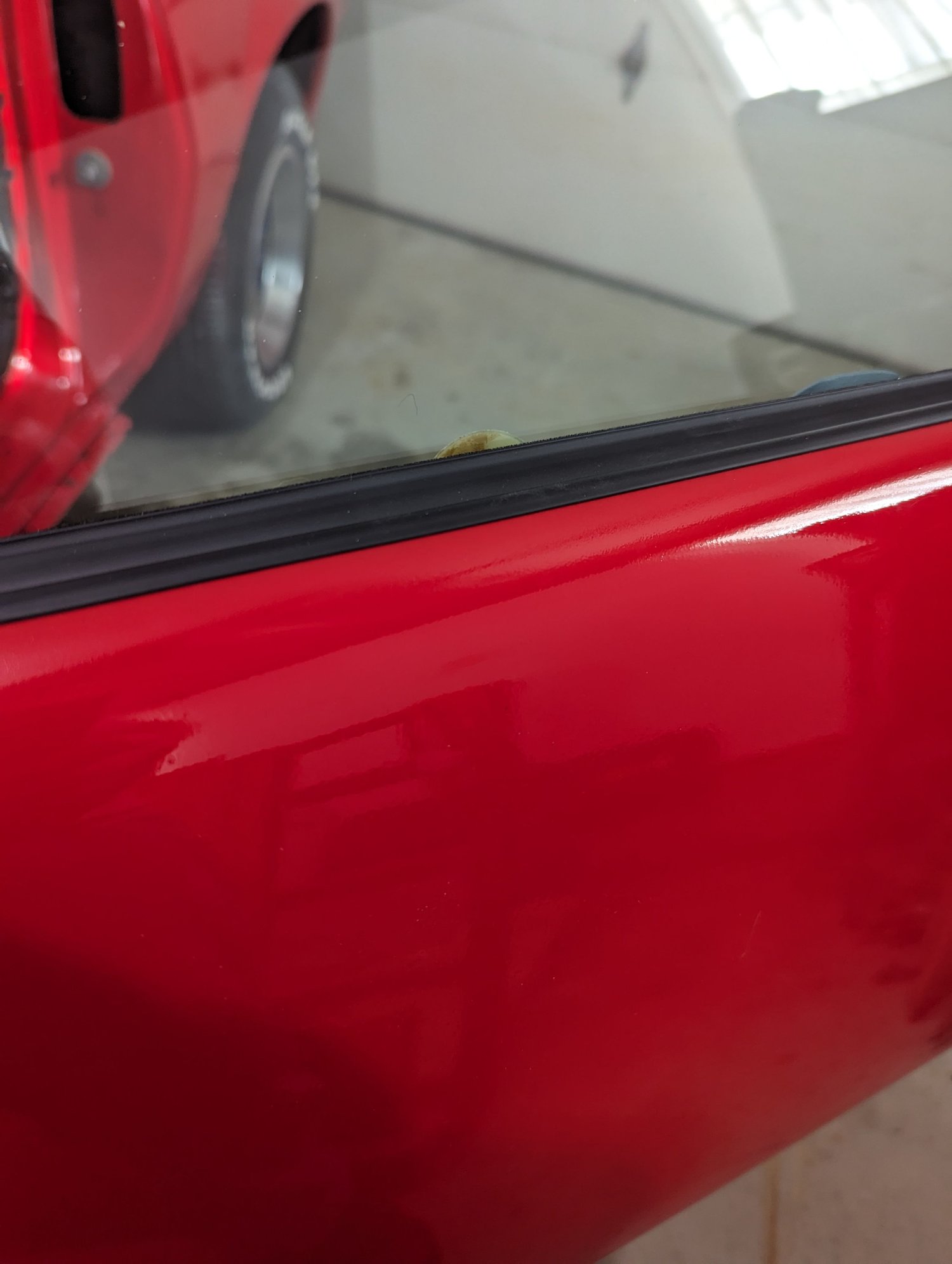

Old May 6, 2024 | 09:14 AM
KCG's Avatar
KCG
Joined: Jul 2014
Posts: 369
Likes: 11
From: Md.
Car: 89 IROC
So to update this saga I received another set of glass from Classic Ind for 82-89. It fits! Mounting holes line up and I see no issues with it mounted loosely so far.
As 1989rocg92 said above, Classic tech was very helpful and took care of all the shipping back & forth. They are stumped as well on the 90-92 glass and evidently have decided it was a bad run. Shortly after suppling an RMA to ship it back, they cancelled it and said "never mind, we don't want it back". That told me they realized they had a problem with this glass. Wasn't worth it for them to ship back glass they couldn't resell.
BE FOREWARNED! Just use the 82-89 glass
So, I am going to respectfully add my 2 cents to this thread:
I have a 1991 Z28 w/305, restored to stock over 10 years ago. I've been wanting to replace the original door glass because it's all scratched up and water etched from the previous owner. Decided to pull the trigger last month.
Based on reading here, I bought the 82-89 glass from Classic. The glass received matched my existing glass in shape, it had (2) extra holes as noted in previous posts, but (2) of the holes I needed for my hooks were drilled about 1" too high, and if installed would prevent me from raising the window up all the way.
I called Classic. After being chastised for not purchasing glass for my model year, lol, I was able to return the glass (shipping at my expense) and bought the 90-92 glass.
The 90-92 glass arrived today, and it matches my existing glass 100%.
