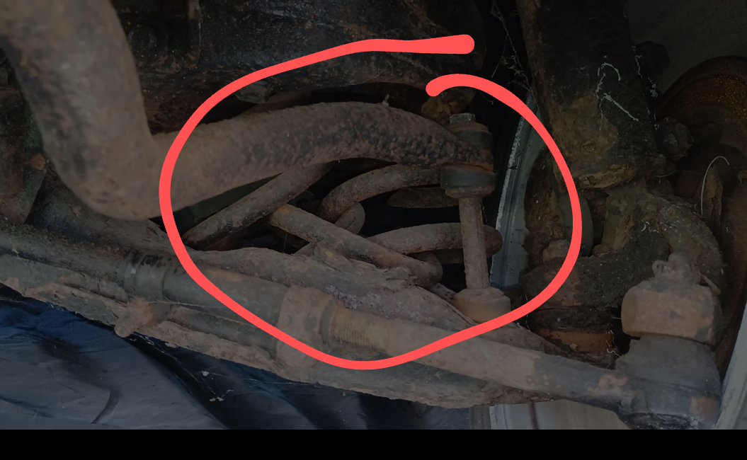

3 mm would probably be within 1980's spec GM had for squareness!! It's possible the body got 'tweaked' sometime in its past, and that much sealant was required to waterproof the windshield when it was replaced. I'd have a look at the K-member to body mounts and rear LCA to body mounts for signs of movement in the past.

Thanks, I just looked at k member ,,and found i have "tri spring " technology. Lol....

I've heard of 'beehive' springs, but never 'rats nest' springs!! Wow!!
What other secrets does this car hide?
