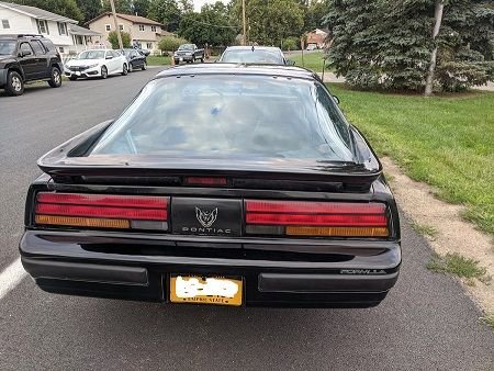

I was talking to a guy on FB and he mentioned the hawks spoiler was a closer repro I wanted to put this out and see what Y'all have noticed if you have either one, I currently been waiting for a OER 3 months and Hawks say that have that much of a delay also - UGH
what have you guys seen, please post up which one you have and your issues fitting and how it compares to OE
Pics were sent by FB guy same car different spolers
Thanks
I believe the picture above is the Hawks spoiler
and this is OER the side spears are "thicker" than the hawks

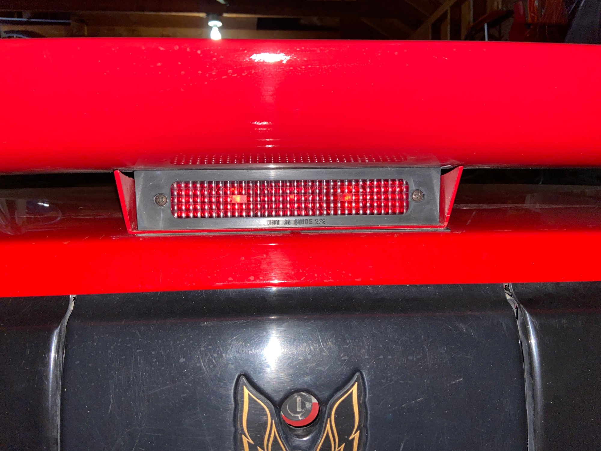

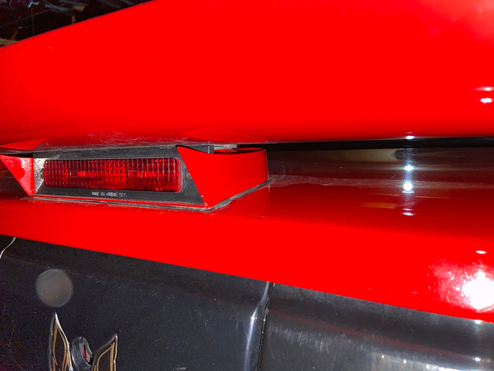

I do, the fit could be better IMO, but I can’t remember how the original fit. Here are some pictures for you to decide.

I have the Hawks wrap around as well. I like it overall. You have to modify the 3rd brake light housing, shave it down on top half. Keep the curve but shave it down. Mine came out fine. If I have 1 complaint its the mounting on the sides They just give you 2 metal clips. It doesnt use the plastic ones form the factory. I may modify mine to use the clips but the ones provided seem to be OK.

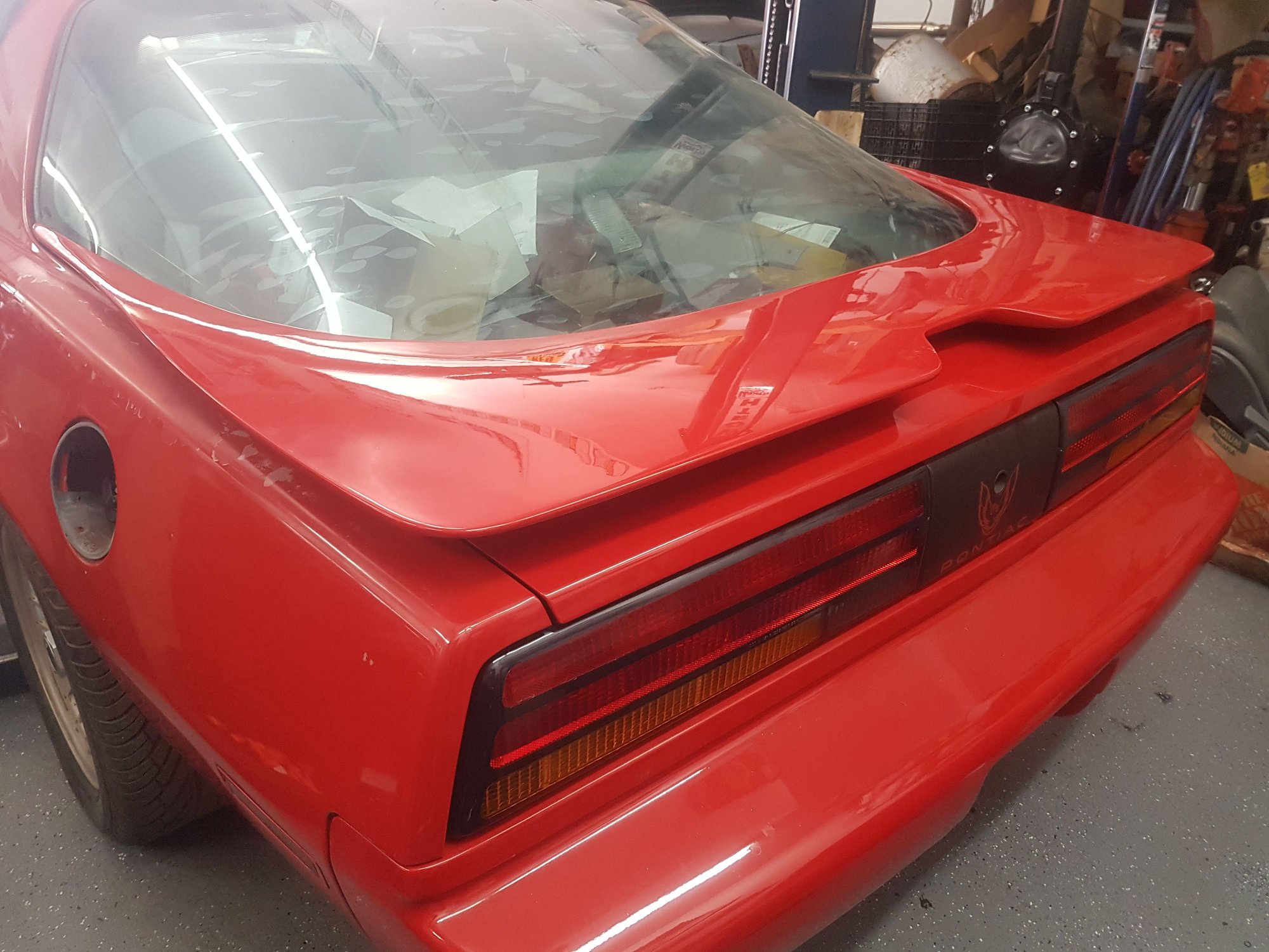

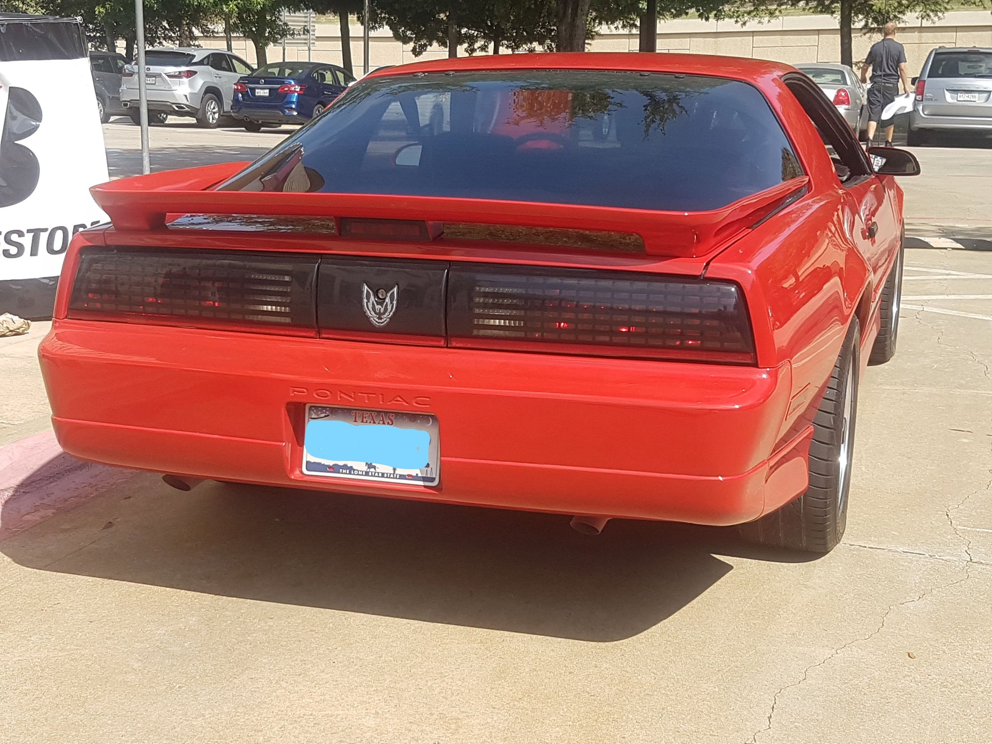

Well thought I would update with pics since its done now
this was the before
and this was after
I am happy with this Hawks spoiler was packed well too
I also got a 91-92 Aero for my 90 and here it is (updated rear bumper too)
I actually swapped trunks from car to car 87 was never sealed when 91-92 lid was put on it but now no longer leaks
