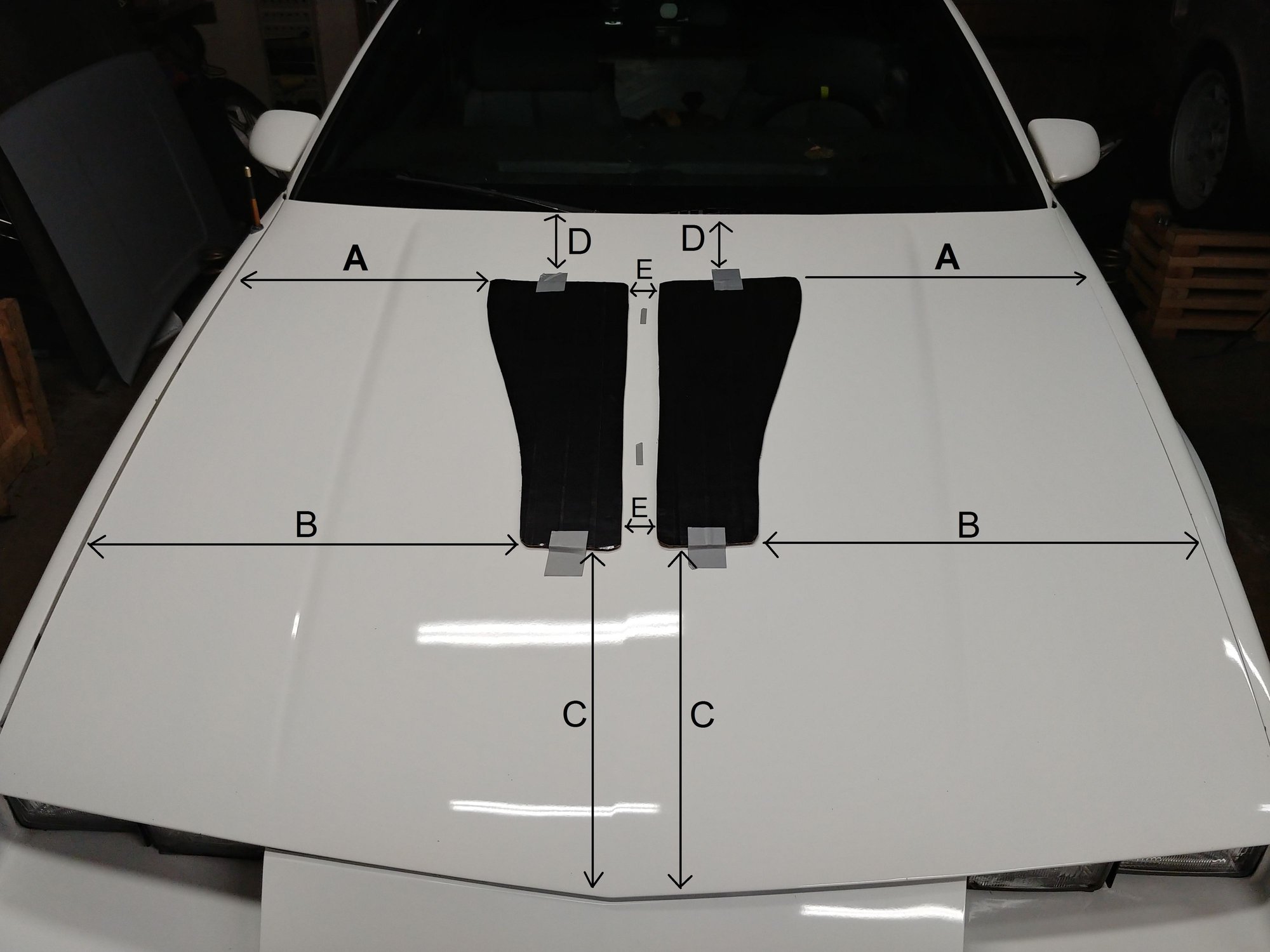

Hey guys, can anyone give me some numbers on where your IROC louvers are positioned on your hood? (PIC related)
I'm installing the TrackSpec louvers on my 92 Flat hood and need some numbers to go off of.
(Yes others have done the cutting on a flat RS hood, and it fits)
I don't want to mess up a good painted hood for obvious reasons.

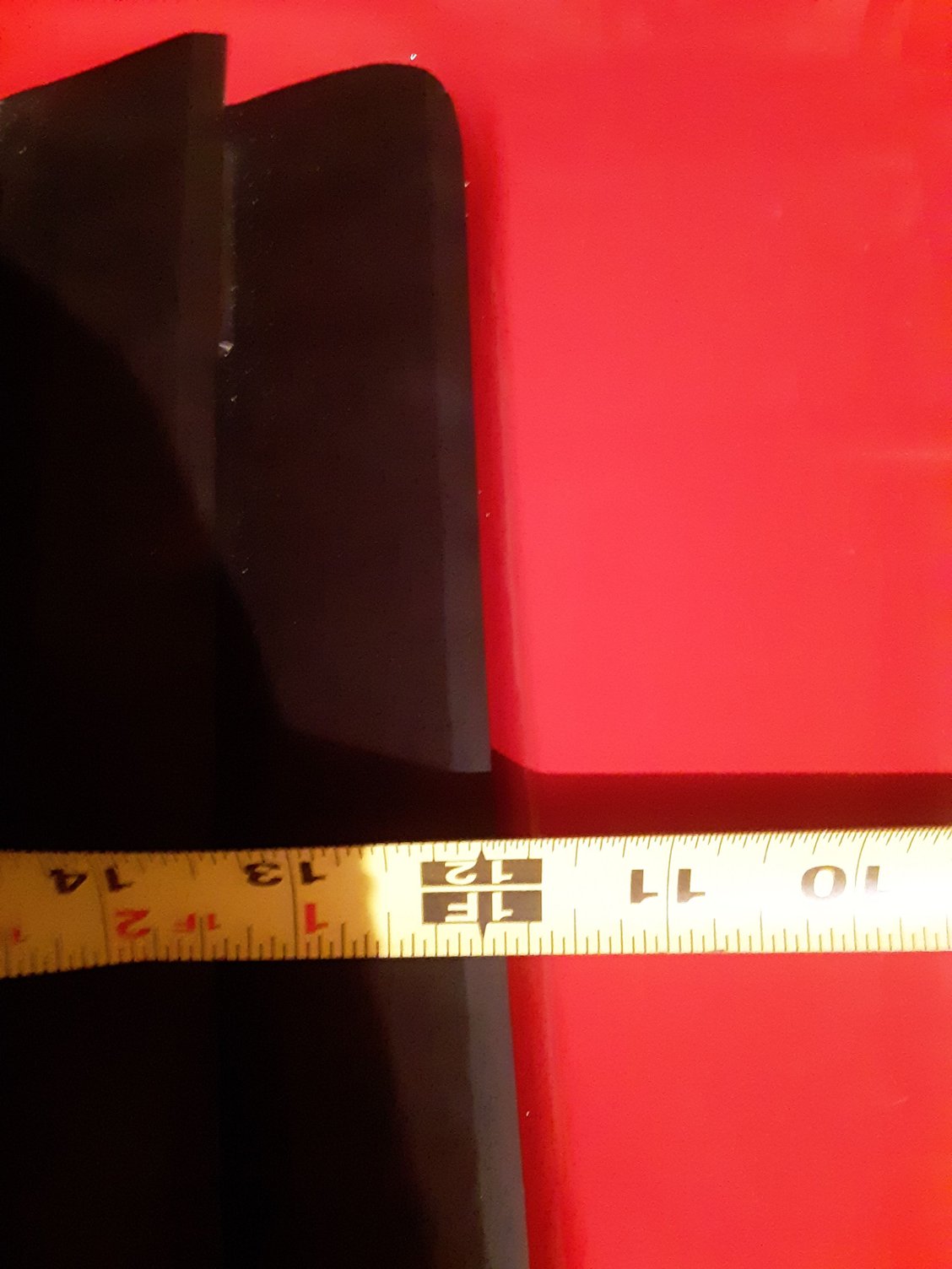

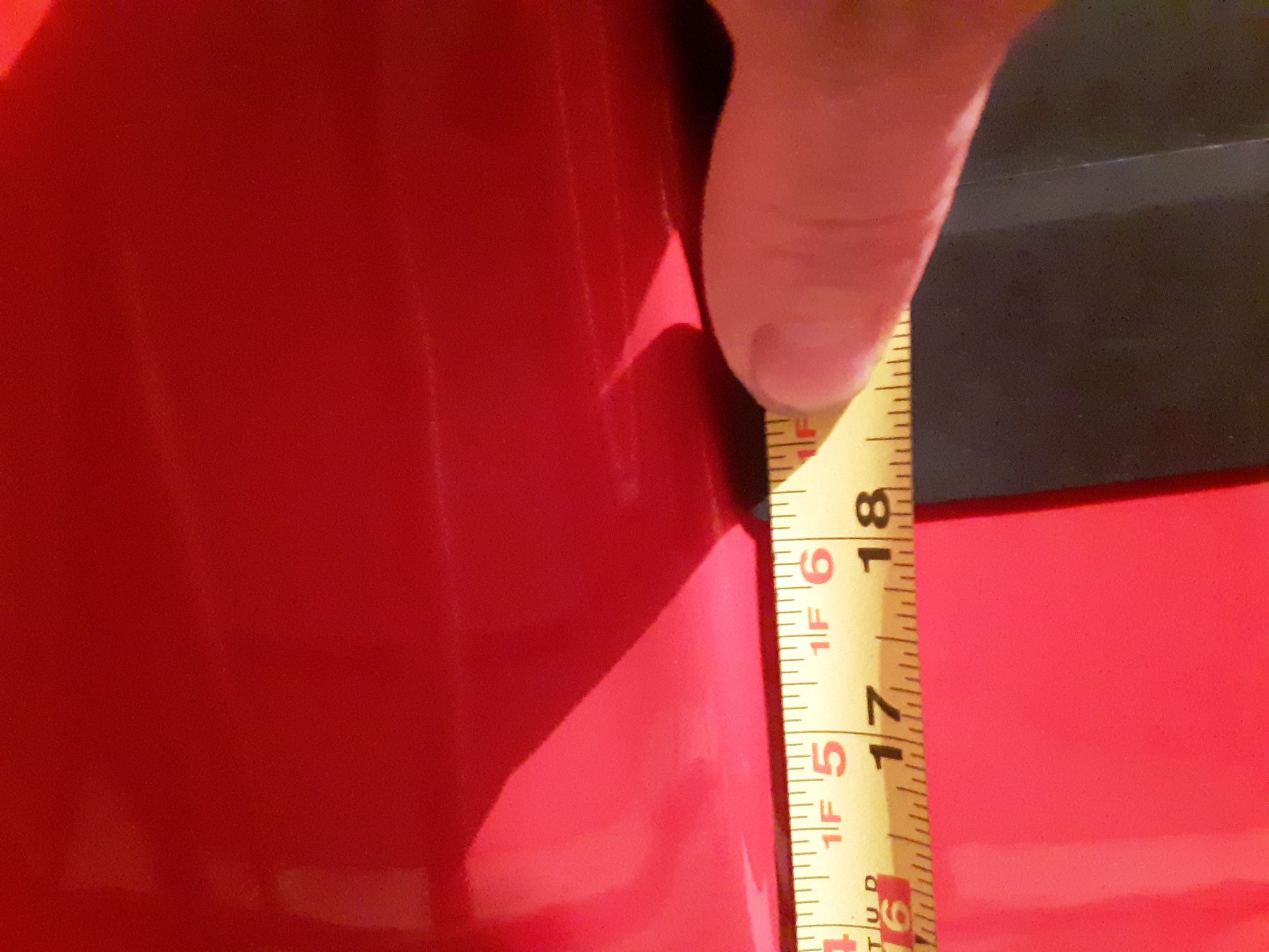

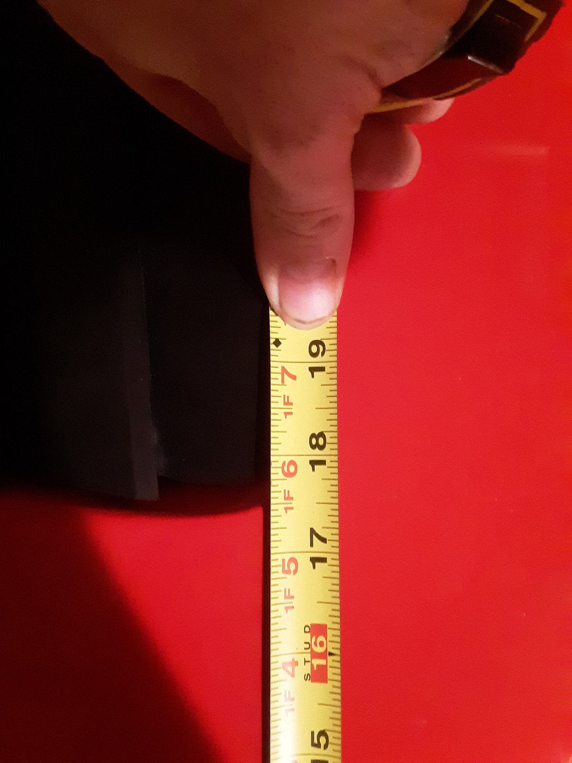

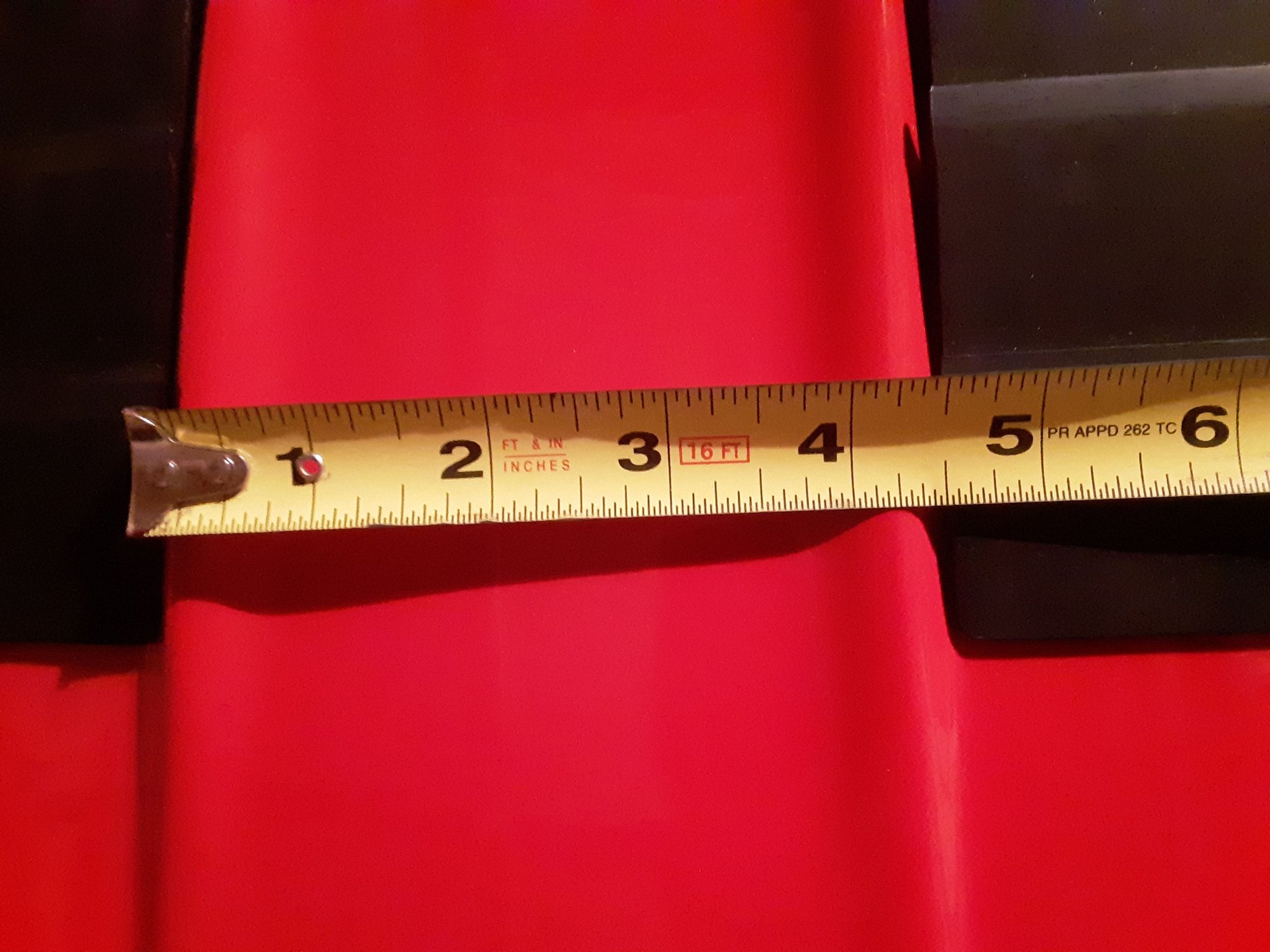

Old Dec 2, 2020 | 12:10 AM
dagwood's Avatar
Top Answer: 1
Posts: 2,678
Likes: 1,267
From: In the paint booth!
Car: 1986 Camaro Drag Car
Engine: 383 on Ethanol
Transmission: Automatic
Re: IROC louvers on RS Hood (Measurements)
Here ya go!
A
B
C
D
E
Old Dec 2, 2020 | 01:11 AM
McLovin1181's Avatar
Joined: Jan 2014
Posts: 387
Likes: 143
Much appreciated.
thx man.
