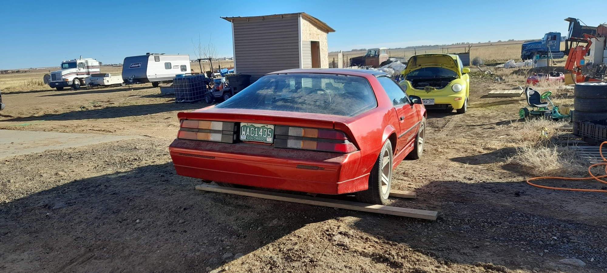

Your wheels are not the right ones. In 88, there were no color combos with grey interior and gold wheels. Those are the 85-87 style. The taillights are not right, either. The IROC-Z decals should be at the rear of the doors on an 88. So some things have definitely been changed around a bit. Looks like it has some good bones, though, and definitely worth making right...especially with 40k miles

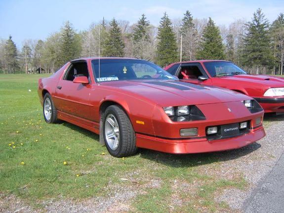

I'll bet your car was the red metallic (which has a copper looking pearl) with red/black stripes, red emblems, and grey wheels. Like my old car, here.....

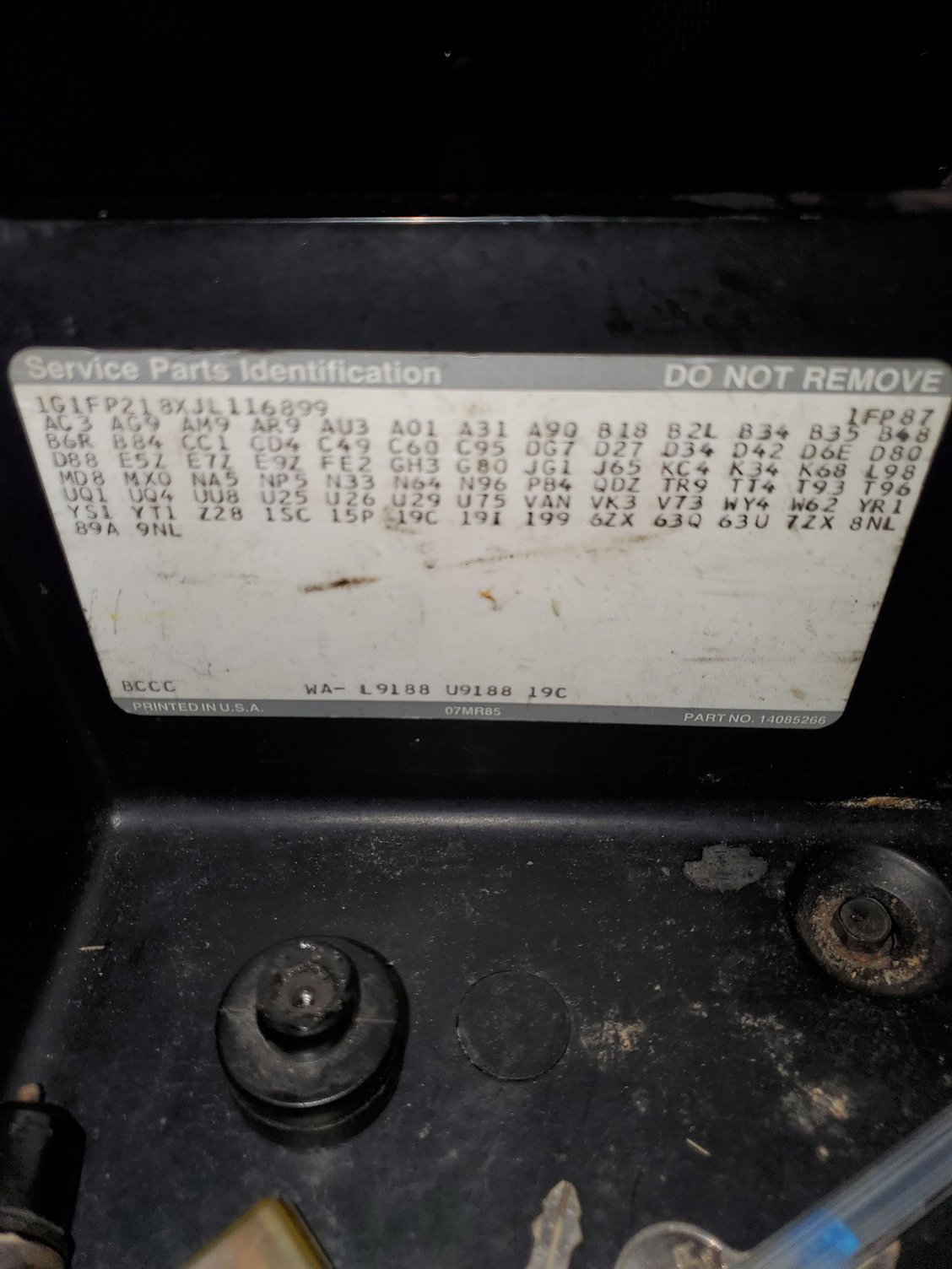

Thanks for the info brotha I really appreciate it Im learning allot here. I decoded the VIN also, come out of the Van Nuys plant in CA. And its the L98/B2L option(whatever that means). Here's the SPID tag, what can you tell me from this??

WA9188 is the paint code for Medium Orange. 89A is the code for red/black stripes. So your car would have looked identical to my old car, other than the orange paint.
Grey interior, grey wheels, red/black stripe, red emblems, and red IROC-Z decals on the doors

Here's a twin to how your car would have looked when new...

L98 is the TPI 350 engine. You also have GH3 2.77 rear end gears, Borg Warner 9 bolt rear, G80 posi, J65 4 wheel disc brakes, UQ4 Bose radio, and a KC4 oil cooler. You can tell a LOT from those codes

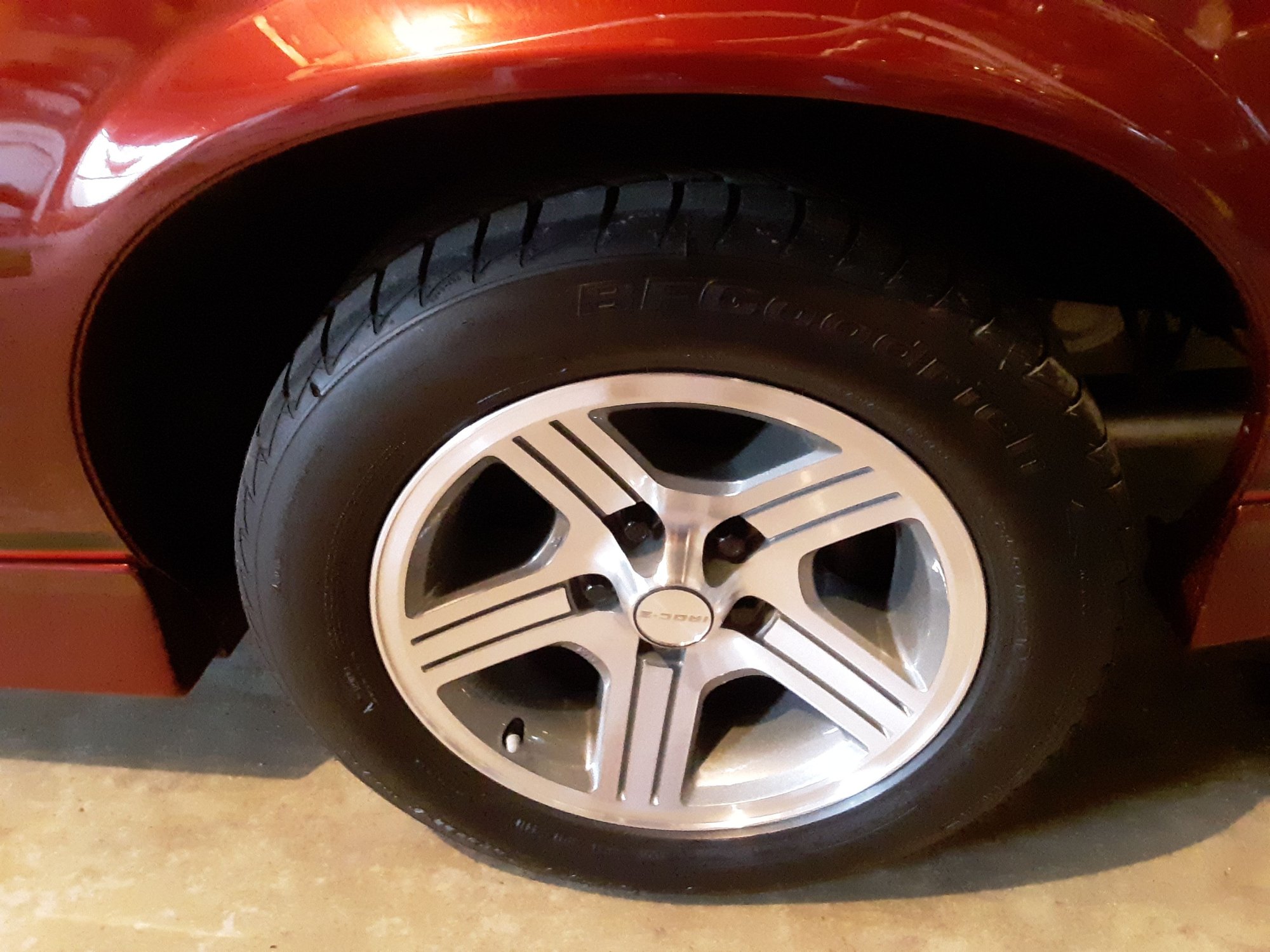

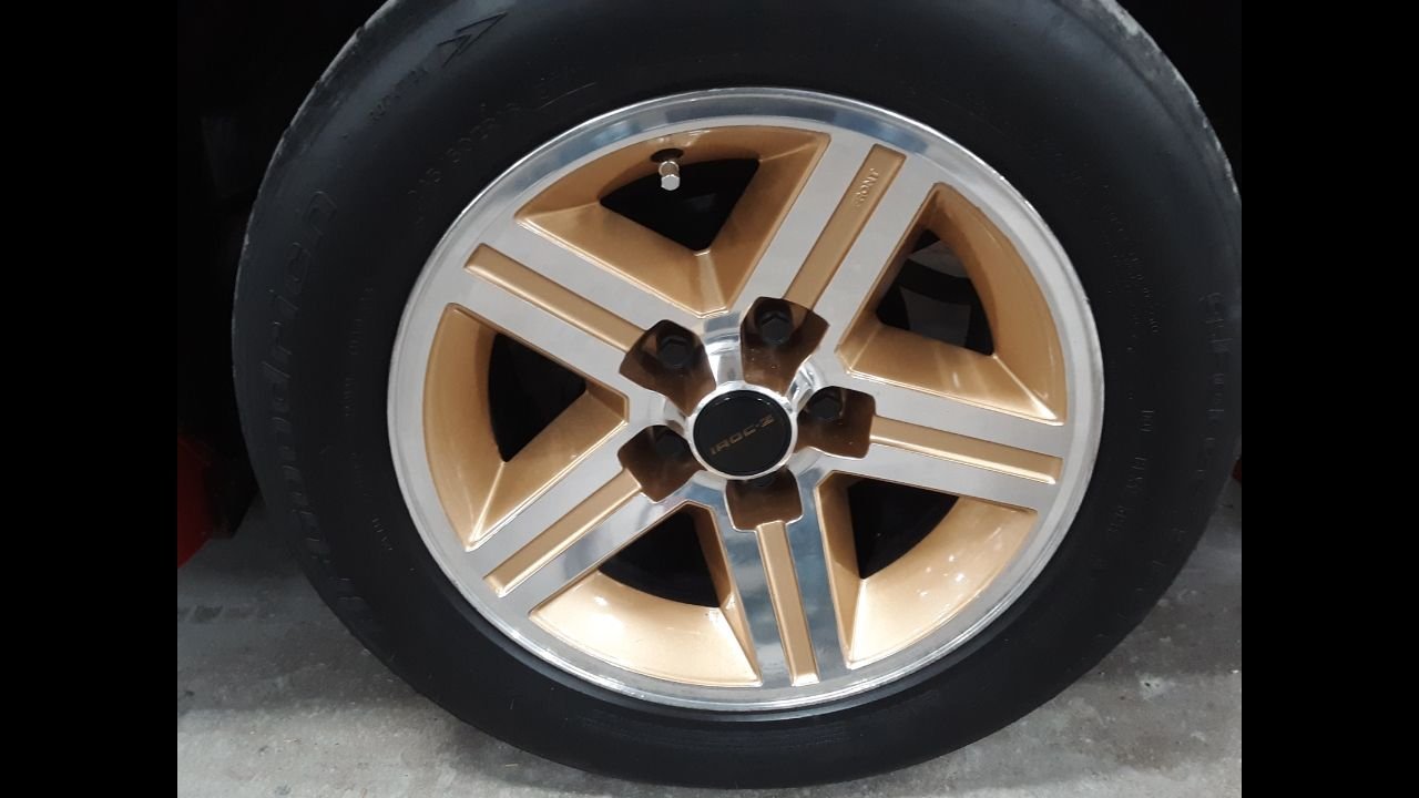

You have the 85-87 style wheels. 1 thick line in the spokes
You need the 88-90 style wheels, with 2 small lines in the spokes, and grey colored.
1st pic is like yours, and the 2nd pic is what you need

Also, your taillights should look like this...
Also, if you're looking for the right wheels....they actually made the 88-90 style in 15" AND 16". You need the 16" wheels, so be careful not to buy the 15's

Here is a better pic of what your car looked like when it was new
