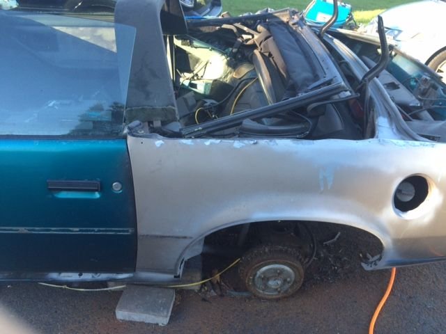

Are you looking for this?

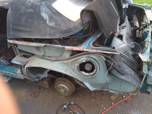

Almost, but man convertibles are completely different as far as the inner structure. On mine there is an inner brace on the sail panel kinda behind the rear side speakers. It's kinda in the way a bit on this rusty wheel arch I'm trying to fix.
Thanks tho
Dave

You are correct that 'Verts are different in structure...they have to be for strength. But I don't think full quarters are available anywhere, regardless...so you are installing a skin (from the beltline down) anyway, so the repair is similar...other than being VERY careful not to warp the metal at the sail splice.
