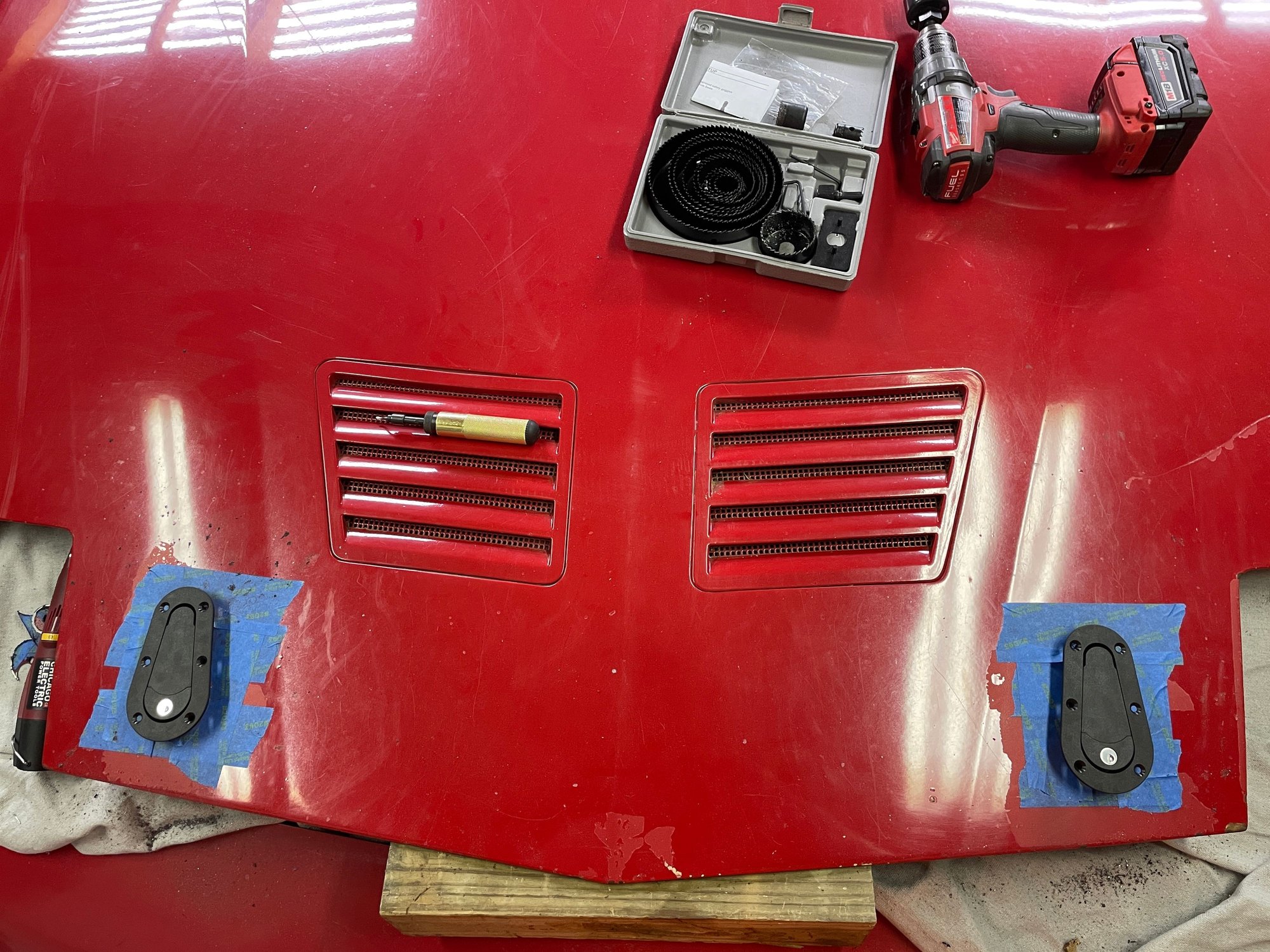

I decided to use the Aerocatch hood pins on my factory steel Firebird hood for a couple reasons. One) my factory hood latch tended to be a little on the finicky side, working most times but sometimes not. I’ve done a lot of rewiring in the engine compartment, though I’m confident in my wiring skills there always a concern with fire, it maybe an irrational fear but you never know. Two) I really like the aesthetic of these hood pins.
I used blue painters tape to mark where to cut and when I pulled the tape off, off came the 30 year old clear coat, the cars gonna be painted in the spring so I’m not to upset about it, maybe I left the tape on for to long 🤷🏼‍♂️.
The worst part really was determining the location of the pins, the usual hood pin location put the latches to close to the edge of the hood above the headlight covers.
After a lot of measuring to ensure the latches are symmetrical on both sides the holes are cut with hole saws and a cutoff wheel
