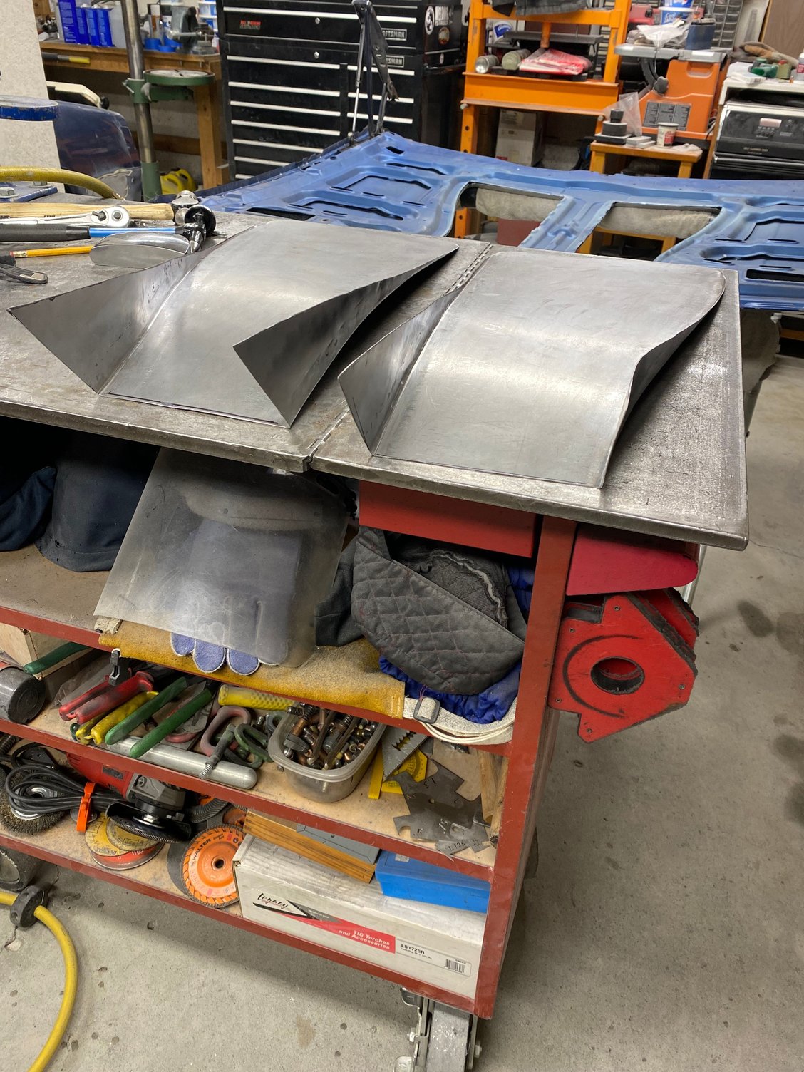

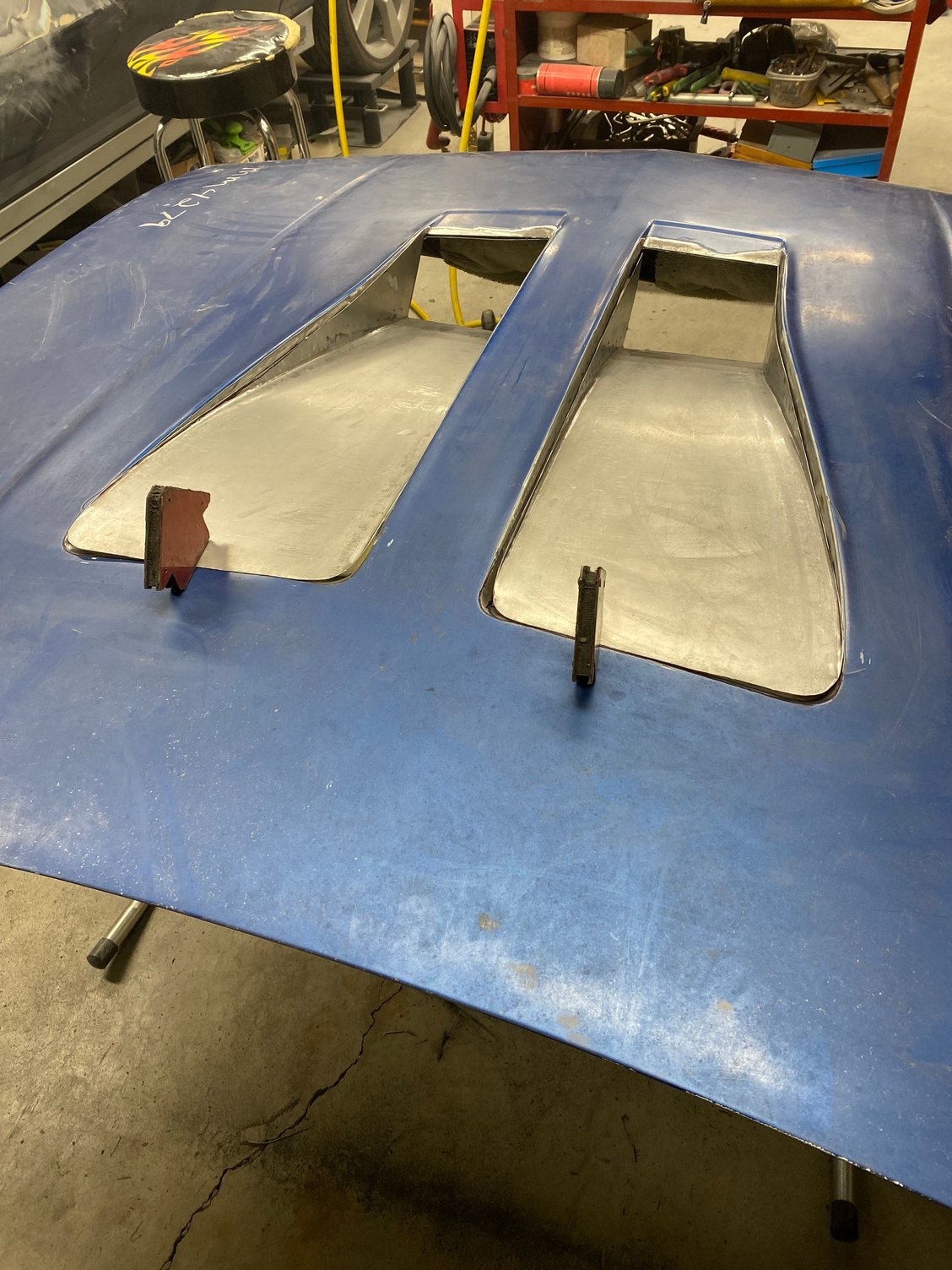

I wanted something extraordinary and unique for my build, so I came up with this.
Bead rolled and shirking the pans
Added extensions to the sides

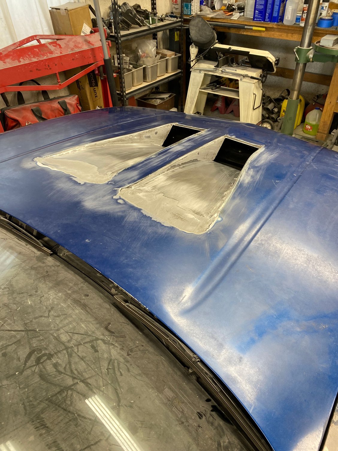

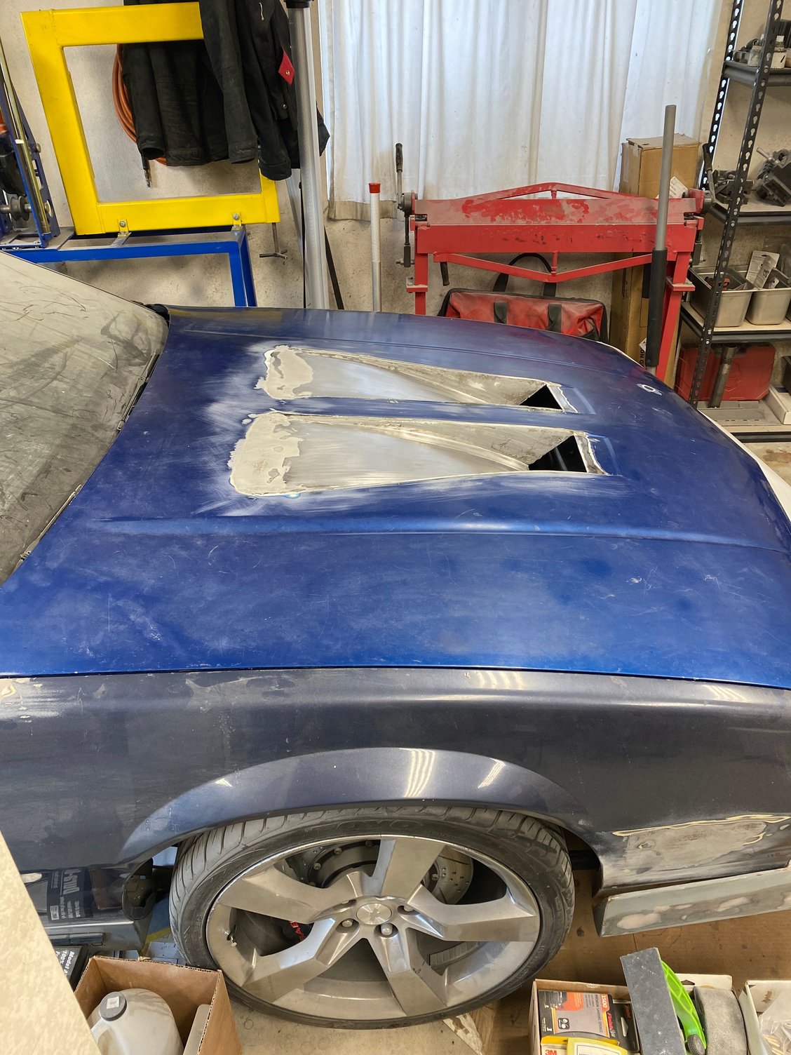

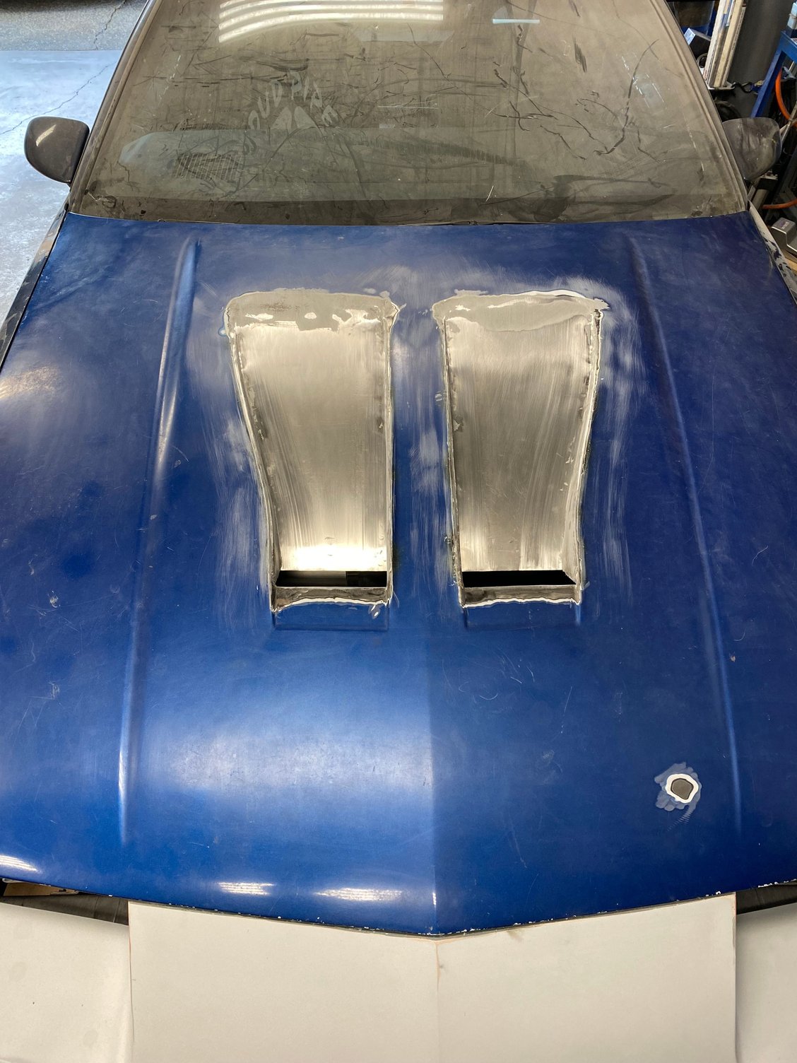

Fitting and preparing for welding
After about 12 hours of tig welding
It is now ready for primer and block sanding

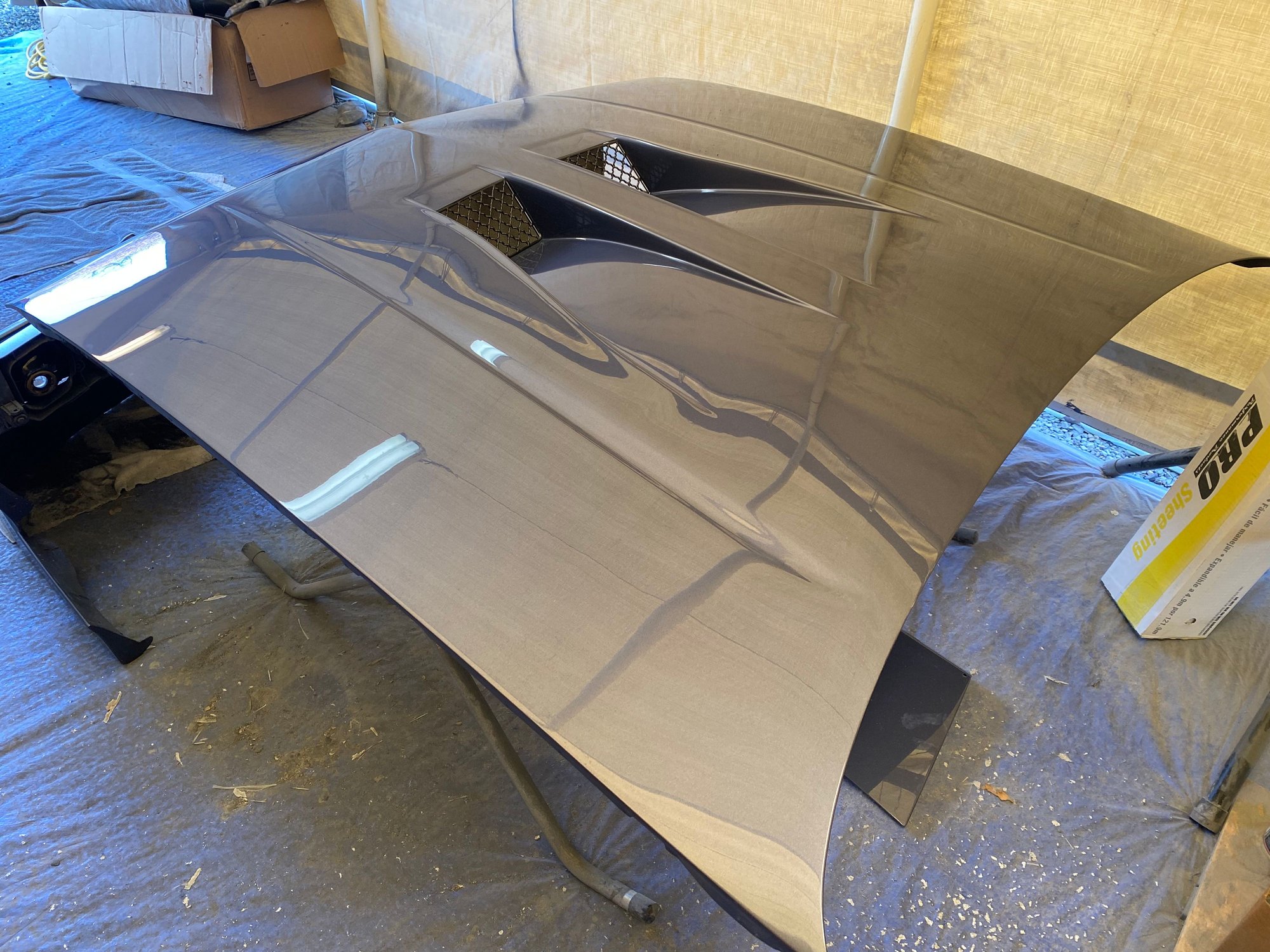

A successful test fit, it’s as if it was made for the car.
I’m very happy with how well it fits

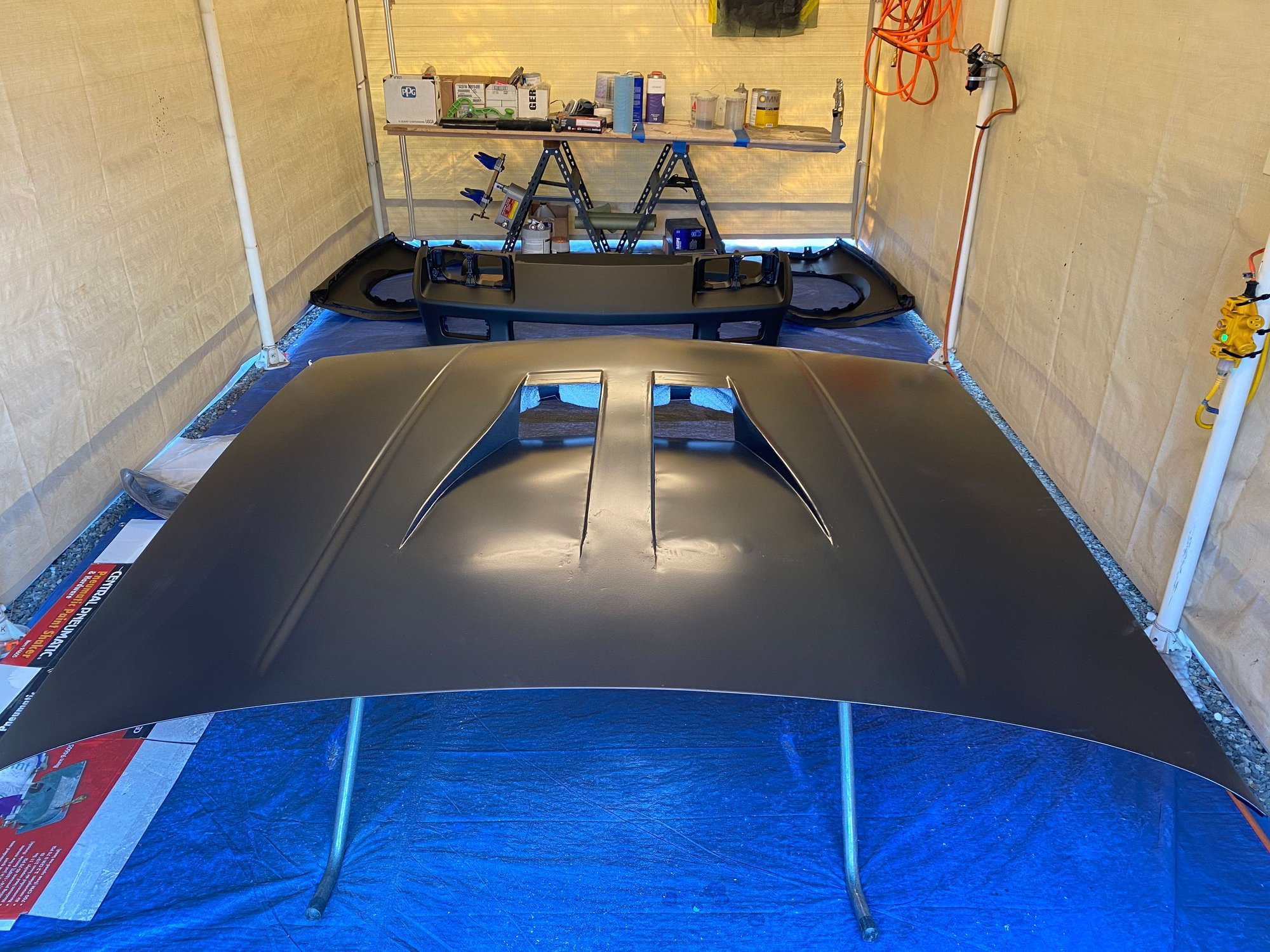

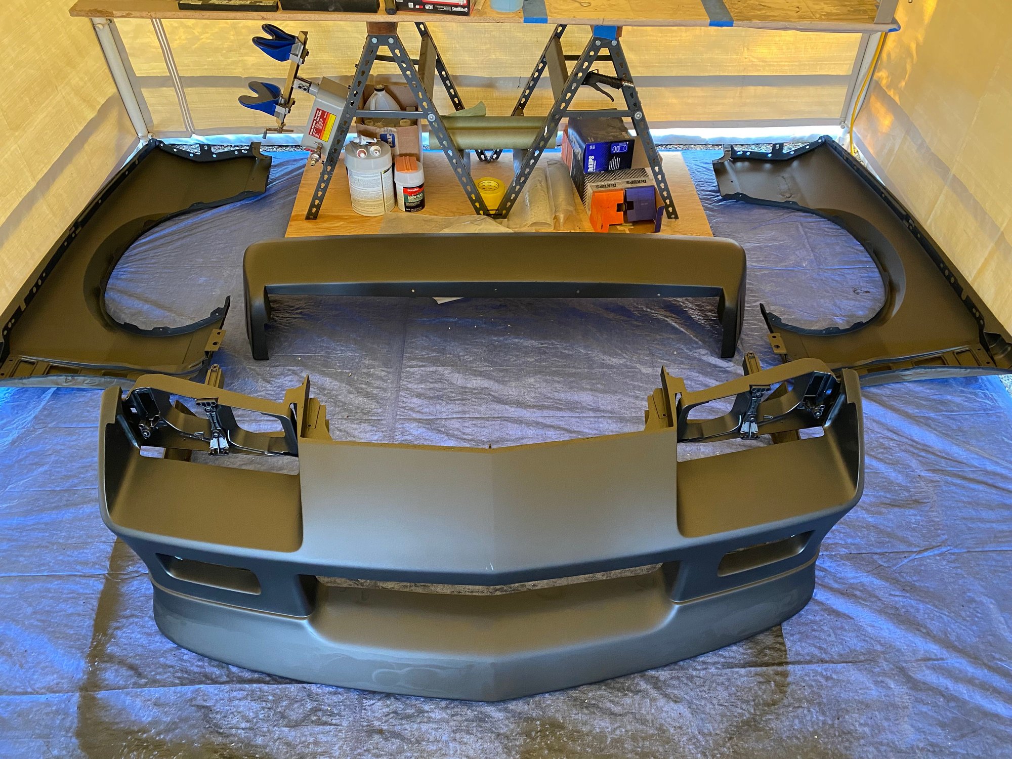

I’ve gotten a few things in epoxy primer

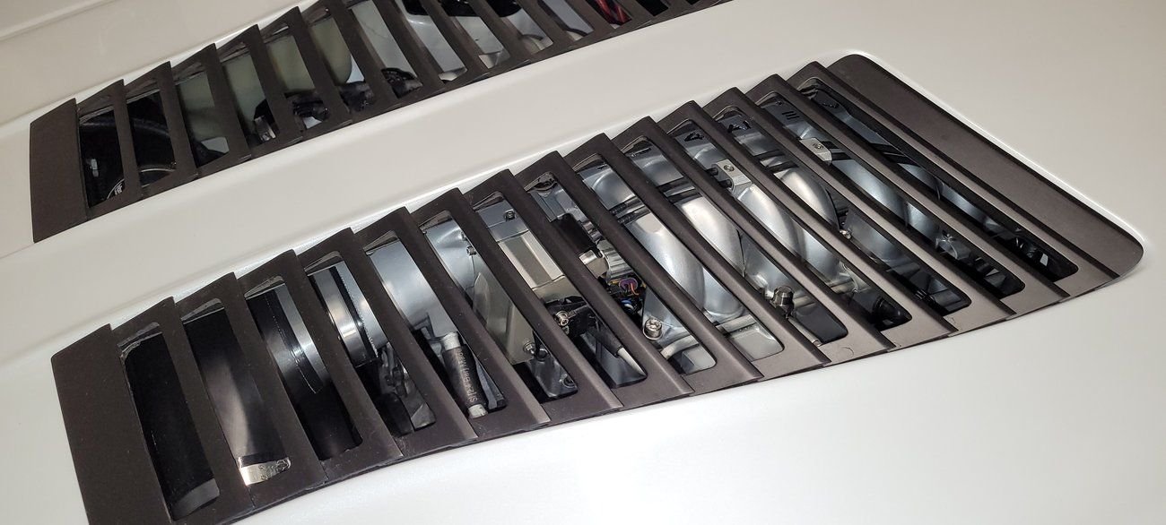

No! I could have put TrackSpec grills on this like everyone else has done and it would have been a lot easier. As far as opening up the IROC inserts, it’s been done by a good friend of mine and we will be side by side at some shows in the future.
BajaDaze IROC hood
I have made matching grill inserts for the front bumper and the hood to complete the look.
Matching stainless steel grills
The final product will be unique look for a one of a kind build.

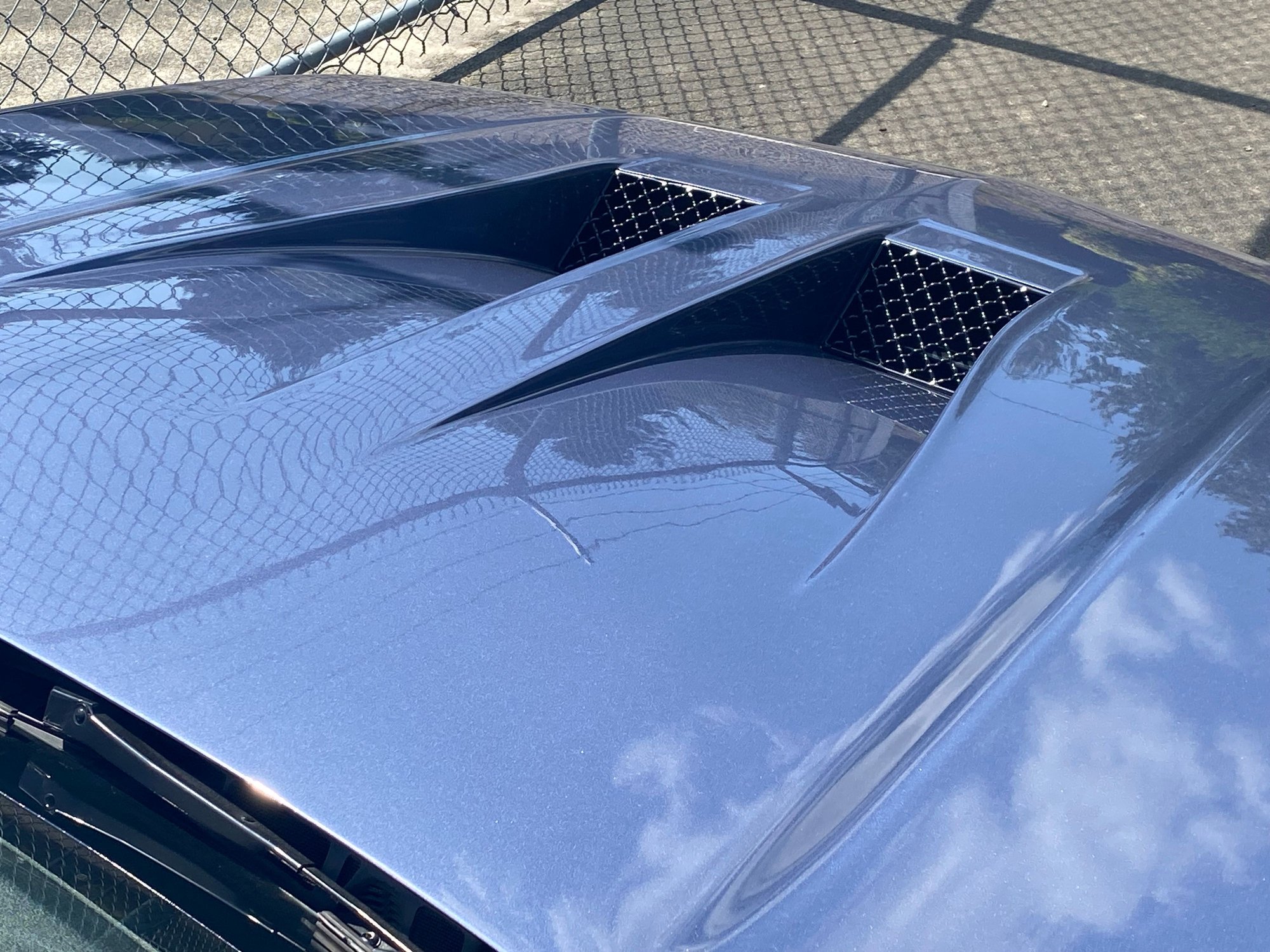

Final update to this thread. The grills have been installed and the hood is ready to be installed on the car.

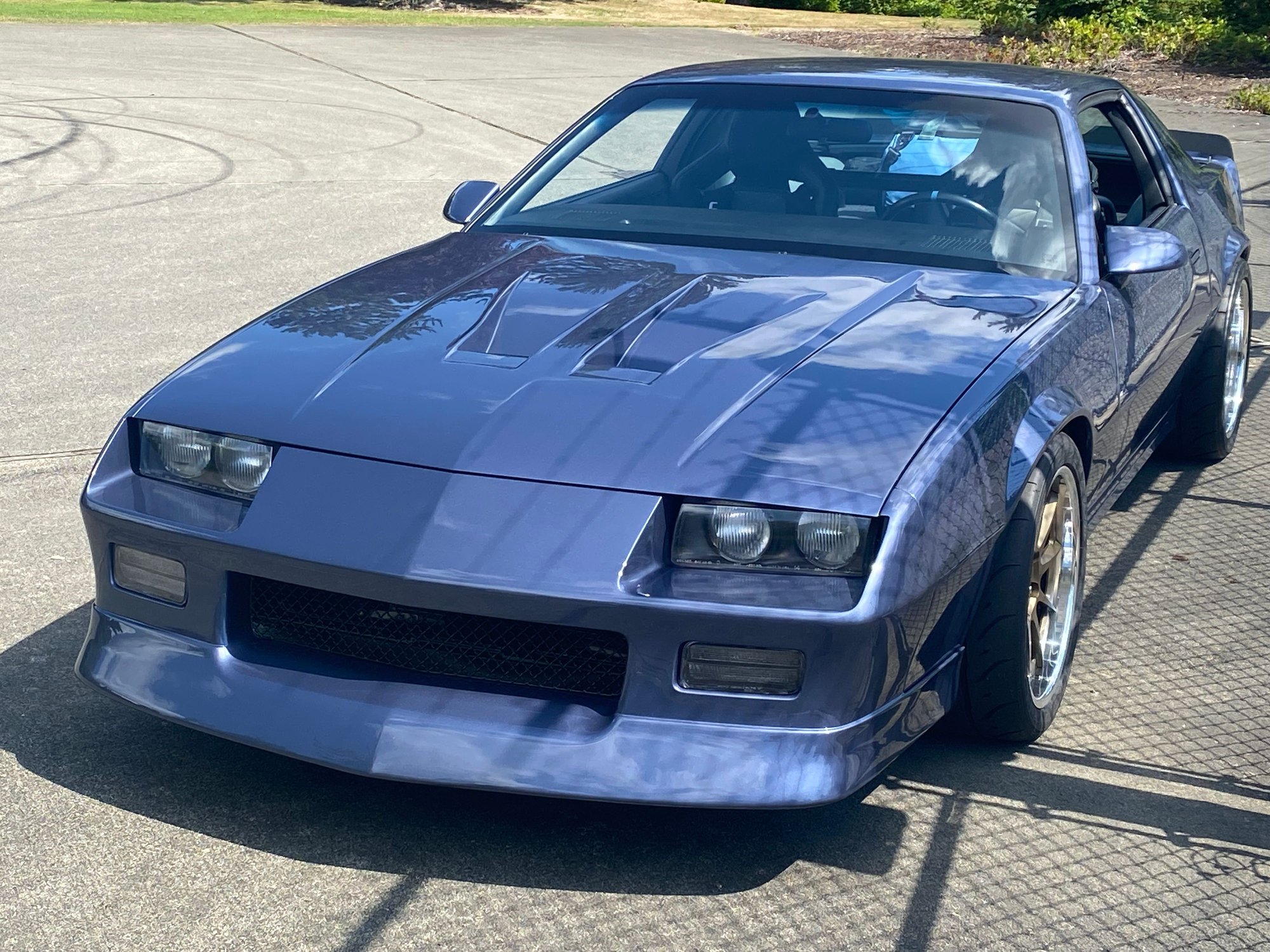

Here is a POV of the grills from the drivers seat.

A couple of pictures with the hood on the car

Re: IROC extractor hood
Fantastic!
Great job. These turned out phenominal.
