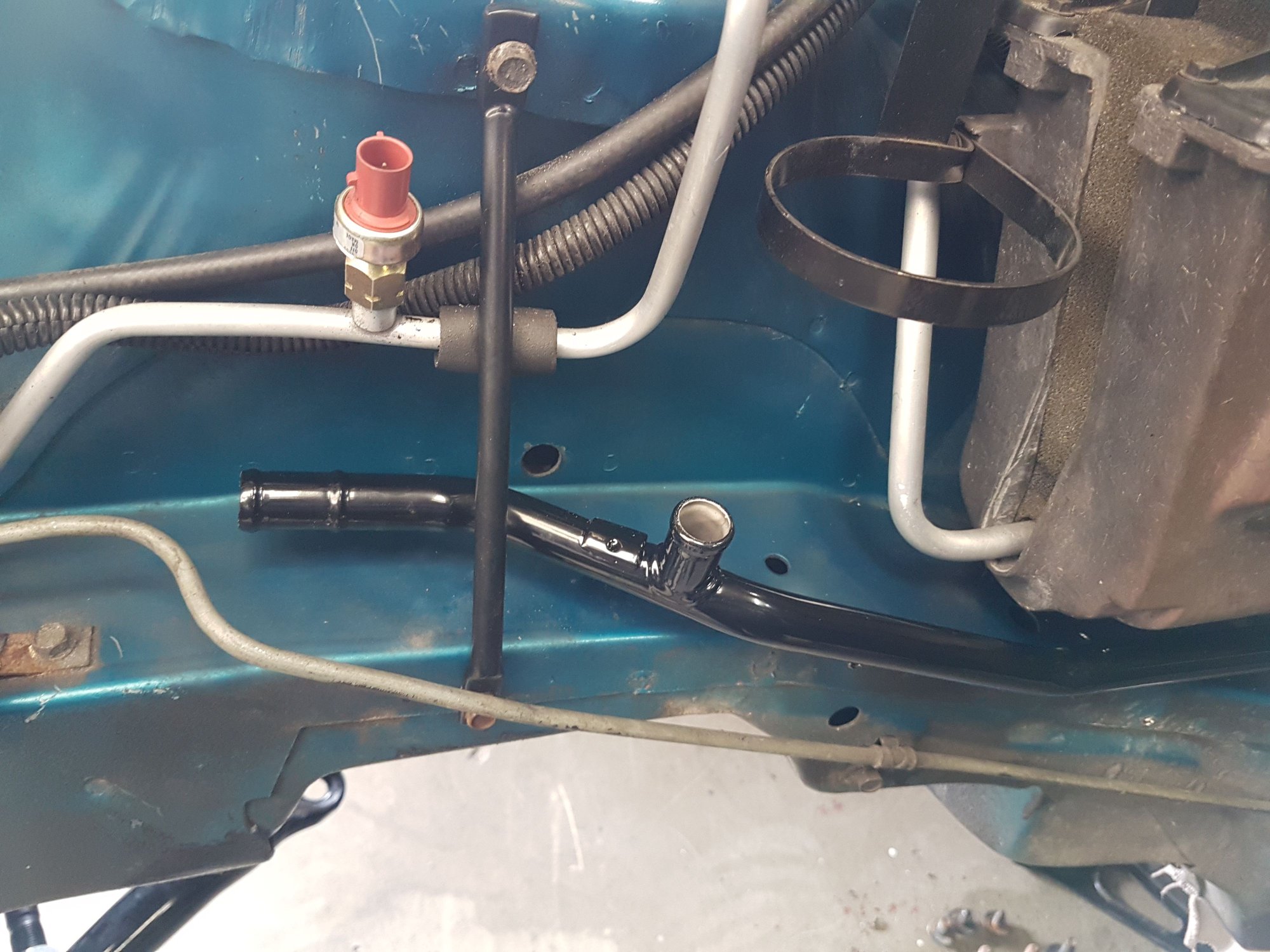

I know for sure that 90-92 firebird with 305 TPI and 350 TPI got both braces as well. Here are two pics of my 92 with 305 TPI.

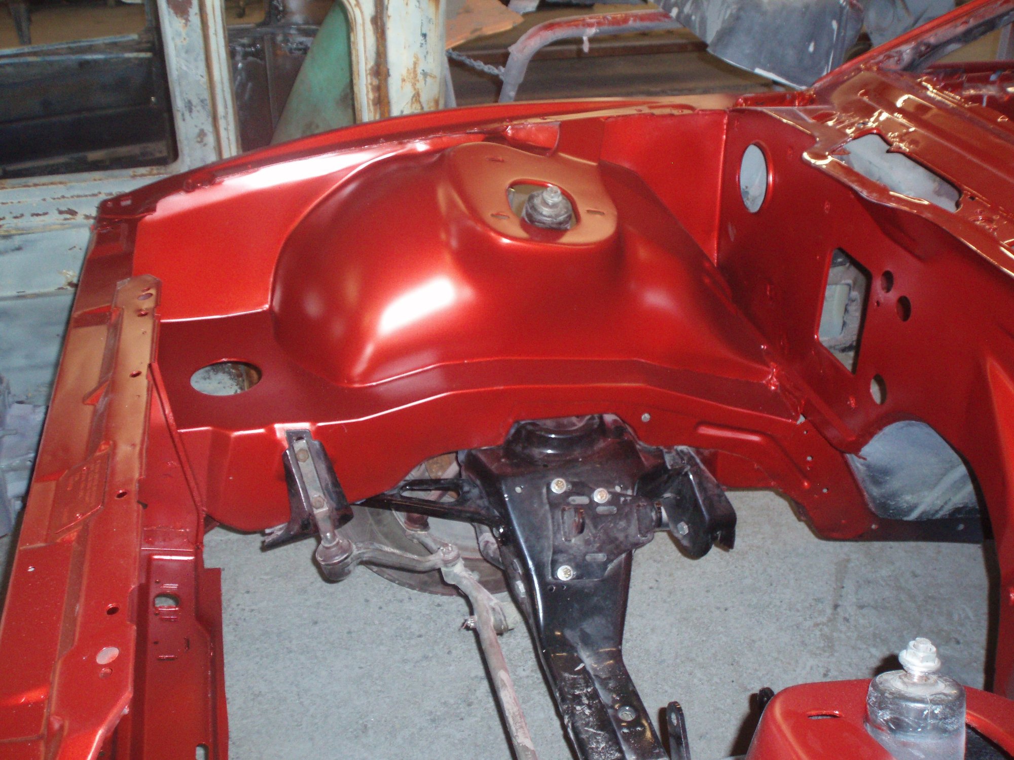

My theory on this brace (or at least the one at the top of the fender) is that it provide some needed support because the PS wheelwell doesn't make as much contact with the firewall as the DS. Check out the pics below of my '84 TA. The DS wheelwell kind of dies into the firewall providing some support almost halfway up the firewall. In the PS photo you can see the back of the wheelwell doesn't die into the firewall like the DS. The bottom edge meets up at the very bottom of the firewall. This whole PS area isn't as structurally sound as the DS.
