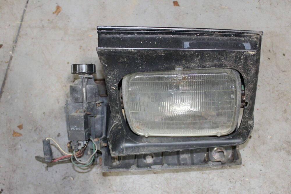

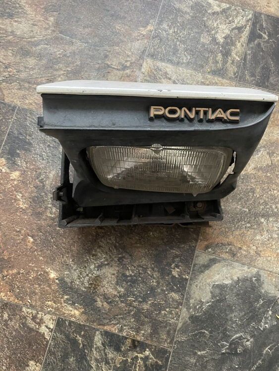

I think the side profile is be different. This may not mattrr
if you’re installing ground effects though. You’ll also need new headlight buckets. The 82-84 are more square and the later years are more curved.
Early design:
Later design:

The headlight bezels of thje 82-84 will also be different / not fit the 88 cover
