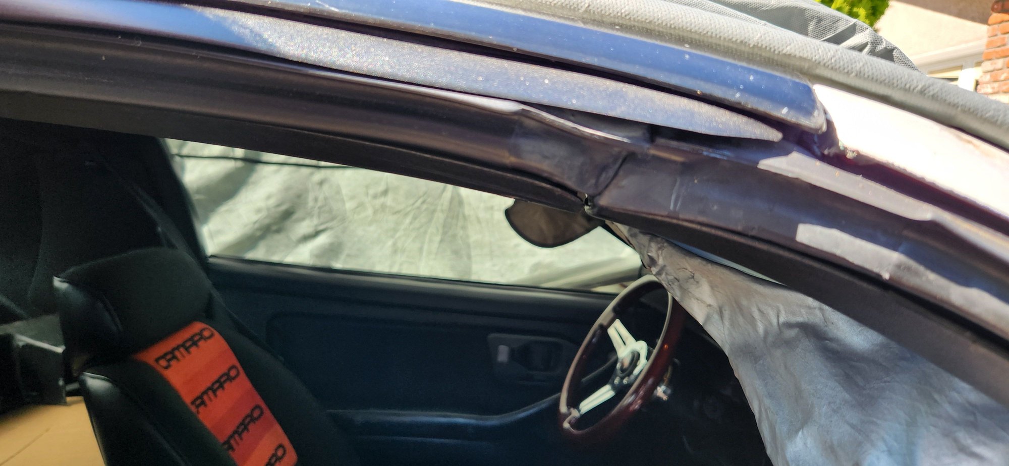

Look like this?
I really hate to start a thread like this. There's so many variables.
​​​This is at the front edge/T-top area of drivers side. This and passenger side look pretty much the same. They both leak. I've been messing with this for days and can't get it to stop.
I put all new weatherstripping on doors and T-tops. I've had 2 body shops and a restoration shop look at it. No luck.
Anyone have a picture of the window open and closed of their Fairchild weatherstripping that doesn't leak?

Did it look like mine when installed, with that flat area about 1/2" long where they meet? The glass pushes against that and makes a gap to the left.
I hope it eventually forms to the glass more. I've tried a heat gun, but I don't think its moving.
