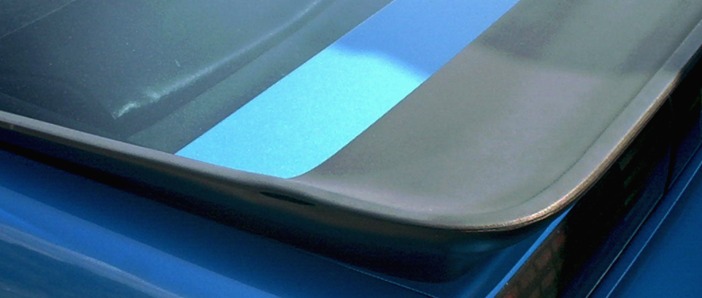

The only thing you might consider is if you have the buldges on the spears. If the spears are not straight, then its starting to go bad, and its only time before you start to get splits.
What is happening is inside the spears on the spoiler they used steel for the clips to clip into. As the steel rusts, it expands, and eventually it will split in those spots.

For example,,this one is dead,,sad but true !!

well then mine is dead. it has some cracks in it, anbody ordered the fiberglass ones instead of rubber?
