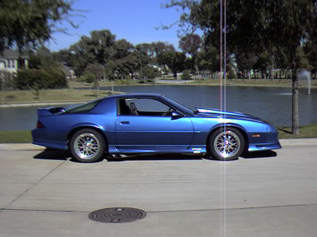

I have a true dual 3" exhaust that exits in front of the rear tires and I had thought of running them through the gfx, but I have a power seat on the drivers side so the floor pan is lower and it wouldn't work. If you got oval tubing, you could probably do it, but quite expensive. I got my system done for $300.. this pic is old so you can't see it but road clearance is an issue

Here is one you cant see it that good thoe
Attached Thumbnails side exhaust question.....wrong board??? yeh right!!-view.jpg
