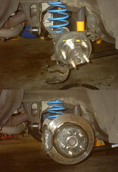

I have posted info in the past about the Wilwood LS1 rear brake kit. It is vetually identical in the fact it has an internal drum parking brake assembly and it bolts directly to a 3rd or 4th gen rear disc brake 10-bolt housing. That info is under "Billyboy". I have had so many *** damn names its hard to keep this crap straight. LS1 4th Fronts wilwood retro check out under "Vsixtoy"
Attached Thumbnails LS1 on 10 bolt disc-c-documents-settings-office

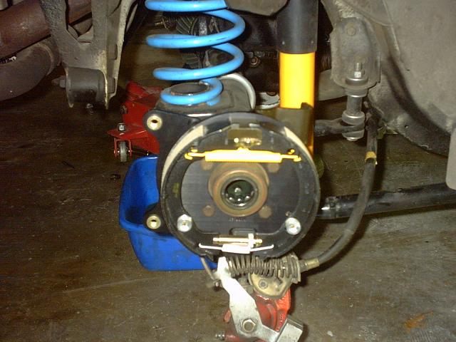

Finished rear LS1 Wilwwods- basically ame as LS! factory except for the fixed mount position 4pot calipers, factory has floating mount single piston calipers
