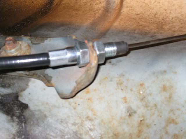

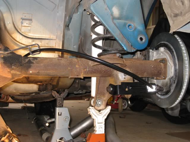

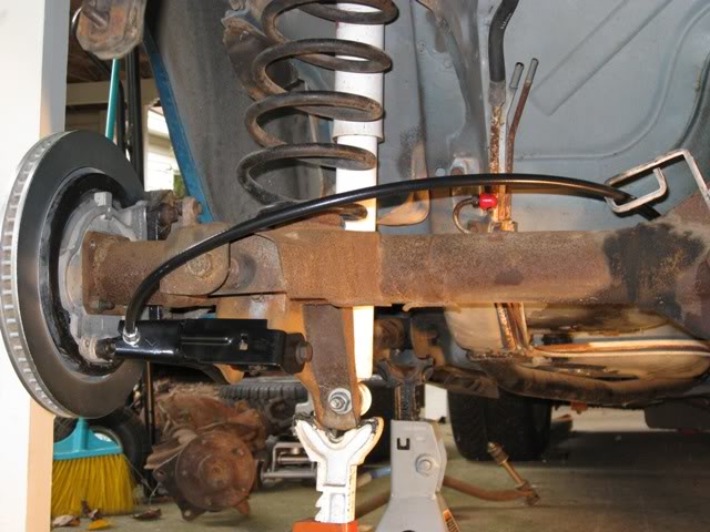

I just had these cables made for the LS1 rear conversions. They have the correct cable ends that are properly crimped and will hold. The cables are custom fit for 3rd gens and even have some adjustability in the trans tunnel where the '90-92 cars do not. Pictures of the install:
Cable set:
Installed on both left and right sides using the stock cable guides and LS1 LCA mounted cable retainers. This is a 4th gen rear BTW:

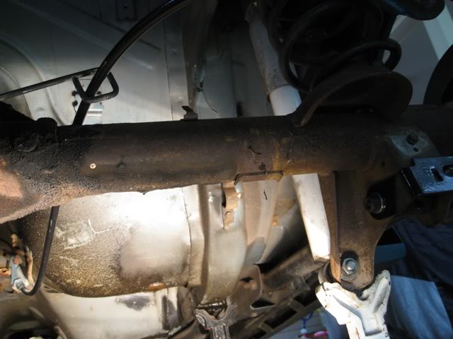

Routed up and over the axle just as factory:
More to come..

I opted for an adjustable threaded cable end to give just a bit of tuning once the cables are installed. I know a few guys with '90-92 cars need to have a bit of adjustability where GM didn't give any with the trans tunnel cable as they did in the earlier years:

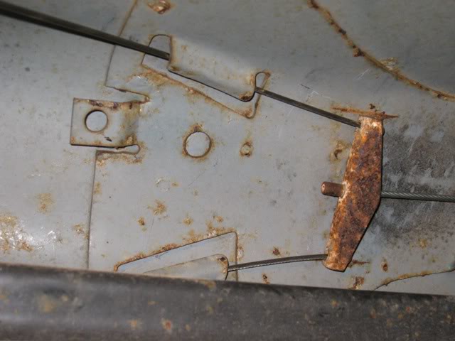

The cables have the correct 3/8" plug style cable ends that our cars use, as you guys know the 4th gen cable ends are different and the cables are much shorter:
Install the cable ends in the equalizer bar and push the cables up and into the steel cable guides in the trans tunnel:
All set, correct no hassle cables for the LS1 rear discs:
Good luck whichever way you decide to go.
