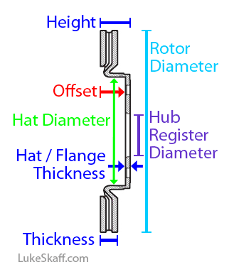

Perhaps you can find a similar disk from one of the circle track companies like Coleman. What is the thickness and mounting style of your rotors?

Is this a 1 or 2 pc rotor? If its 2 pc, measue the diameter thickness and hat bolt pattern and order the friction rings from.where ever. If its a 1pc, I really doubt baer makes their own rotors and they may be c4 vette parts

Ah, I assumed a two piece. So take some measurements and I'm sure we can figure it out.
Diameter?
Friction disc thickness?
Total height?
C4 rotors are only 0.81" thick. I doubt Baer uses those. And C4HD rotors are 13" diameter.

I assume you have Baer's track kit? They use the C4HD rotors turned down to 12in. I used to run that kit, it was kind of a pain finding someone to turn the rotors down every time.
Depending on what wheels you run you could get different brackets and run them at the full 13in.

I have a few sets of C4 HD rotors laying around. Why don't you measure you rotor thickness and total height. Then we'll be able to tell for sure.
