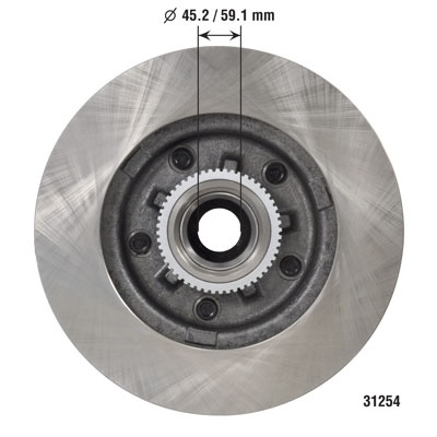

Originally Posted by iansane
Thread crap much? I don't see how any of what you posted in relevant in this thread. The guy has access to have tone wheels made and is asking if anyone else wants in. Seems easy enough to ignore if you don't want the wheels. Besides, if you had matching wheel counts front and rear you could theoretically put any square wave ABS system behind them. You wouldn't be restricted to a 4thgen version.
I'd love the wheels but I couldn't kick out 250 right now.
i apoligize to OP then.. after reading my post it does sound alittle hasty and alittle ignorance on my part
you are also correct as it does seem easier to ignore and what i posted is kinda not revalant last post...... i was just saying a skilled driver can out perform some abs system on the track....... and vice versa..... dual purpose cars can benifit from ABS on the streets theres no denying that.... i am and still is, interested in ABS, thats why i posted
but after reading other post OP made on diffrent threads had to ask the questions why ?
which why i said i have to see this !
which leads me to the question most people would like to upgrade to LS1 Brakes but any brake upgrade you need to machine the hub
Why couldnt you just machine down S10 Rotors with the Reluctor already included in hub to use in a Big Brake Upgrade,and add dust shield that has sensor built in and go from there ?
i dont know the count diffrence on the two diffirent reluctors havent research im sure its different hence why you need different reluctor only issue is rear sensor
but making a custom front for hub sounds sweet so either way you would need something custom

IIRC, s10 rotors are 52 tooth.
