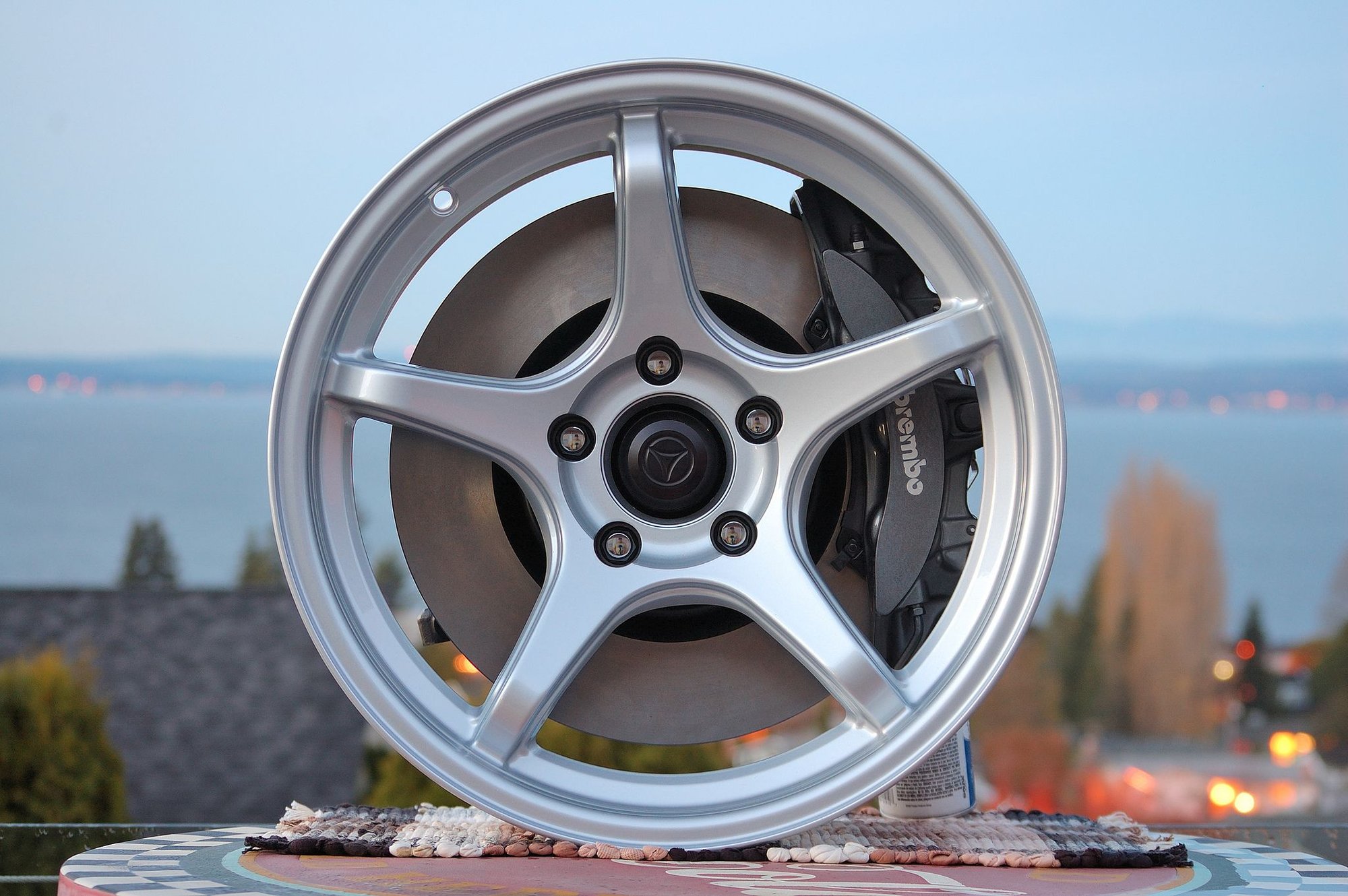

Originally Posted by hotrodln
Well i gave up looking and bought a pair of new Baer rotors...they are just like a 96 corvette rotor, but they are 1.1 inch in width...coincidentally i needed to change the rotors on the front of our 2008 CTS . The CTS has the optional bigger brakes....take a look at the rotors on that thing! they make my camaro rotors look small....i wonder if anybody has put these on a third gen?
I'm not so sure about those little baby rotors in your picture, but I'm certain no one has tried the larger CTS-V rotors.

OK the Brembo's win! My original goal was to get the largest rotor and brakes that would still work wth the original rims....so now i have 8 IROC rims...if i went any bigger I'd need to go get new rims....by the way did those brembo rotors work with the stock spindles?
Modified stock spindles and some modification to the caliper itself.
were the spindles modified as Baer does? so that a 96 c4 rotor willl work on it? I'm just hinking about what i'd like to do the next time the rotors go bad...
I will not pretend to know how Baer modifies their spindles. Do you have a picture?
A C4 HD rotor will not work with these calipers for two reasons. The pad height is taller than the friction surface of the rotor. And the rotor is simply much too small. There will be no way to make a strong caliper bracket with this configuration.
