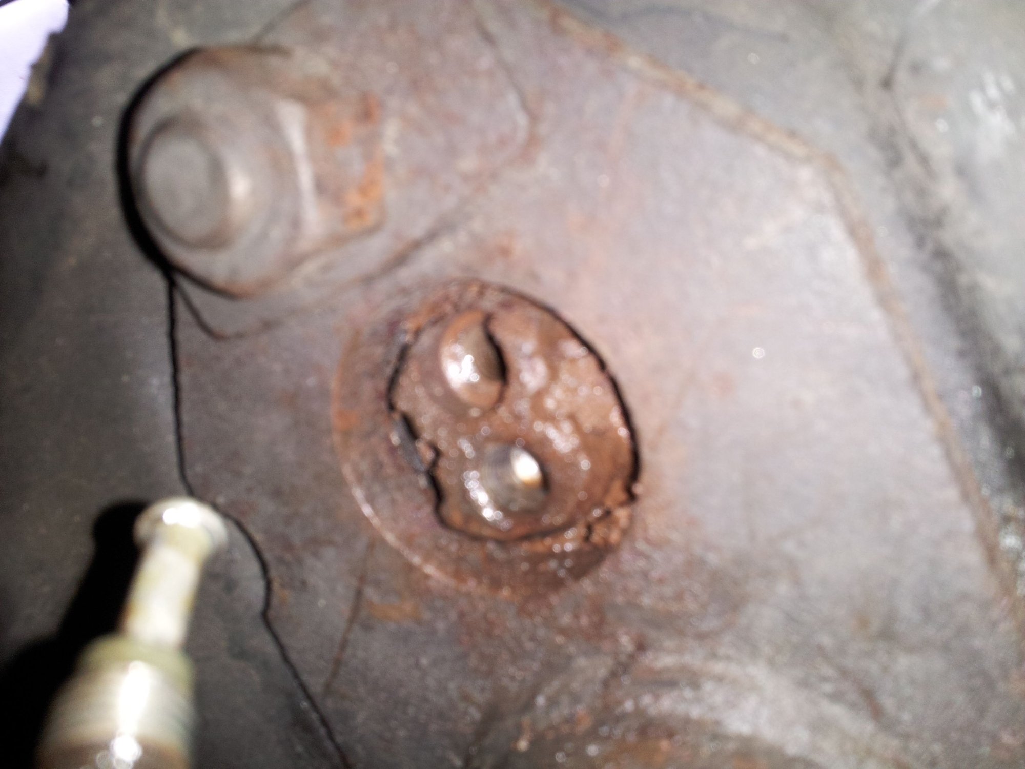

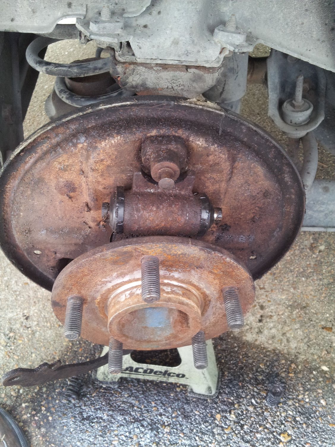

im restoring my 92 fire bird 3.1
My question will be im replacing my rear drums and i have to replace my wheel cylinder and i haved removed the brake shoes and hard ware as well as the brake line and bleeder screw but can't seem to remove the wheel cylinder and its clip on the other side of the brake plate can some one help me with a video or step by step guide to doing this as well as to how to putter it all together .. i have bought new wheel cylinder ,hard ware kit and drums.as well as shoes

Step 1: remove clip from rear of wheel cyl
Step 2: Installation is the reverse of removal
OK, now that you've enjoyed "instructions":
The clip is circular, goes around the cyl, and has 2 blades that project inwards. They slip into grooves on the rear of the cyl that are on the sides (front and rear, not top & bottom) and catch on barbs located in the grooves. Can't see that worth a crap in your pics because everything is so filthy and rusty but it's all down in there somewhere. To remove, use a small screwdriver to pry the blades of the clip away from the barbs. Once you get that, you won't have any trouble with step 2.

For me, I used 2 nails banged in to pop the clips, then to put it back on -- https://www.thirdgen.org/forums/brak...ml#post6006083
