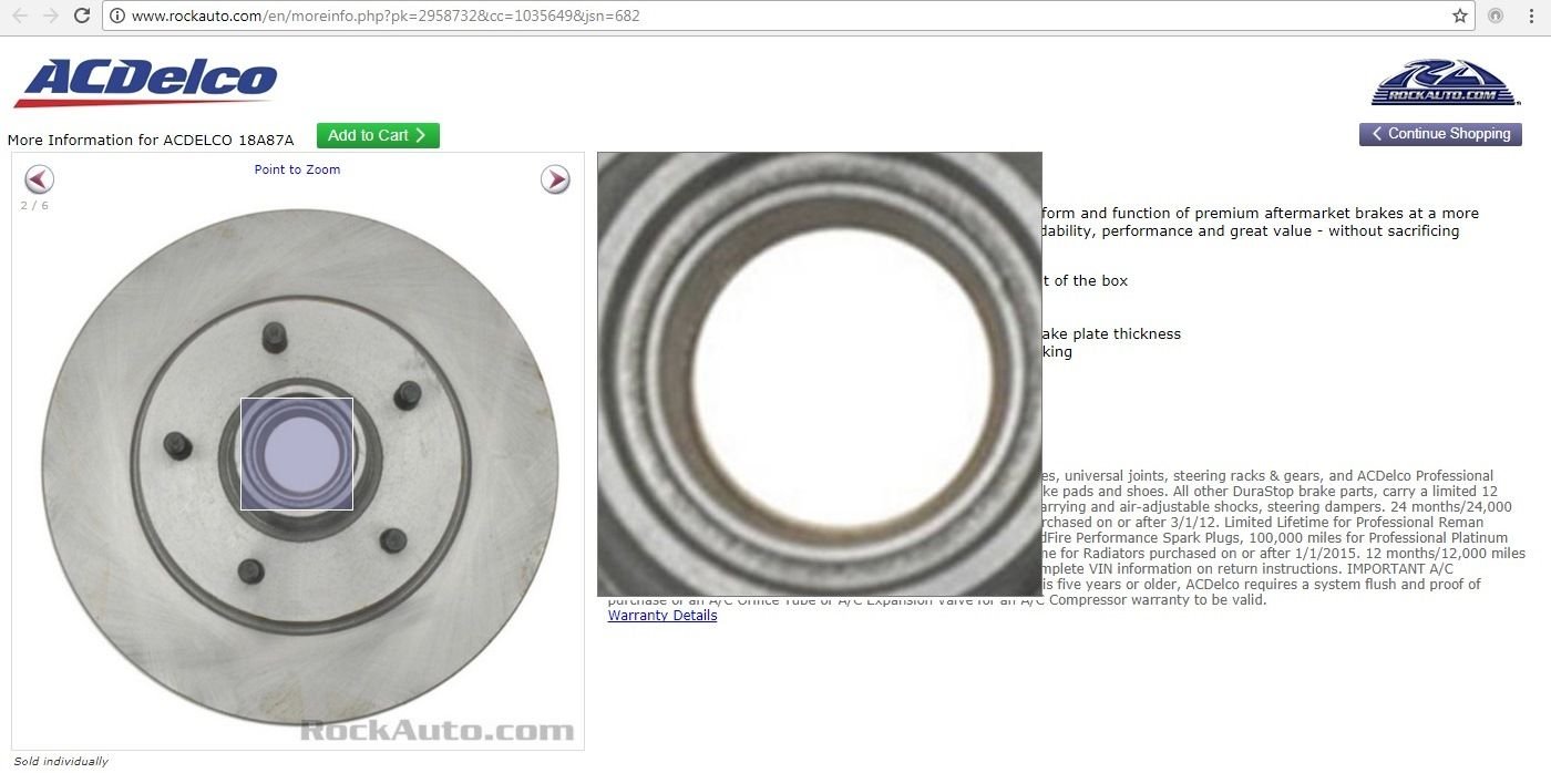

While everybody is thinking about this, I checked Rock Auto too regarding rotors.
AC/Delco a good choice?
If you click on the link at http://www.rockauto.com/en/moreinfo....035649&jsn=682 and then click on the six pics you can scroll through there, the pic looks like the AC/Delco rotor comes with races installed.
Would you remove the AC/Delco race in order to use the Timken bearing?
Below are the pics I'm looking at on the Rock Auto site that makes me say it looks like the bearing race is already installed. If you go to the Rock Auto site and hold your cursor over the image, it will auto-zoom in. Problem is, the image is really low-rez, so my non-expert eye has some uncertainty as to what all I'm actually seeing in the pics.
Unless I'm overlooking something, or unless we are to infer from the language "No machining required - ready to be installed right out of the box" means "races included," the description on the Rock Auto site doesn't tell us whether the races are included with the rotor.
Its been 40 years since I beat the race out of a brake drum. I remember it being an embarrasing exerience. That's how good at it I was.

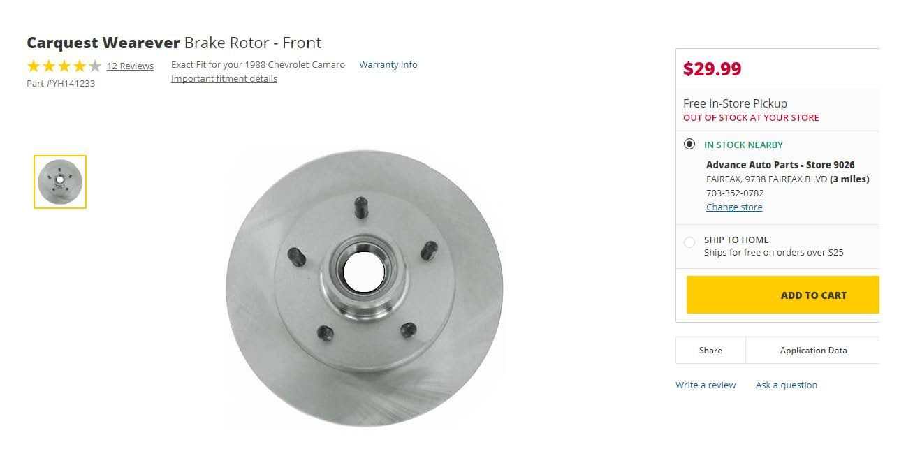

Originally Posted by W.E.G.
Generally, if you install new rotors, they will come with the bearing race already pressed into place.
One more question: What about recommendation for brake hoses?
I was pondering this project a few weeks ago, and I priced it out for whatever they are selling on the Advance Auto site
It'd be much more difficult to find any rotor sold without the bearing races installed.
All of the cheap brake hoses are made by Sunsong. It doesn't matter if you buy Dorman, Centric, AC Delco, they're all Sunsong hoses in the packages. Might try Wagner or Raybestos if you want something other than Sunsong.
Never buy from Advance Auto outright. Go to retailmenot.com and search for Advance Auto there's always at least a 30% off coupon available. Join Speedperks too and Advance Auto will give you discount codes that you can combine with the retailmenot codes. Do all of that, and they're only a couple dollars more than Rock Auto. Even with the shipping costs, Rock Auto is usually less and carries better brands of parts.
As a general rule, nearly everything in the AC Delco product lines for our cars are made by someone else. Most of the time the only AC Delco part is the package.
