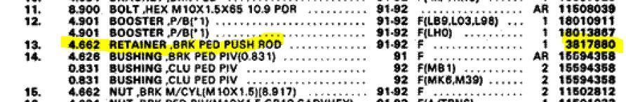

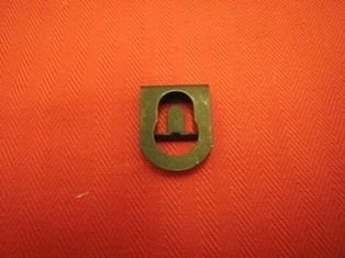

Does anyone know what the correct C (or E) clip size is for the brake pedal and clutch master rods on the T5 pedals? I can't get a measurement with everything in the way.

No problem. You could probably get away with using a generic C-clip, but you really don't want the rod popping off. The correct clip has to have the retainer pried up to remove the clip. It's not coming off without help.
BTW pretty sure there's supposed to be a 'wave' spring washer between the rod and the pedal to act as a spacer.
