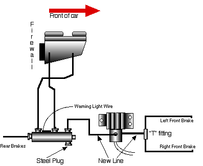

Shouldn't he have installed the line lock AFTER the proportioning valve? In the line that goes to both front brakes?
Maybe I tee'd mine together, like this:
Yes. He got it installed wrong and the dummy light is telling him he's a dummy.

Yup, the way it is plumbed in, it will trip the brake warning light each time.
