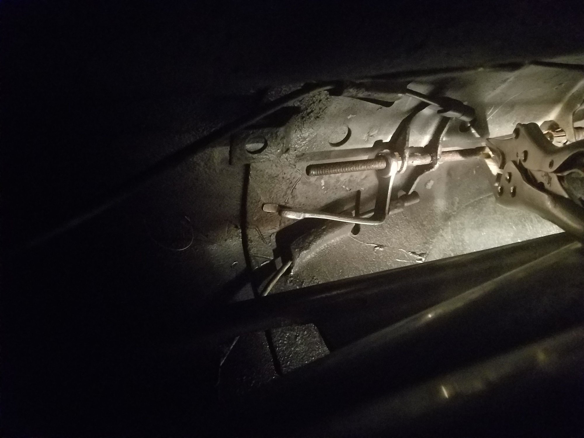

You can get up under the car and let the cable adjuster out.
This will control the travel in your handle. Pics are worth 1000 words as they say. We don't know how high your brake handle is moving. All the advice is accurate, but if someone adjusted your brake handle too tight over the years, you may still not be getting it high enough to just take off the handle. If you remove the handle and still can't get the correct angle to clear, adjusting the equalizer is the thing to do. Some folks hate that I bent a wrench to do this, but it is oh so easy this way. .

[QUOTE=KyleF;6360110]This will control the travel in your handle. Pics are worth 1000 words as they say. We don't know how high your brake handle is moving. All the advice is accurate, but if someone adjusted your brake handle too tight over the years, you may still not be getting it high enough to just take off the handle. If you remove the handle and still can't get the correct angle to clear, adjusting the equalizer is the thing to do. Some folks hate that I bent a wrench to do this, but it is oh so easy this way. .
Thank you Kyle. This is very helpful, especially with the picture.
