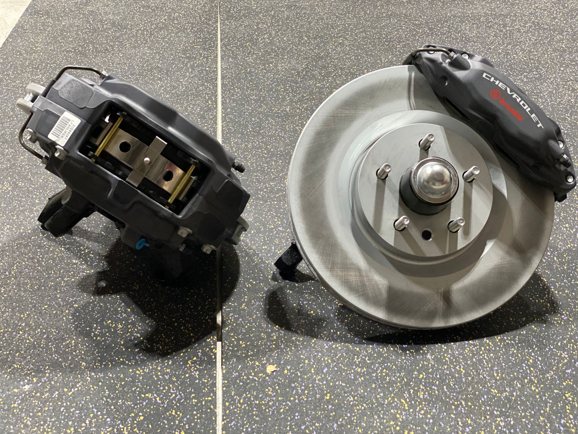

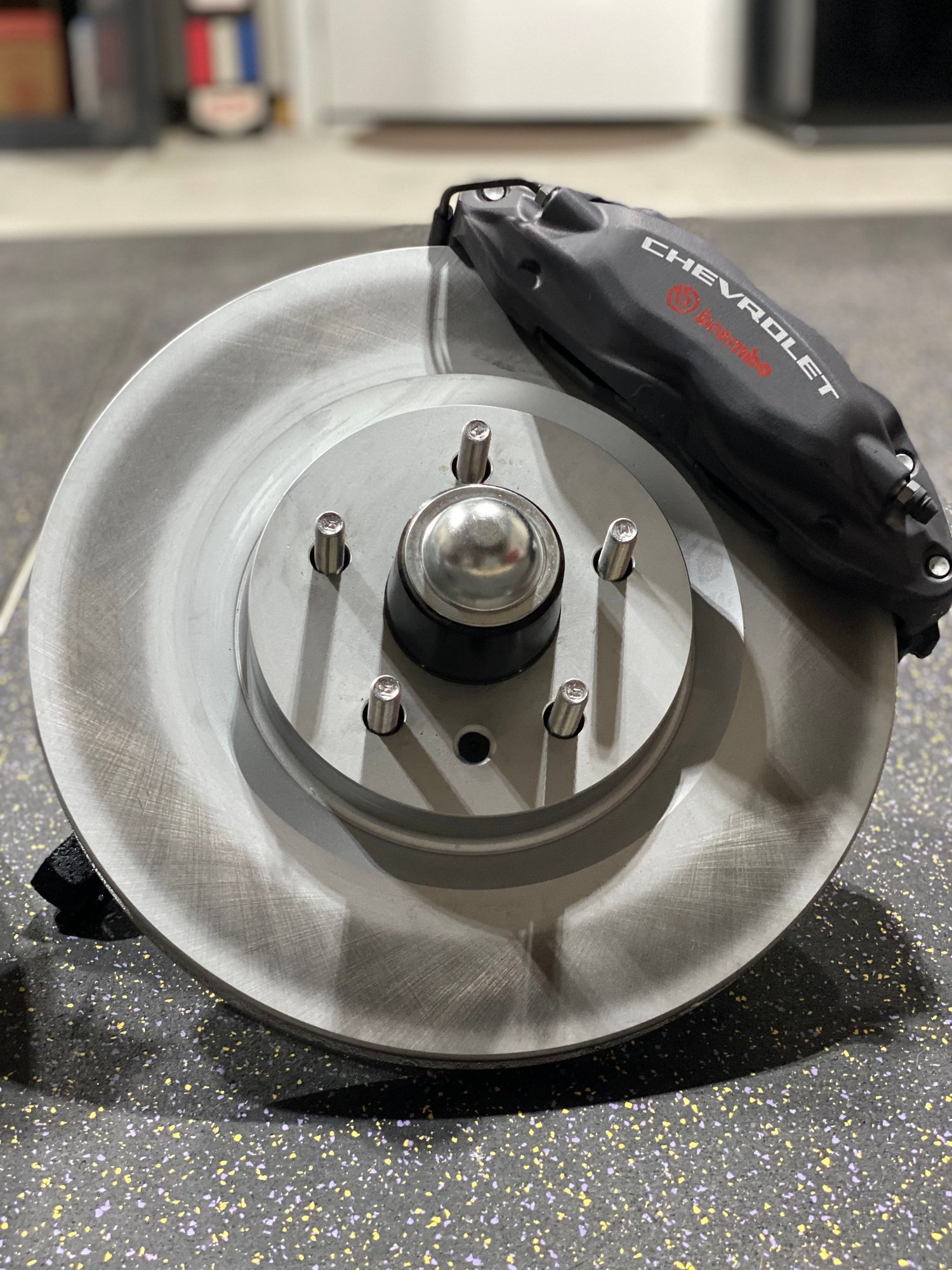

Just received my Gen V Camaro front brake set from bigbrakeupgrade.com. Just want to know if anyone has used this combo and if you needed to upgrade anything else in the braking?
