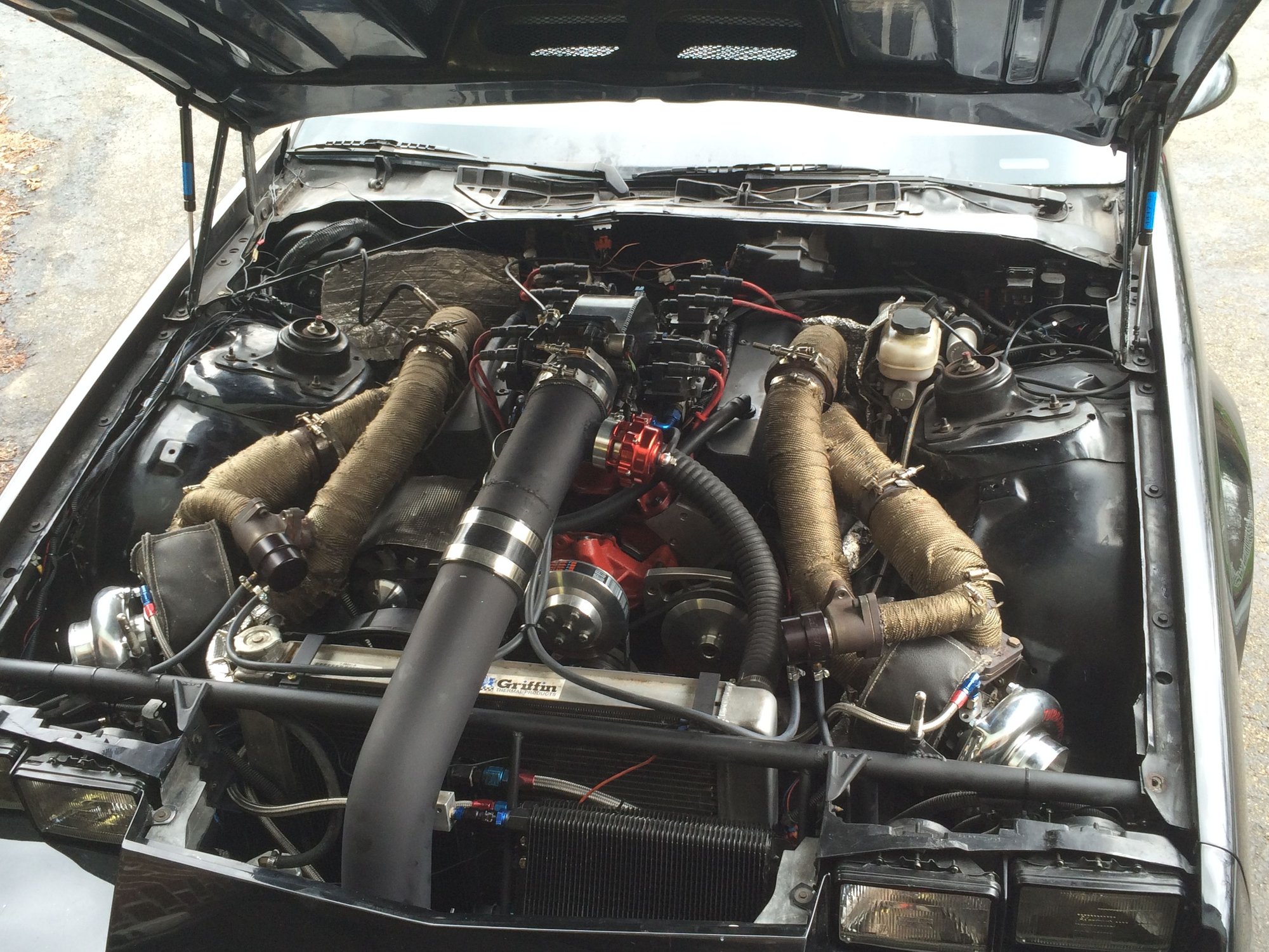

Saw this on another thread. This is a Caprice, so apparently the lines are on the other side of the master:
I think the farther away you can get the lines from the header the better. Temperature has a serious impact on hydraulic / brake fluid.
-- Joe
-- Joe
Agreed, and the picture you posted seems the best route to take, especially for a street driven car.
