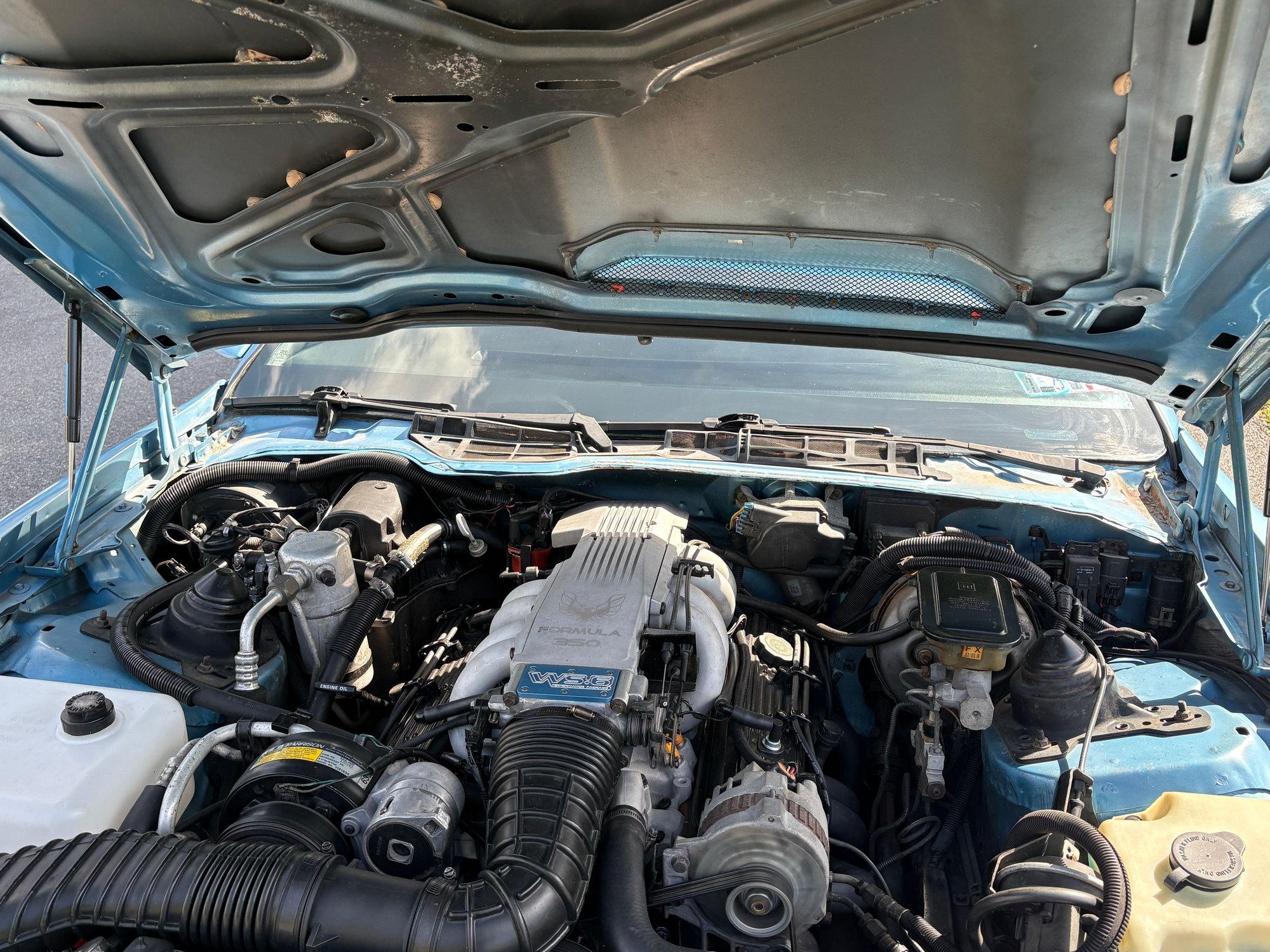

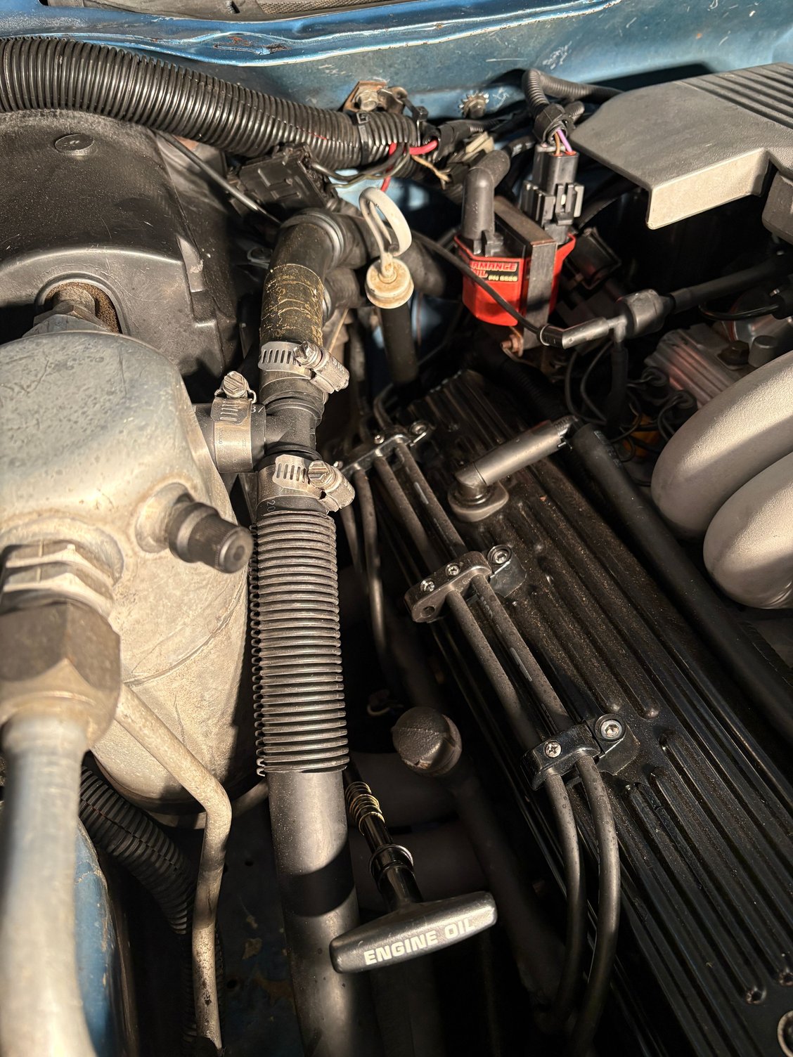

I eliminated all the air injection components (smog), moved the heater hose vacuum valve over between the right shock tower and heater fan motor and added spark plug wire holders that use the center valve cover bolts (from Summit, see pic). Also eliminated coolant to throttle body by replacing straight hose nipple coming out of intake manifold with a 90 degree nipple and that hose straight to heater hose vacuum valve.

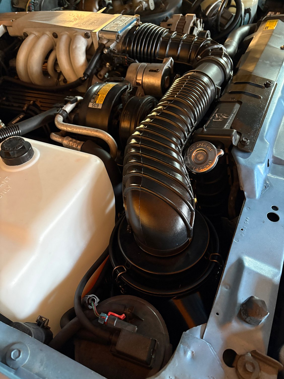

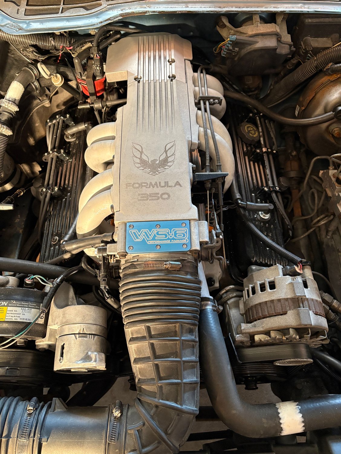

Since mine is TPI my battery is at left front and air cleaner + evap/ purge valve are at right front. I attached pic but you cannot see the purge valve because its down between air cleaner and coolant reservoir. The hose for the purge valve runs over to right side of throttle body below the crankcase breather hose.
