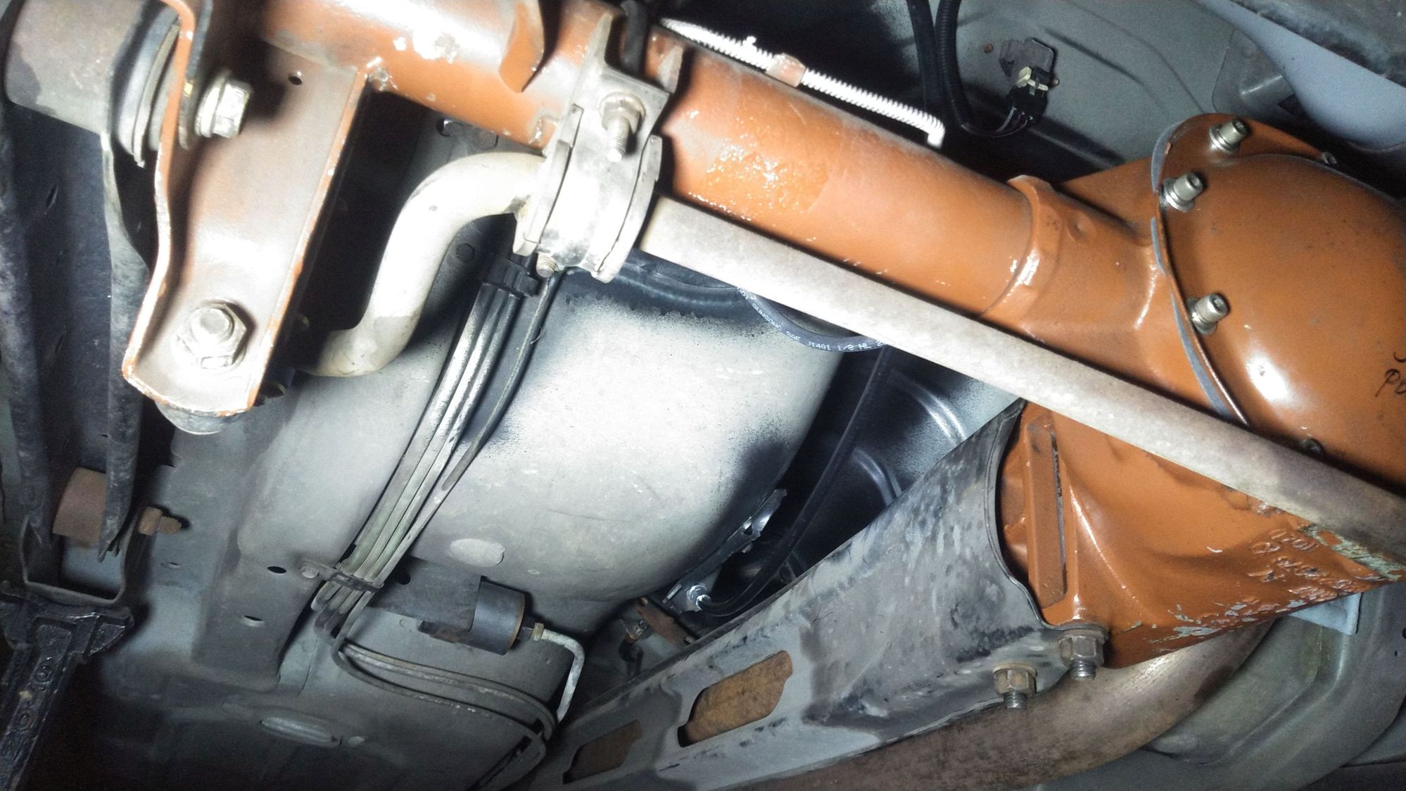

Just thought I would pass on a idea I had when converting to LS1 Rear brakes using the stock 3 gen cables for PBR (alum) rear calipers. I made 9.5" long (measure in between the nubs at each end) extension cables. I had to tack weld the cables at each end to ensure the nubs I crimped did not slide off. then used a cable splice that I cut open long ways to slip both old and new extension cables in. Closed it and used a small hose clamp to ensure it did not re-open.
Cheaper than the special cables and in the last 3 years has not failed.
Since I have the car apart for some upgrades it's a opportunity to take a good photo of it...

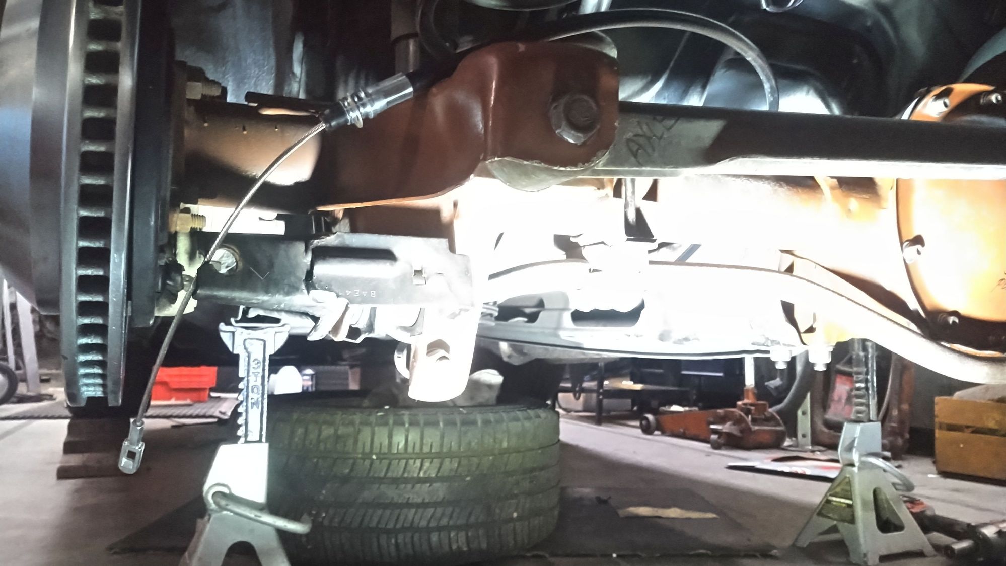

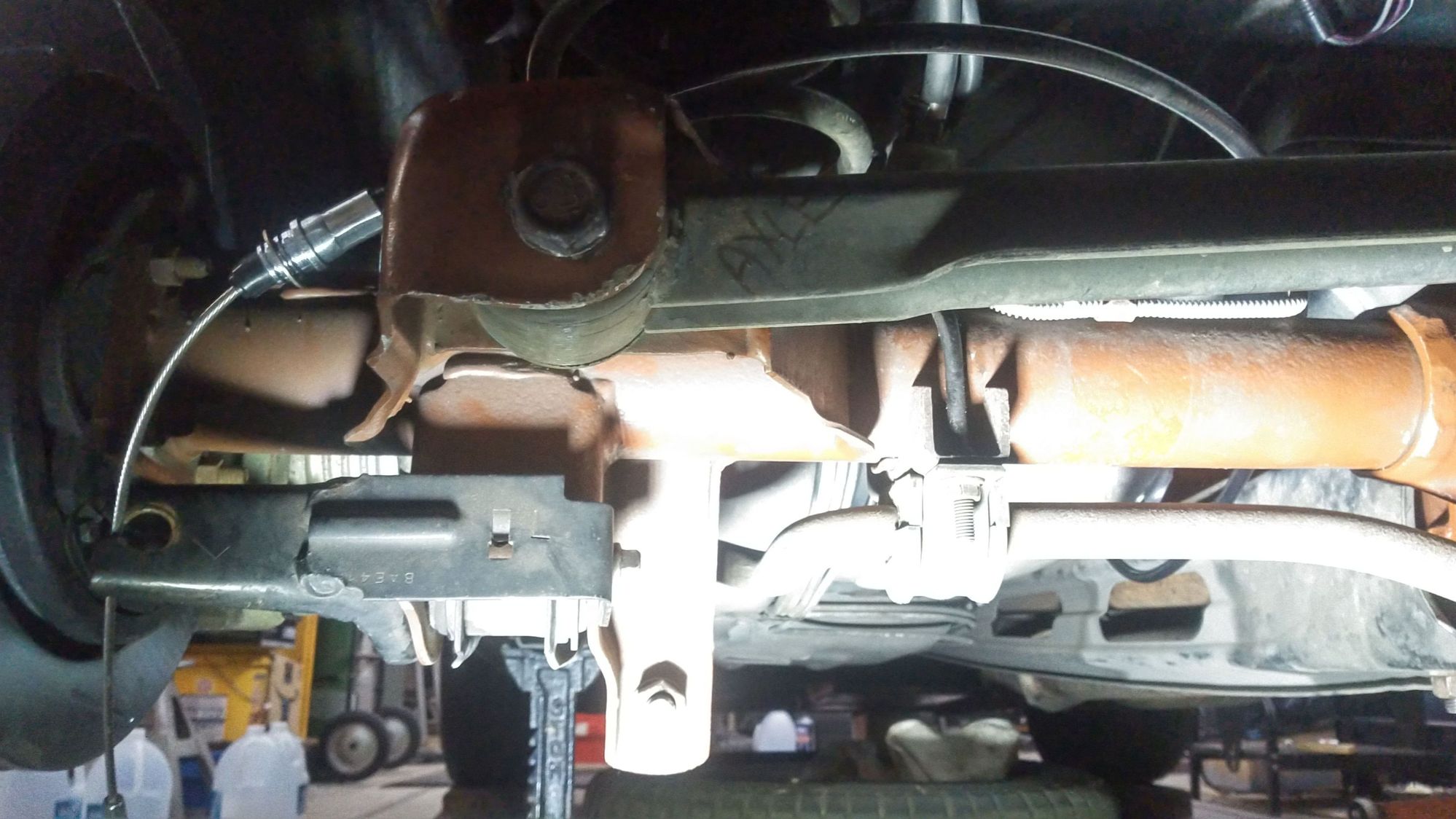

This shows a Hawk cable partially in place way too short to make the 180 turn and connect to the brakes. How did anyone make this work?

Are you sure you've got them routed the right way?? Try starting at the bracket on the rear end then move forward.

I too was never able to get them to work. I tried installing starting rear then front and vice versa to no avail. I will have to go custom.
