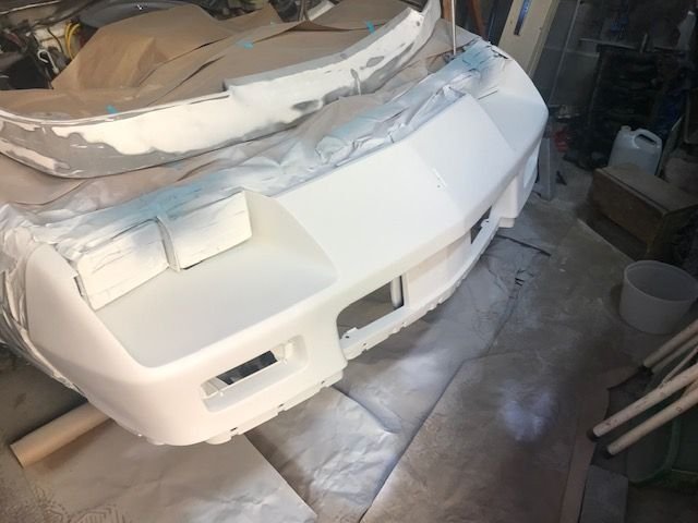

Bought the car in May and as of this morning step 1 has been accomplished.
Before and after.
14 hours preparing the nose. 6 hours to paint nose. The fenders were new so no prep other than wet sand 800. 4 hours to sand fenders, 6 hours to mask off basically 1/2 the car and the engine bay. 3 hours to finish. Also not in pic but I spent at least 5-6 ours on the lower front fairing which is also finished and clear coated.
All rattle can. 38-40 hours.
Between sanding when it was needed I cleaned with slightly soapy (just a drop) water. Cleaned again with just water, dried with blue cloth. When is was fully dry I Tack clothed and went at it. Wore a mask, sprayed side to side. (not up and down except for a for a few corners and tight spots.
Paint match by a local shop in the cans and IMPORTANT used 2 stage clear coat on the whole thing. 2 hours later the clear coat is hard enough to brush up against and its fine.
It was raining so the garage doors were open and no dust! It IS orange peeled however next spring when that clear coat is rock hard I'll wet sand the work to 2000 and polish it all up.
The old paint is yellowed and not great but it should also shine up a little better. I tested a bit with just polish. The car was from Penticton and its corrosion free.
Don't care now because its all one color and it should stand up to some street strip work in a year or two.
NOW i can get to the rest of the car.
And I learned something that had me concerned since I couldn't find what was slowly draining the battery. That's a battery tender the line is going to under the hood.
I've had the hood up for 2 months! When I papered over the windshield and doors for painting I finally found the drain. I just acquired this and didn't know that down near the floor by the hood latch there was a light on, when the hoods open!
We'll be removing that bulb next time I work on it extensively.

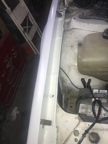

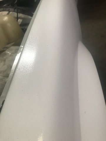

A couple of detail pics.
I carefully masked of the inside rails and hinges. I only sanded the insides to 200.
One shot has the fairing and one tries to show the orange peel the clear coat leaves.

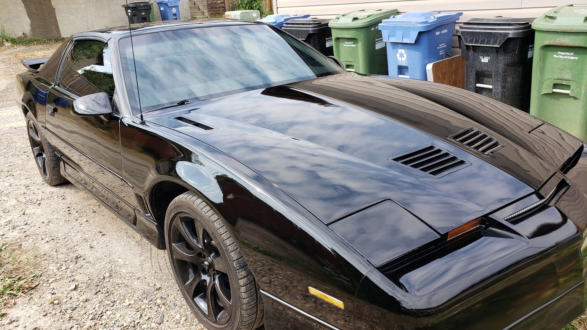

Looks like it's coming along nicely Camertom! Here's an update on my trans am two months after getting her back....I got her polished and sealed to protect the paint for the next six months!
