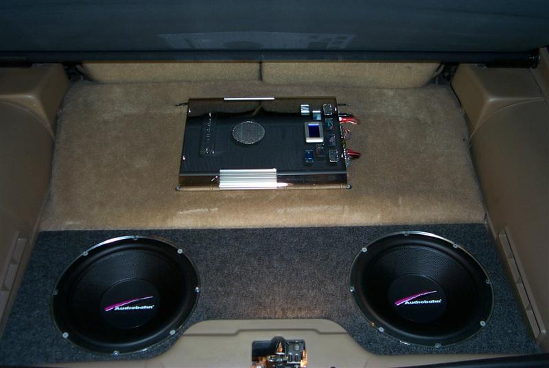

I don't think you know what downfiring a sub means. Attached is a picture of normal flush mount(facing UP, not forwards or backwards) in my custom box. If I leave the box in place and hook up the sub facing DOWN (not forwards or backwords), that is called downfiring. I did read the theory also, and it does make sense to me, but does not apply to my specific question. I appreciate you trying to answer my question.

No. That's called inverting a sub.... I have a downfiring sub in my house. It fires toward the floor. That's why they call it a "downfiring" sub.
The only advantage to doing that would be increasing the interior volume of the sub enclosure. I don't think it'll sound any better or worse. IMO it may not be as loud, or as accurate simply because you are covering the side of the cone which is firing into the listening area with the basket itself. Just my 2cents.
I don't know. How about trying it. That's the only real way to tell.
AJ

Here is the theory of "Downfiring"
Here's a discussion on another message board about what "Downfiring" a sub is, how to do it, and what advantages it has.
Just click on the dot above and you'll get the "POINT"!!!
AJ
