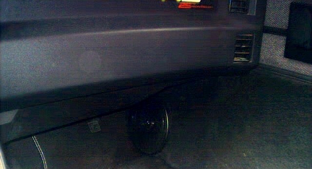

No..... here's a pic of mine.
https://www.thirdgen.org/techbb2/att...&postid=915252
They're next to your feet. Rezn8r makes them. If you do a search for his name, you'll find out more about them.
AJ

Sounds like a plan
Ya kicks are just those pods infront of the door. Better than the door because you can aim them quite a bit better. Door does have good air space though...
