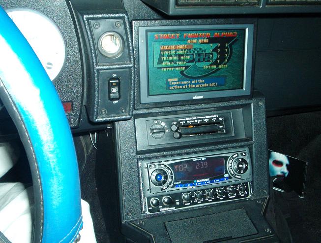

Here's my head unit and EQ flush mount install. I just marked the size of the components on a sheet of ABS and went to work. I'll see if I can find a picture of the radio before the EQ install.
