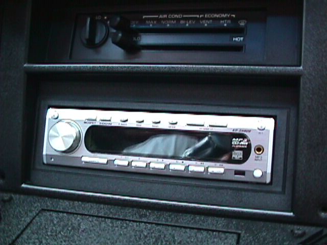

well, as i was cruising the boards, i noticed a kit by scosche specifically for our cars. i had previously done a stealth setup for my old deck, but it was more work then most people would like to do. however, with this kit, the deck is flush with the kit. all the others i had used stuck out. so, anyone looking for an easy way to stealth their decks, or just to have a better looking install, this is an easy way to do it. however, i do believe you will still need to remove the bracket and possibly cut away some of ducts in there (already had done it, so i dont know). here are a few pics. odd, my center console looks a lot like Jim's
Attached Thumbnails easy solution to stealthing or flushing decks-mvc-003f.jpg

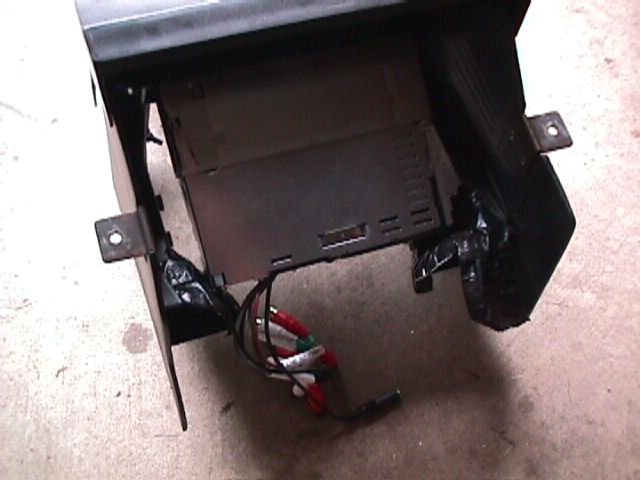

last one. here is where i thought the ducts would have to be cut. i have black duct tape sealing off my cuts, so dont mind the mess back there
Attached Thumbnails easy solution to stealthing or flushing decks-mvc-006f.jpg

Good post.
I've got one of those flush mount kits in my kitchen. For $6 from Sounddomain, you can't go wrong, and it's definately a lot easier than a custom kit.
Since he's even got the same deck, this will provide a good comparison between a pre-made kit, and a home made kit. Keep in mind that if you can't do this yourself, you can expect to pay PLENTY at a shop. For the cost and the effort, those flush mount kits can't be beat. You can see in my pics that with a custom setup like mine, you've got to build the mounting plate, and the trim plate. The scoche kit is basically a bolt-in as long as you've got enough room behind the radio.
I've still got to shim that wood plate to move it back more, which will help the face of the radio sit closer to flush. Since I chose a radio that doesn't have a completely flat face, no matter what I do I can't get it totally flush.

the scosche kit is at sound domain and its around $5. the part number is GM1516. there is another piece to the kit included that i might check out. it would be used instead of the silver trim ring that is around my face now. i deffinately do like how close your panel hugs the face. really nice work. my cutting skills are still in the works, so i'm sticking with this for now

That little trim ring they include is a great piece. With a little sanding skill, you can get it to perfectly conform to your faceplate, and snap it right into place instead of using the trim ring that comes with the radio.

ok, got a few more shots of the kit, now with the additional trim ring (which does look pretty good jim ). so, i do recommend using this kit if you dont mind doing a few modifications to the console (removing metal bracket behind deck and possibly shaving/cutting the lower console heating ducts).
Attached Thumbnails easy solution to stealthing or flushing decks-mvc-019f.jpg
