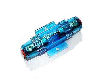

http://www.knukonceptz.com/productMa...Fuse%20Holders
this one accepts 8 gauge.

You want the holder to either have 8 gauge wire like your using or for the holder to allow you to clamp your current wire into it like your amp allows you to. Remember it needs to cover that clamped area though so it cannot contact metal.

Look at the ones I linked too.
If you need a 70 amp fuse holder, I doubt you're going to find any with the wire built on, like you see at the auto parts stores.
