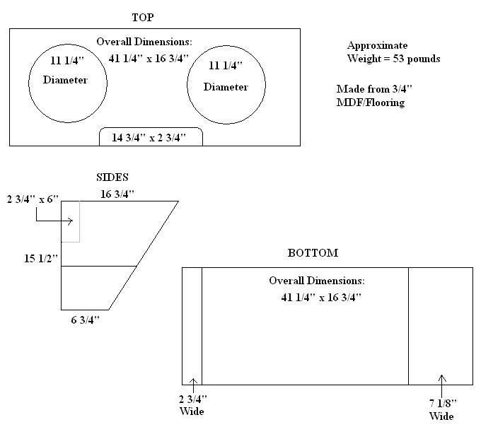

Just for reference, here are the dimensions for the box and cover I posted pics of in one of my earlier posts. All I have to draw it up in is MS Paint, so don't laugh at the crudeness of the drawings. The box sits level with the top of the "hump" in the back of my Camaro. The cover piece just ties it all together and was used to hide the wiring.
Duey - As I said, this should fit yours, but I will confess I'm not that familiar with the GTA's. PM sent as well.
